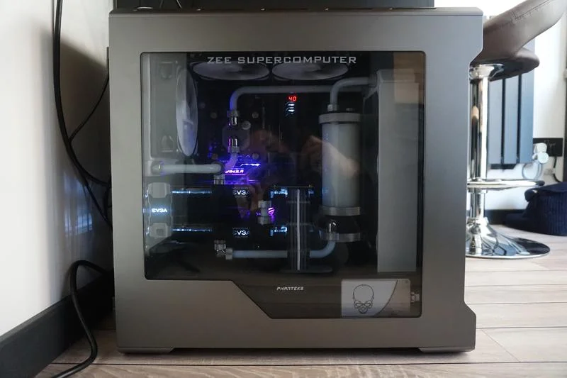

On top of that I've also been a little lazy and enjoying the new PC more than I should while there is still work to be done!

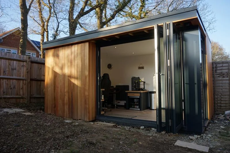

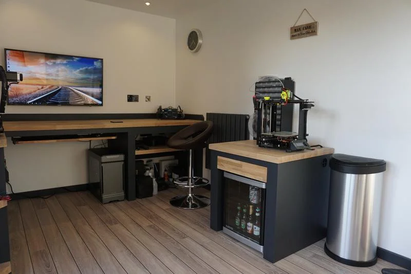

Been a while since I updated... yeah yeah, sloooooow I know.
Good news is that the cave is well on the way to being done. In terms of actual construction, all I need to do is the door and window sills and then it's done... unless I build another work table at the back (more on that later - I'm after opinions!).

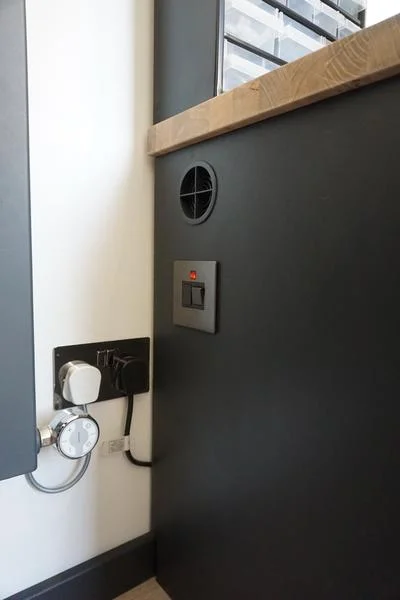

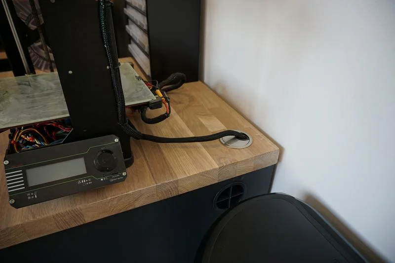

So it's all mostly done now... just some hiding of wires and little finishing touches left. I finished off the printer table and then had a duh moment. There is a multi power strip in the unit that powers the printer and fridge, but of course once I had tucked the power supply away on it's little hidden shelf I realised I can either have the fridge and the printer on, or both off... but with no power switch on the printer I couldn't have the fridge always on and the printer only on when I want it. Durr! So stupid sometimes...
My solution was to add a spur socket switch on the line between power strip and printer. Now I can turn on the printer when needed (also note the ventilation for the power supply).

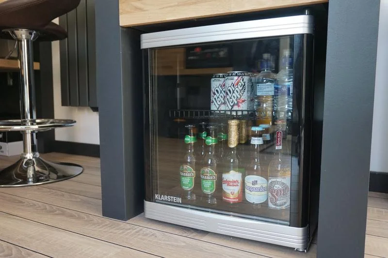

Most important part of the build:

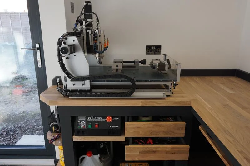

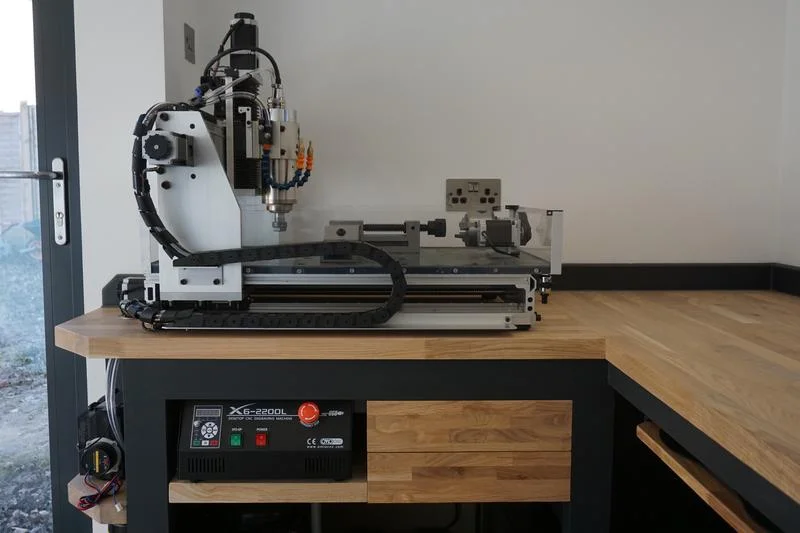

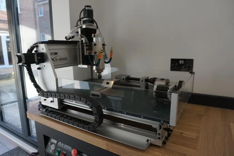

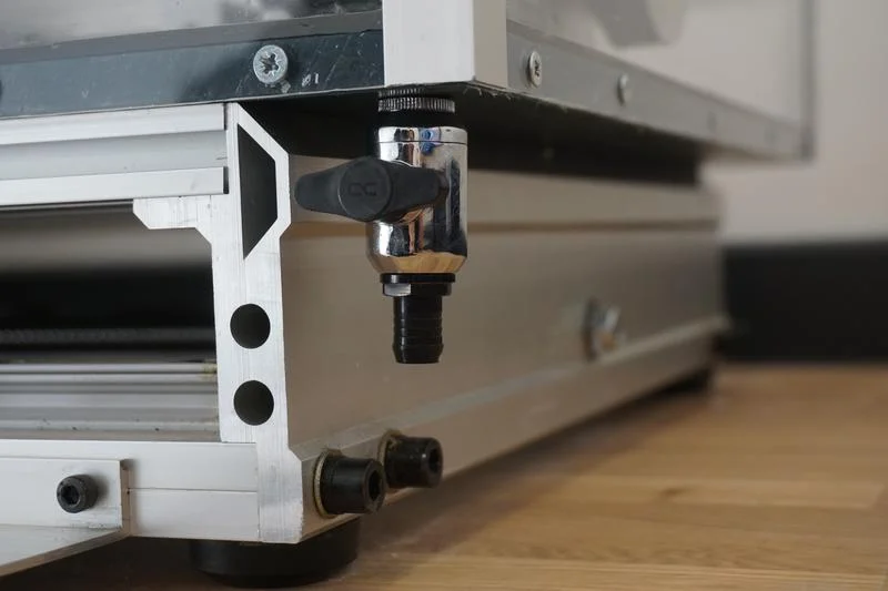

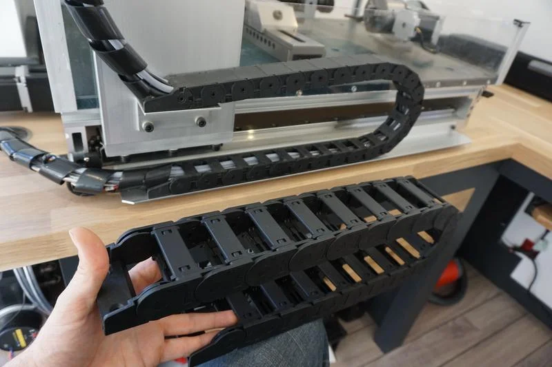

Also been working on my CNC machine... I have built a water tray and shield, next I need to just machine out a level bed from it, then attach a 6mm alu plate which I'll drill and tap as a tooling plate. This means I'll now be able to machine Carbon Fibre underwater to avoid any dust issues, and I should be able to use flood coolant on aluminium. Happy days!
I have some further plans for the CNC before it's fully up and running - I've got an ethernet smoothstepper on the way, and I'm currently eying up some closed loop easyservo steppers. The bonus there is more power and the fact that it can't lose steps, increasing reliability... The cable chains were already getting a bit crowded so I've got some sliiiiiightly more beefy units to put on to make space for the extra wires and coolant lines etc.

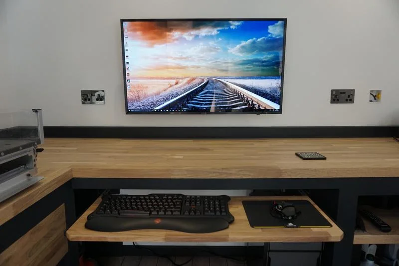

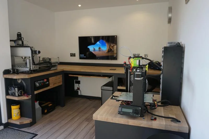

Some general pics:
And yes, landscaping of the garden comes next

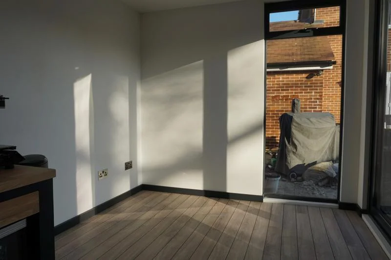

So my current conundrum is what to do down the far end - here:
Should I stick to the original plan of a small sofa for chilling out, or should I build another small worktop down the end (potentially with a view to moving the CNC machine down there to gain more space around the main work area)?

The sofa decision comes down to what you're going to use the space for. Personally if I spend any down time in my cave I'm sitting playing games - I think the TV has been on once. If you're sitting at your PC you'll probably find it won't be long before you clobber your elbow on the edge of your new CNC coolant tray....which is great by the way.
If you have the chance to chill on the sofa I suspect your girlfriend will have something to say about location: "I don't want to sit among all your bits of metal....". Maybe I'm doing her a disservice or maybe your projects will all stay tidier than mine (stacked around the floor space) but that's how it went for me!
"Most important part of the build": mine's the Budvar! :D Love the cupboard you've built for it too.
Stick a sofa in there for chilling.
That is screaming out for outside decking with a few chairs for those Summer evenings. Some beers and just relax.

For a minute Swagger I was thinking just how much more right you were than me. If you add decking and some grass it'd be lovely with access to the beer fridge too. Trouble is, the cynical and grumpy side of me (it's getting worse with age!) chimed in and pointed out that it would be great...for the two days a year we have the weather for it. So, summer coolness or year-round workspace. Zee, the choice is yours! Judging by the results so far, whichever way you go it's going to be awesome! :D

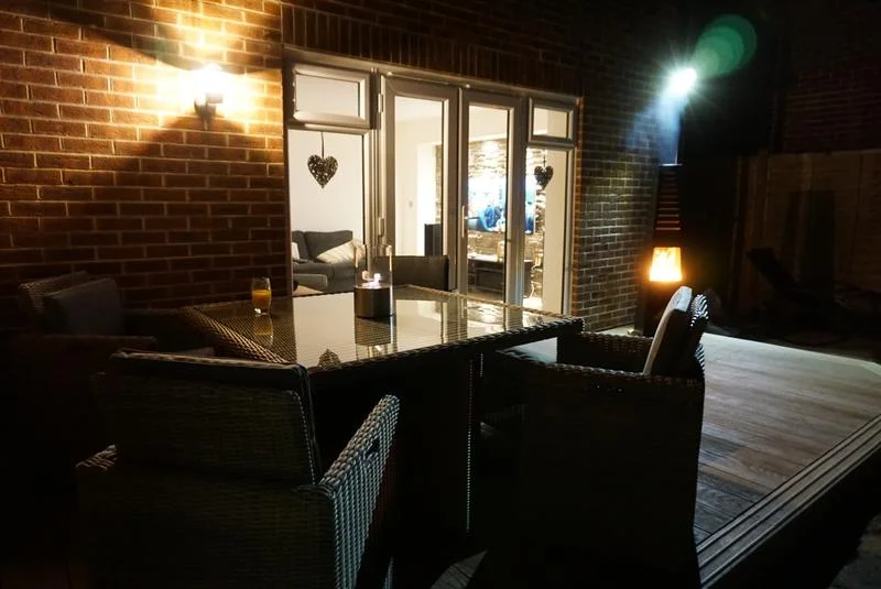

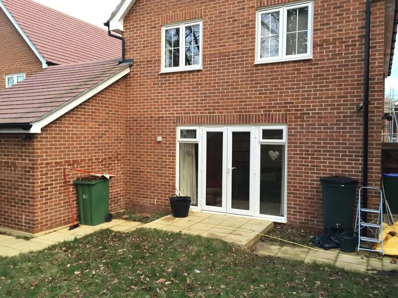

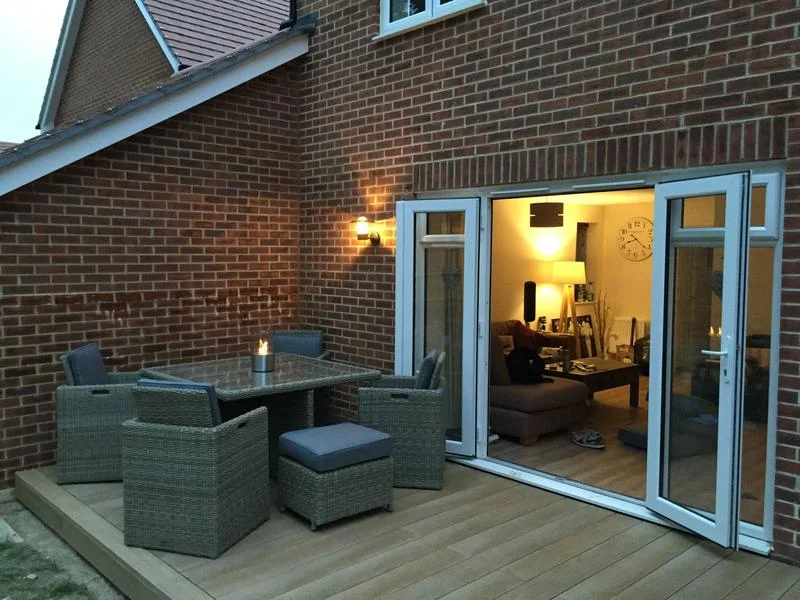

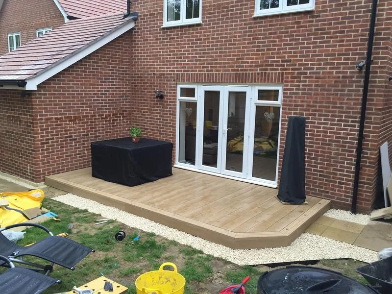

Actually I already built a nice deck out the back of the house - it's a good little sun trap in the afternoon/evening... I was planning a very small deck out the front of the man cave but anything large enough to actually sit on would eat up too much garden space... my plan was that a small deck out the front would give the impression of more space when the doors are fully opened up.
the deck, before and after:

I think i'm leaning towards more workspace and seeing if I can squeeze in a single recliner sofa - combined with the PC chair and the bar stool that should be sufficient seating. The area to the side of the cave will be a patio area (perhaps with a fire pit) and i'll see what options I have for making it covered to increase the year-round utility.

Stop it with the decking Zee....you're embarrassing the rest of us! :p

One of my favourite threads. Love these man cave projects. I'd get a sofa in there zee, so that if you have any friends over you've got a little bit of a social area to sit and chill together.
