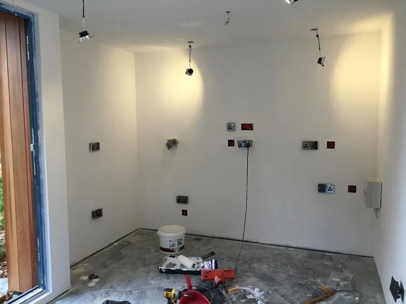

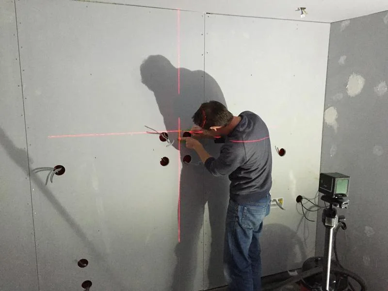

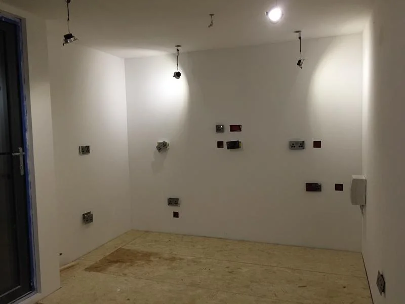

So one thing that I struggled with was figuring out how to keep the vapour barrier intact around sockets etc..
In america its easy to find air tight boxes, but they don't really exist over here.

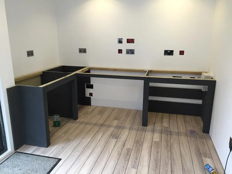

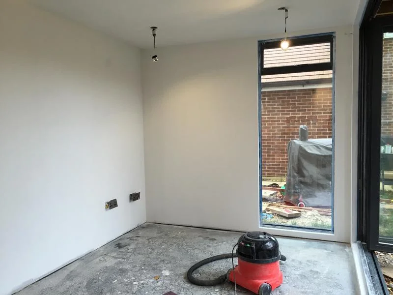

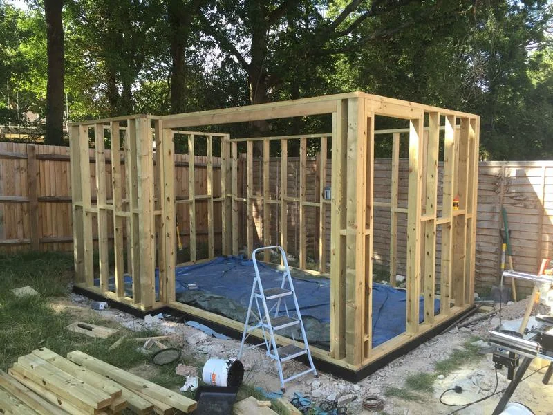

How did you bolt the structure to the concrete slab?![]()

I suspect its the different terminology that is throwing you, I found dozens on places like Amazon - however you probably saved a ton of money doing it that way - IP66, etc. rated boxes are ridiculously expensive for what they are.
I used a few concrete bolts through the bottom of the frames directly into the concrete... pretty cool, you just drill a pilot hole and then smash them in with an impact driver.

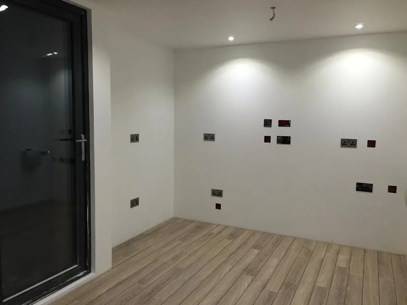

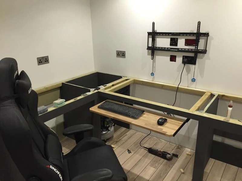

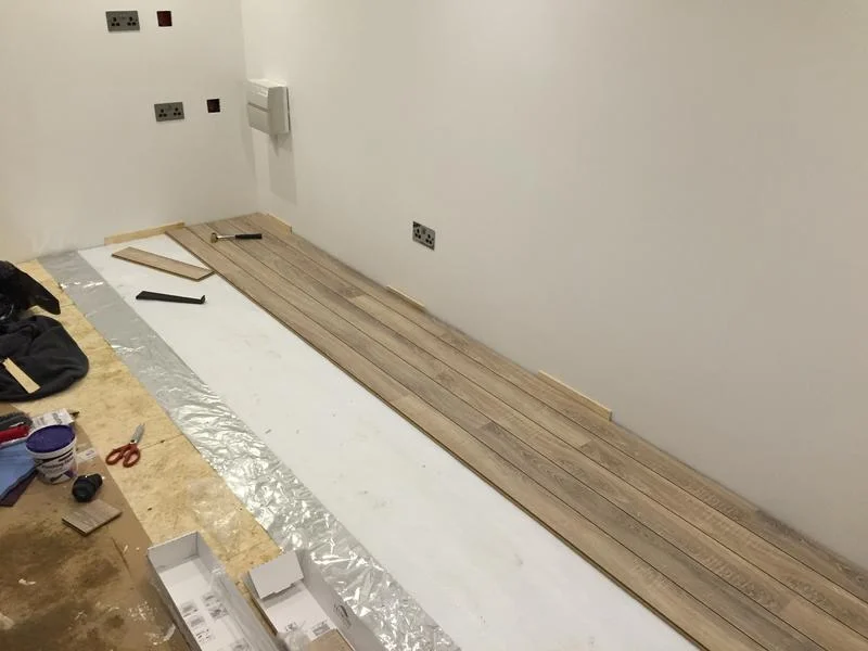

Also the flooring looks great, can you link me to what it is please?
Ah right - the advice id gotten before was to drill a hole in the concrete and use epoxy, set a piece of threaded bar into the epoxy and then you can use a washer and nut to secure the frame to the slab.
But your way seems easier![]()
