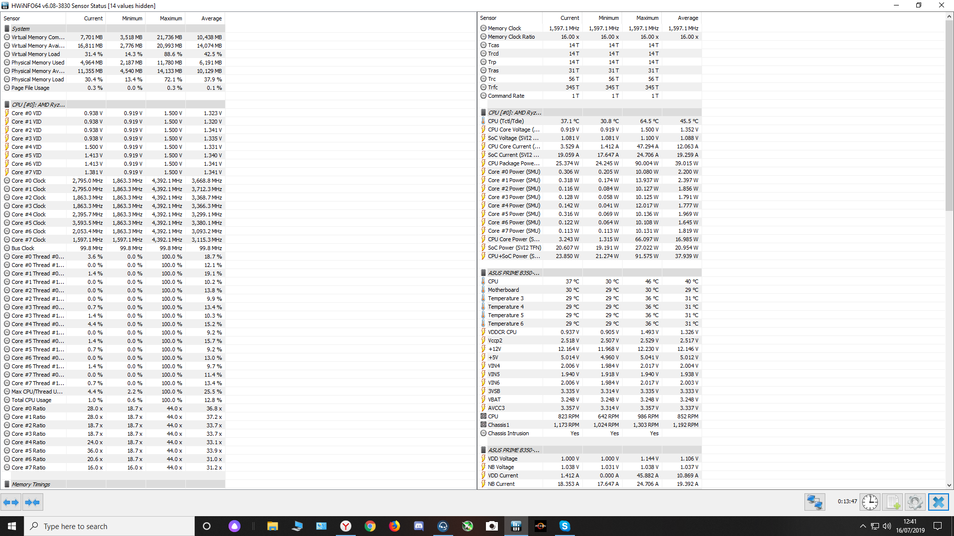

Been trying to test lots of different settings to try draw some conclusions. Copy of Document here:

What have I learnt thus far?
  • The worst single core frequencies under CB R20 load are with Mem at 3600 / PBO with a +Mhz offset / PBO Limits set to motherboard (Uncapped Limits effectively) The all core frequencies are inline with what you might expect however and the multi core scores seem about right.
  • There seems to be some correlation between 3600 memory speeds and reduced single core frequency boosting in some circumstances. The results table below is the comparison values of 3533 vs 3600. Of the 7 tests the 3600 is slower in all but 2. In all cases where 3600 ends up being faster in single core boost the PBO Limit is set to Automatic where no increase in default PPT/TDC/EDC limits are seen....which is odd in itself.
Code:
-150
300
-53
250
50
275
124
  • The highest CB R20 Multi-Core CPU score was 7320. With an observed single core max freq. of 4500Mhz. This is effectively the CPU in it's default state with no PBO/XFR of any description.
    • VCORE Set to Normal with a -0.10 Volt Offset
    • XFR PBO - Auto
    • XFR Scalar - Auto
    • AMD O/C PBO - Auto (Disabled effectively, no +Mhz offset, No increased Limits, Nothing)
    • Infinity Fabric 1:1
    • Memory - 3533Mhz
  • Setting the VCORE in the Bios to Normal with a -0.10 offset resulted in Higher Load VCORE Voltages. It also resulted in Idle voltages staying high.
  • Setting the VCORE in the Bios to Auto resulted in Lower Load VCORE Voltages and seemingly a much better Idle CPU clock and idle voltages
All in all whilst there appear to be some correlations it's a bit all over the place.
