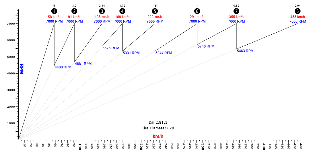

I've noticed that the gear ratios on the ZF8 speed in my M240i are a bit weird. The difference in engine speeds between all changes seem pretty similar, apart from the 3-4 change which is much shorter. You can see it in this video:
(skip to 1:25)
From the video:
1-2 Shift: Drops ~1500rpm
2-3 Shift: Drops ~1500rpm
3-4 Shift: Drops ~1000rpm
4-5 Shift: Drops ~1500rpm
5-6 Shift: Drops ~1500rpm
Not sure about 6-7 and 7-8 as you can hit the limiter in 6th, but I notice the same thing even at much lower RPMs the difference is still very noticeable.
Do we know why 4th(?) gear is shorter than all the others? My brain can't work out if it's 3rd or 4th that's the shorter gear.

Gear Ratio
  • 1st Gear 5 :1
  • 2nd Gear 3.2 :1
  • 3rd Gear 2.14 :1
  • 4th Gear 1.72 :1
  • 5th Gear 1.31 :1
  • 6th Gear 1 :1
  • 7th Gear 0.82 :1
  • 8th Gear 0.64 :1
  • Final Drive 2.81 :1
  • Reverse 3.46 :1
Seems fairly uniform when you look at the actual ratios
gearbox map
Because I'm boring and this kind of thing interests me, I used an online gearing tool to visualise the ratios. You can clearly see that 3-4 change is shorter than all the others, but I still have no idea why.
According to that 6th - 7th should also be short, but the video doesn't show that.

Isnt 4th gear the issue
If you look at the change between each gear ratio
1>2nd 0.64
2>3 0.66
3>4 0.80
4>5 0.76
5>6 0.76
6>7 0.82
7>8 0.78
You would expect the ratio change to be less as you go up higher in the gears, 4th gear really should be between a 1.62 ratio or less.
Maybe ask BMW technical? There will no doubt be a good reason. 3rd gear covers the all important 0-100 time. Its probably purely for that and that alone that the whole gearbox is messed up.
