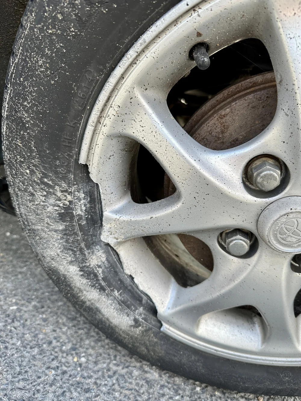

Not sure where else to post this, so I'll stick it here
A customer came in today after losing control on a roundabout and said he'd hit the kerb and could we have a look..
It's fair to say he'd hit it all right.
Now, it's either blind luck or divine intervention that the tyre is still holding air, but it somehow is!
The axle beam was also banana'd which must have made it an interesting drive :eek:
OP
31 Aug 2021
2,706
Suffolk
He reckoned he'd aquaplaned in the heavy rain.
I suggested he get a used axle (which should come complete with hubs, shocks etc) and we'd bolt it on so he could get back on the road.
It'll be interesting to see the state of the rest of the tyres when we do.
There's really no reason to aquaplane on a town centre roundabout "if" the tyres are good.

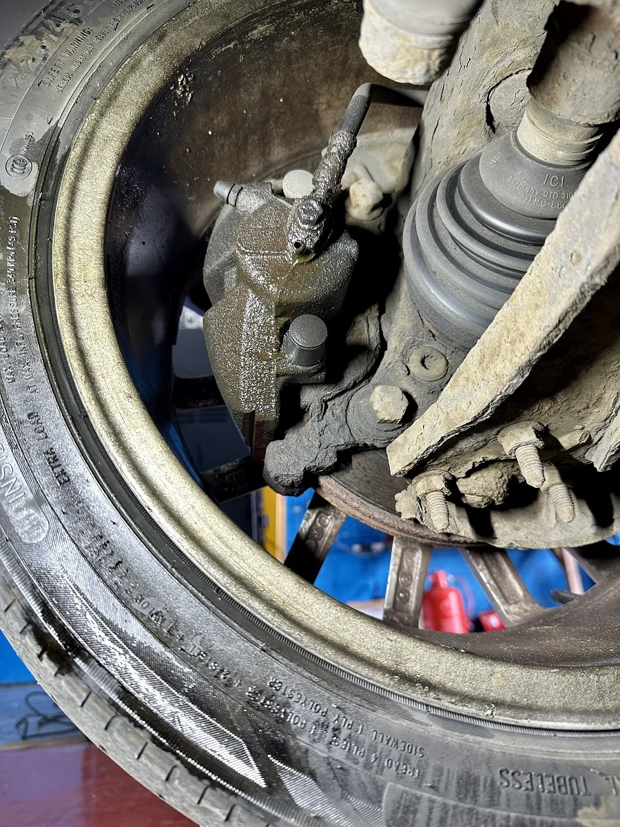

Luckily this car needed it's MOT today and not in a few days or weeks..
Easily sorted with a new banjo copper washer to stem the flow of brake fluid that had decided that it didn't want to stay in the caliper.
Anyone spot what's missing here?..
19 Dec 2002
2,017
i reckon you have a garage up the road that causes all these faults parks them up and then after a few weeks brings them to see if they pass:)
although daughters galaxy came from lowestoft with a newish mot and maybe we wont go there ahem :(

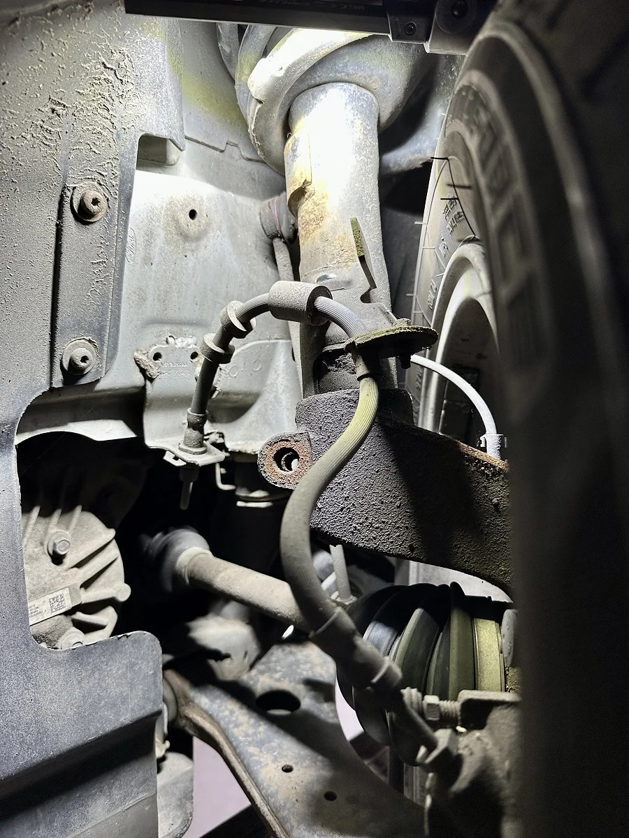

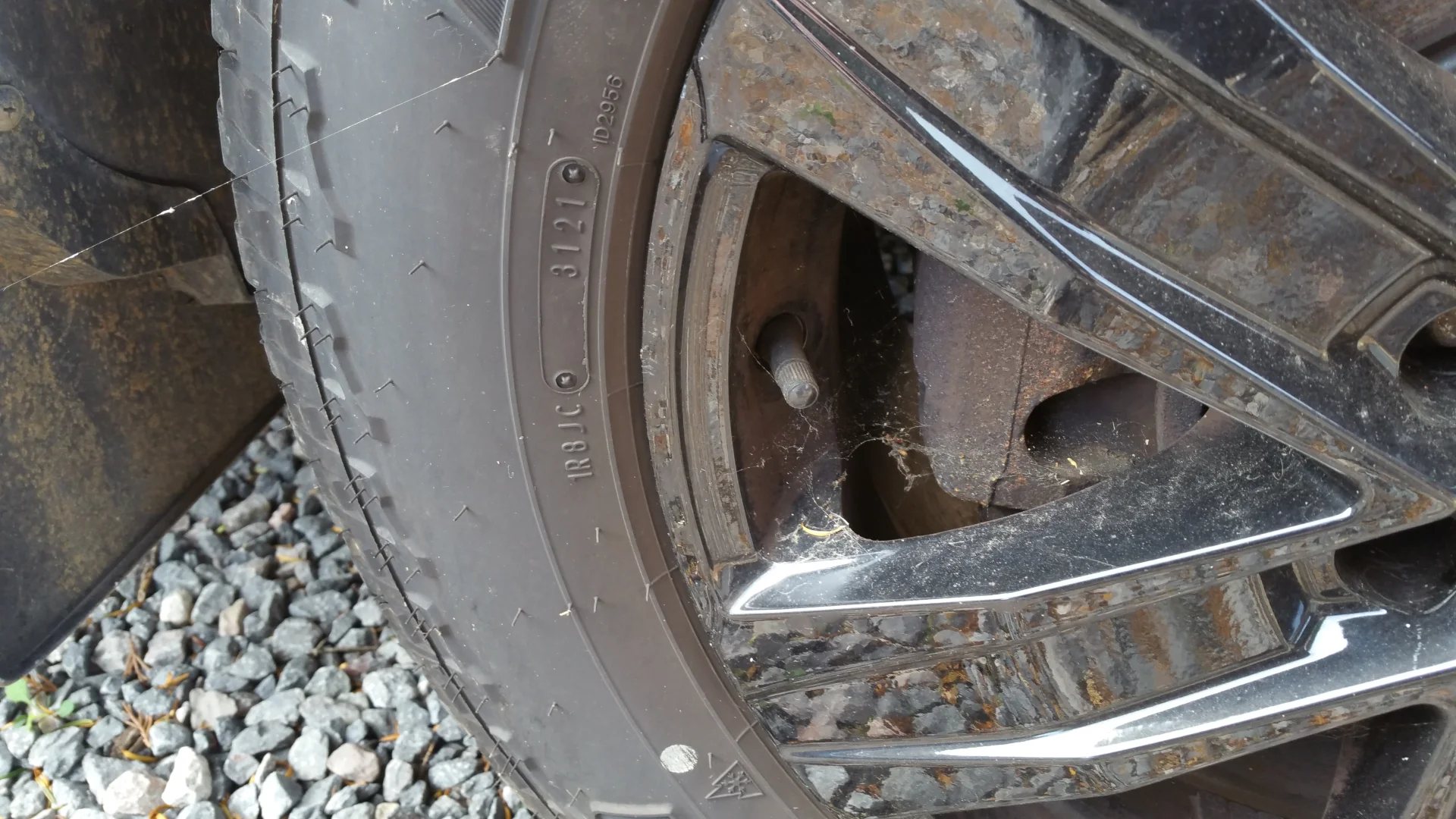

More daftness.
I'm assuming that the owner had prepared his car in readiness for the MOT by replacing the front pads and discs, caliper, drop links and suspension arms, but he seemed to have missed something..
It's so common that people just don't check the whole of the tyre tread and are shocked when it fails for the above.
  • Wow
Reactions: VoG
27 Mar 2013
9,171
More daftness.
Obviously cracks aren't good, but why is there a canyon in there. I could be wrong but it looked like it took quite a bit of effort to rise the wheel, mine have also rotated quite freely, I am watching with no sound do apologies if you mentioned something.
