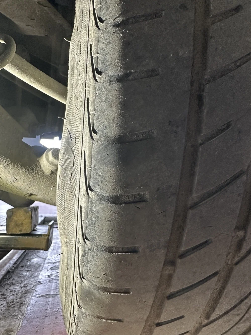

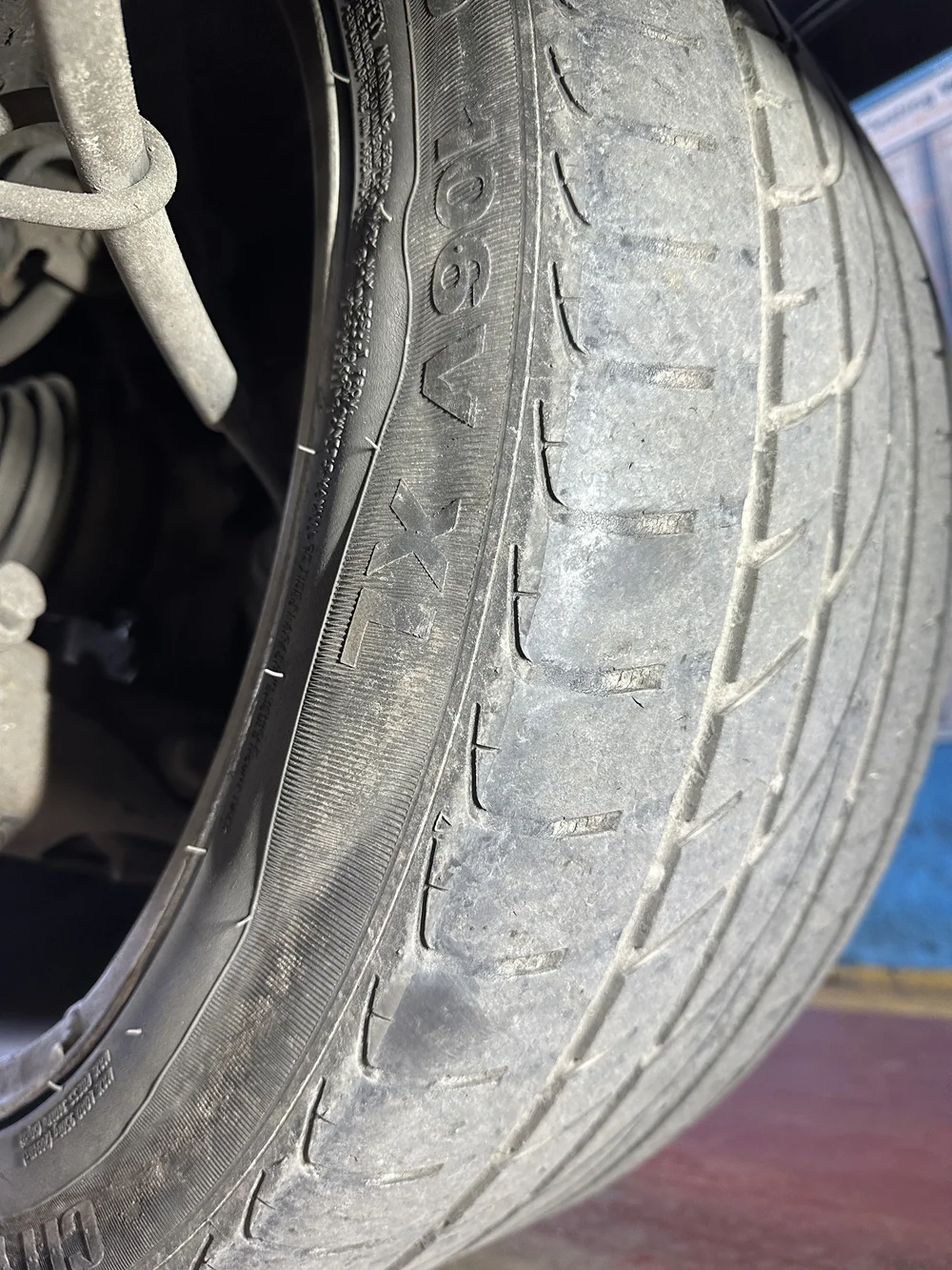

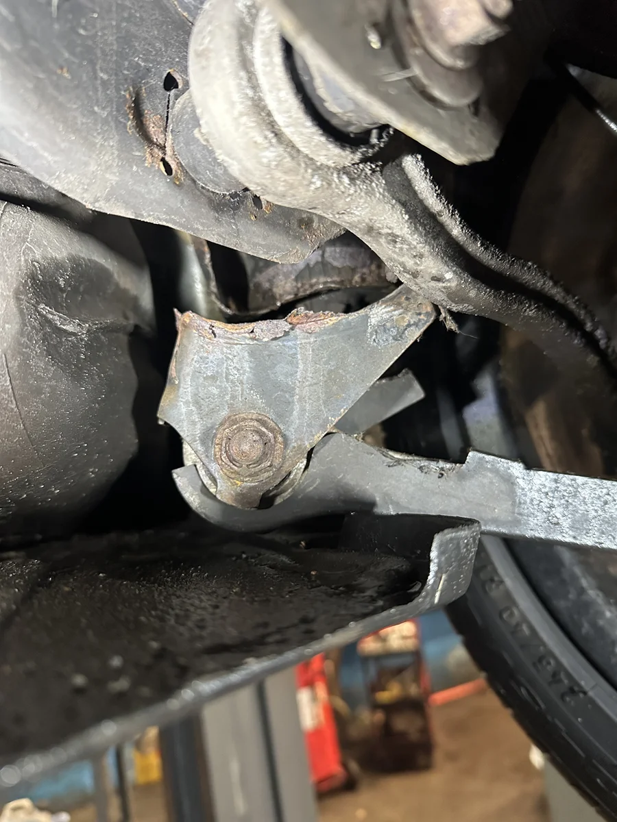

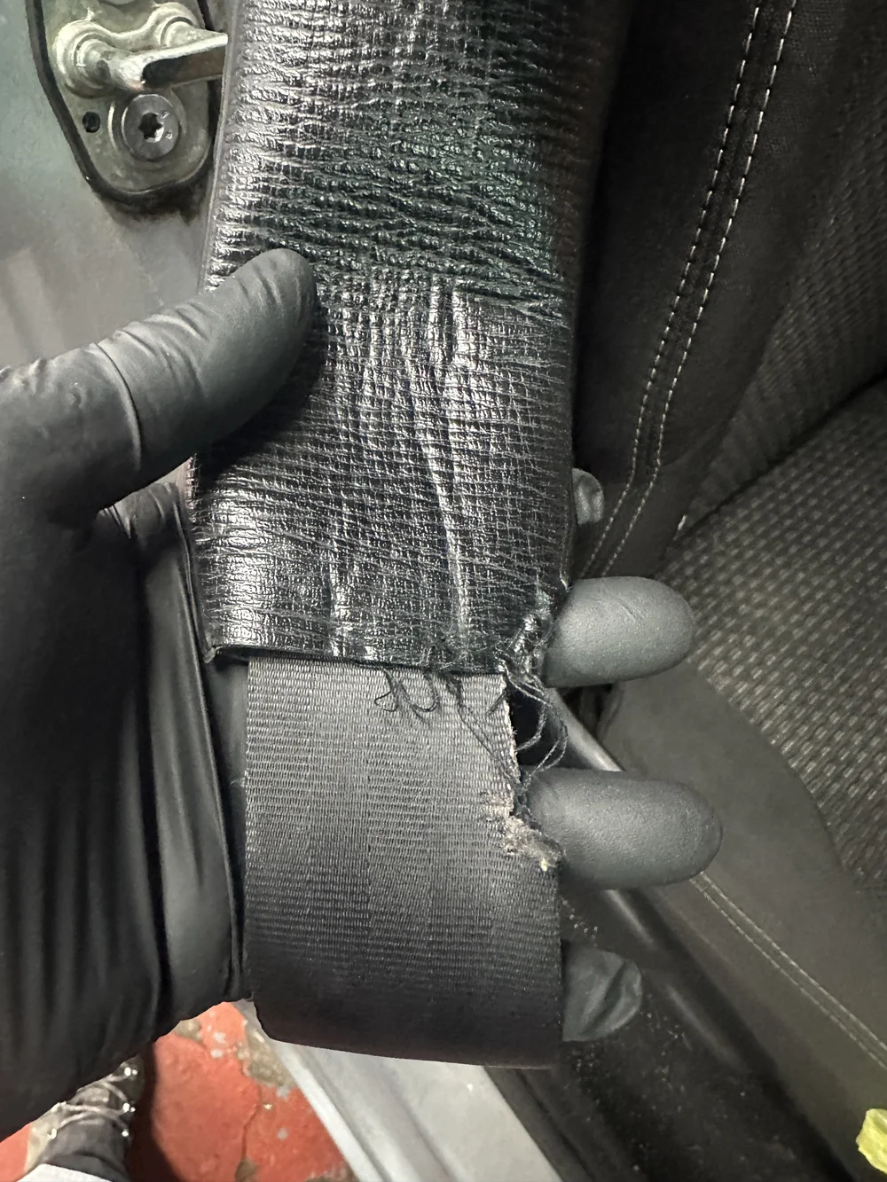

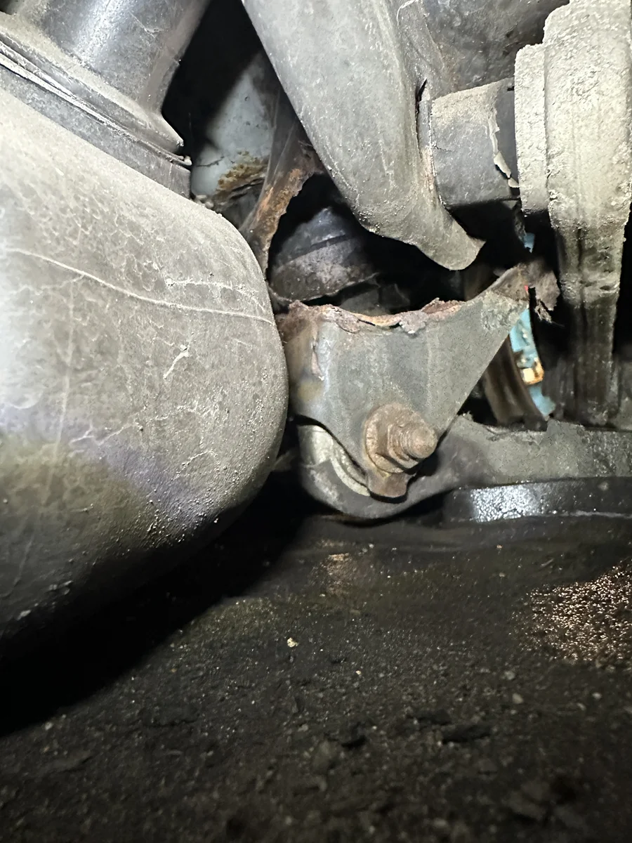

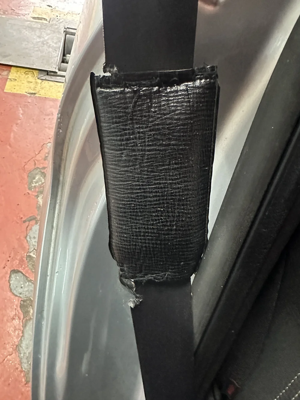

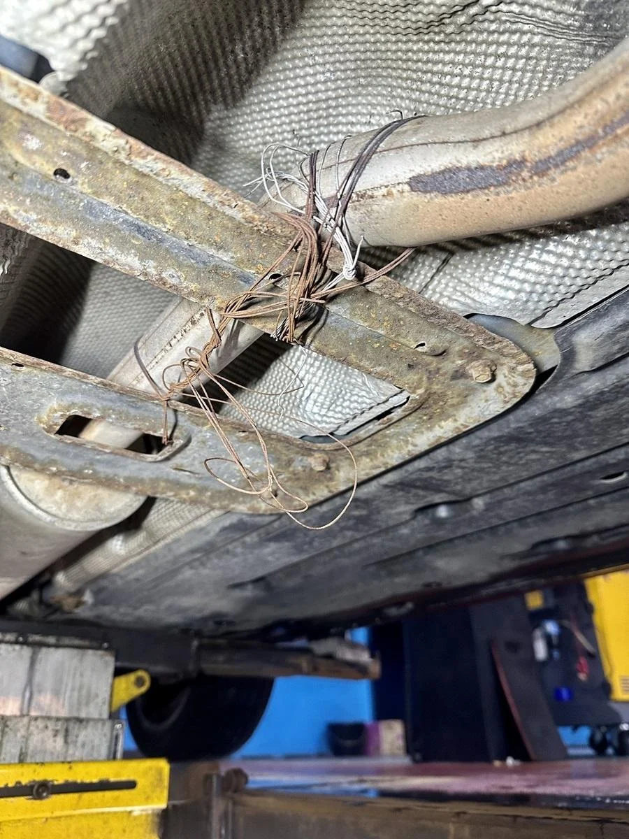

A couple of pics from today's testing..
How this hasn't blown out yet is a complete mystery..
and a perfectly acceptable repair to a seat belt..
and yes, somone had attempted to sew that patch thing onto the belt for whatever reason that I'm still unable to fathom out.

Yes, both were "dangerous" failures.
The Range Rover with the bulged tyre is still with us until a new tyre arrives, the seatbelt failure was driven away.

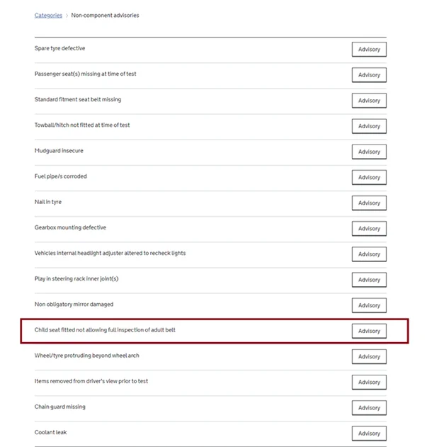

General rule is that if we need tools to remove something, then we can’t.
But, on the other hand we’re not allowed to remove wheel trims or brake fluid reservoir caps.
The customer has to make sure their vehicle is in a presentable state to be tested, and I would say to them that if duct tape was covering a seat belt then the vehicle isn’t in a presentable condition for me to inspect correctly, and if they refuse to remove it, then I’d refuse to continue the test and cancel it (the same goes with sat navs/dash cams, loads of junk on the seats etc etc).

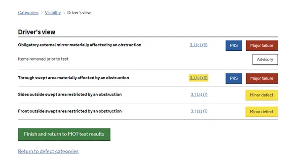

We're allowed to remove dash-cams/navs etc as long as we inform the person presenting the vehicle, but in some cases it's not practicable.
And by that I mean when theres wires coming down from the head lining, A pillars and all over the dash board, all of which I don't want to unplug or remove due to damage that I may cause, or the presenter may claim that I've damaged.
If I ask for them to remove such items and they decline to, I can either refuse to test or fail the vehicle for..
I think it's is fair to say that a person may accept that it's reasonable to fail their vehicle for having damage to their windscreen that affects the view from it, but for some reason some think it's ok to have a large nav screen plonked on right in their view of the road but that isn't an issue.
All MOT stations are ok with child seats in, but we're not allowed to remove them to fully check the seat belt, but we must inspect the belt as best we can with the seat in place and then advise..
