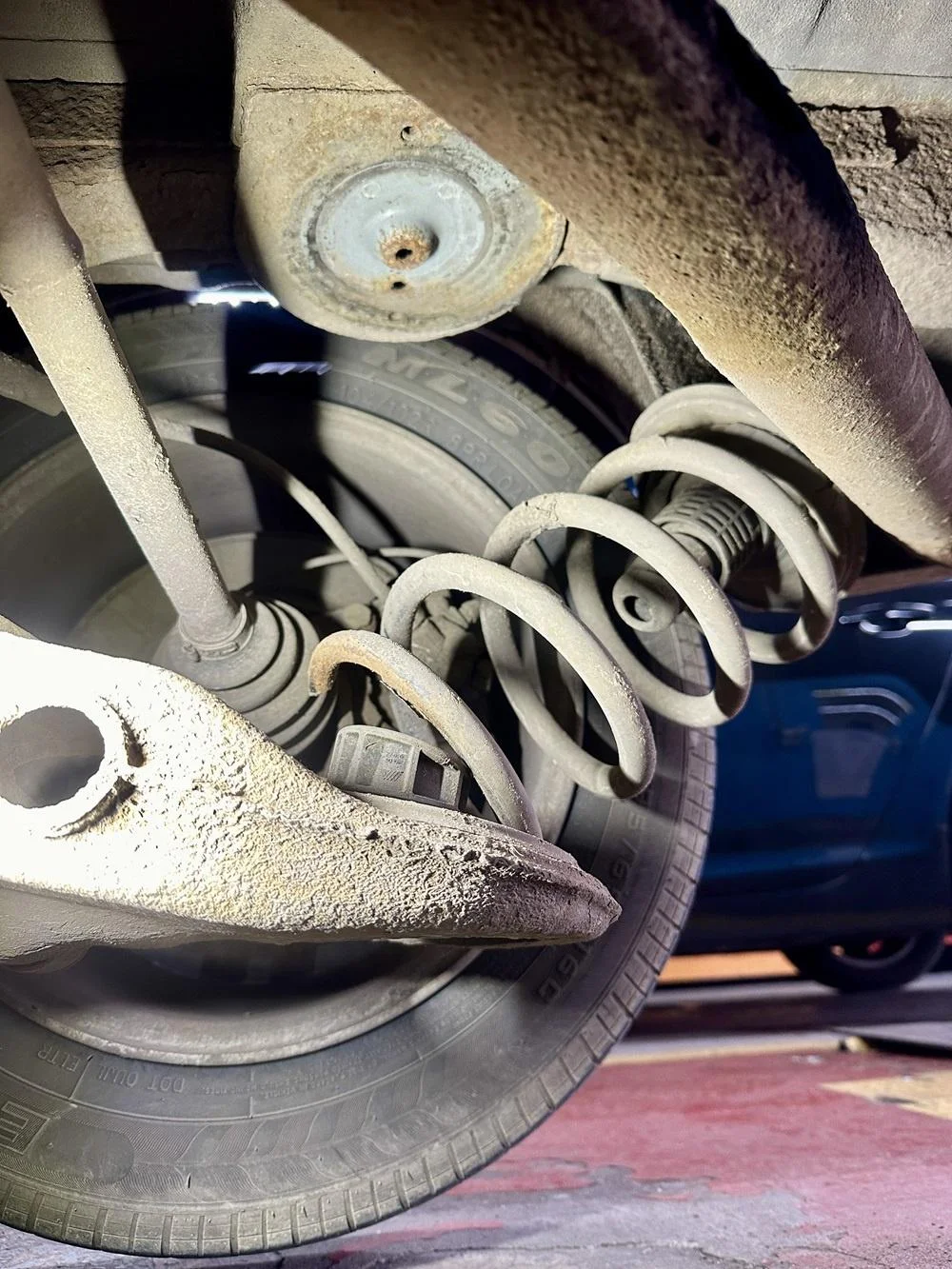

Coil spring snapped at the top and the bottom, and when the van was jacked up, it just fell out!
It also failed on tyres, lights, brakes and corrosion.
The brake hoses were so deteriorated it's almost unbelievable that they hadn't burst.
The inner wings were in such a state you could fit your fist through the holes that had rusted through, but there was no advisories on any of the 4 years previous MOT tests, so it's safe to say that it had serveral dodgy MOT's done.
The spring..
Imagine going over a speed hump and that fell out.

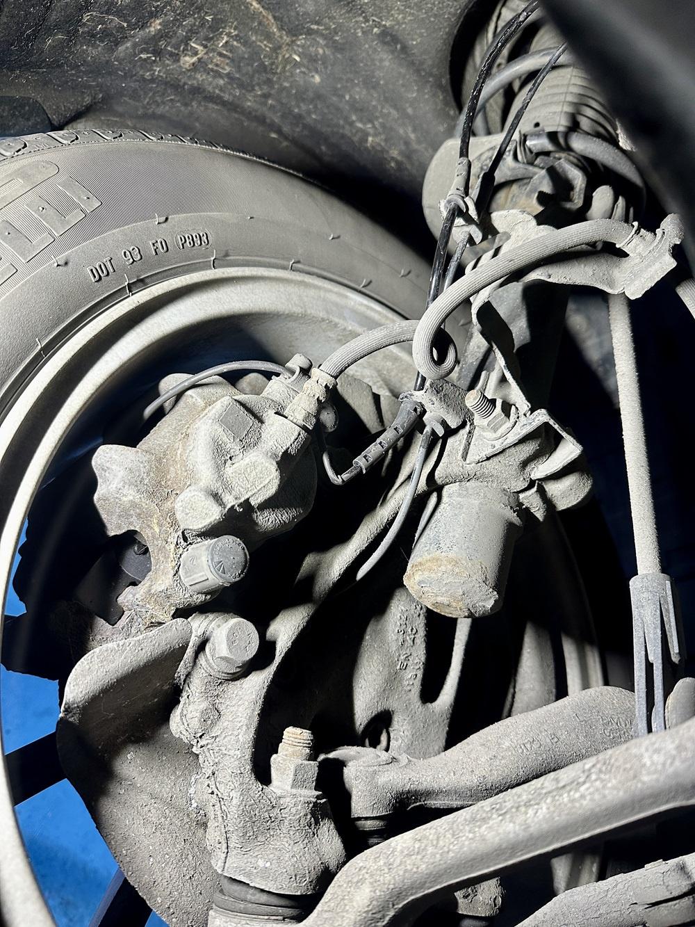

This BMW had just had new brake pads fitted, and unsurprisingly I failed it for what hopefully should be fairly obvious..
I did ask the guy who the hell had been let loose on his braking system, and he admitted that he'd replaced the pads, but when I showed him the above pic, he said it was like that before and that he'd not removed the caliper to replace the pads.
I guessed he'd used magic to fit them then.

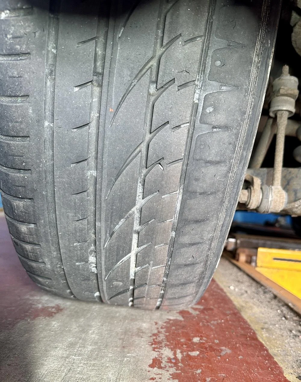

The next delight was a Kuga that was booked in for 2pm and the customer called to say he'd be late as he was having two front tyres replaced.
So, on to the MOT, and it failed* on the NSR tyre that was so devoid of tread that it'd worn down to the cords on the inner edge..
I asked him if the tyre place had checked the other tyres and he showed me this..
It clearly shows the NSR tyre as having 5mm and being legal, and I think it's fairly obvious that the tyre hasn't had 5mm on it for quite a while now even ignoring the fact that it's about to blow out.
If I hadn't MOT'd it, the customer would have thought that his rear tyres were on 5mm and legal would have happily carried on driving it for another few thousand miles.
*it also failed on 2 broken coil springs and insecure headlamps.
Obviously the tyre is knackered but what was the tread depth in the central 3/4ths of the tyre? They must have measured the central part.
Edit - it’s hard to tell from the pic, excluding the worn through inner edge.
4mm at best, but the report says "all depths are measured at the lowest point" or not as the case may be.

Yup.
When he’s taken the caliper off, he’s for some reason twisted the hose before refitting it.
It’s way way too tight, and I’ve seen it before where the hose is so tight it actually applies the brake when on lock.
