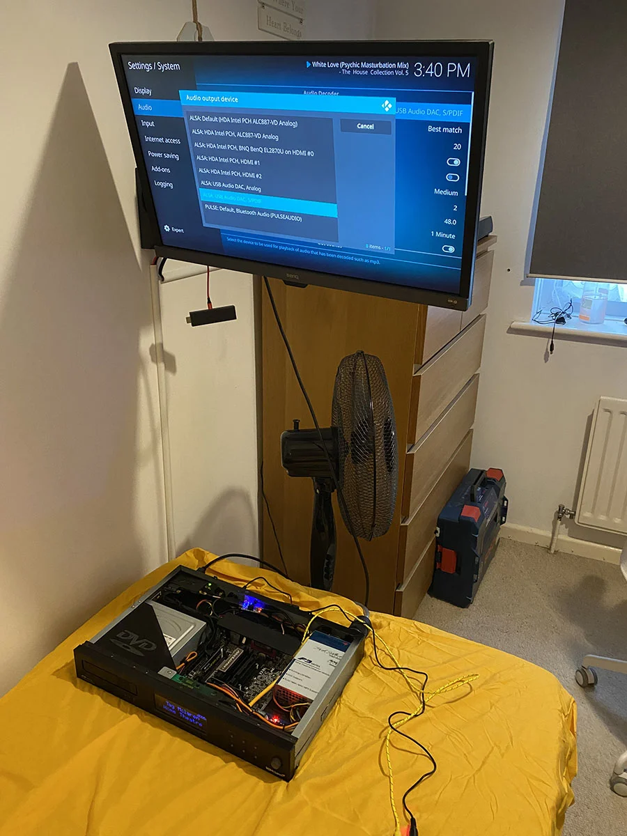

Well I am not using the Tag's DAC yet. However, I will say that the DAC I used for testing today sounds better than the Realtek onboard in the PC I use here. I have no idea what DAC chip is in there though.

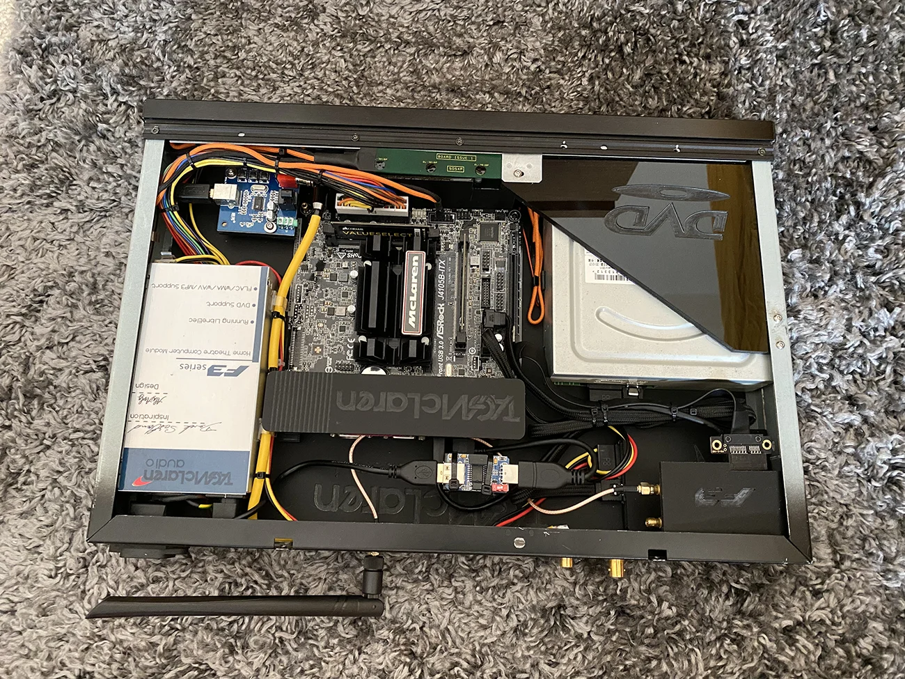

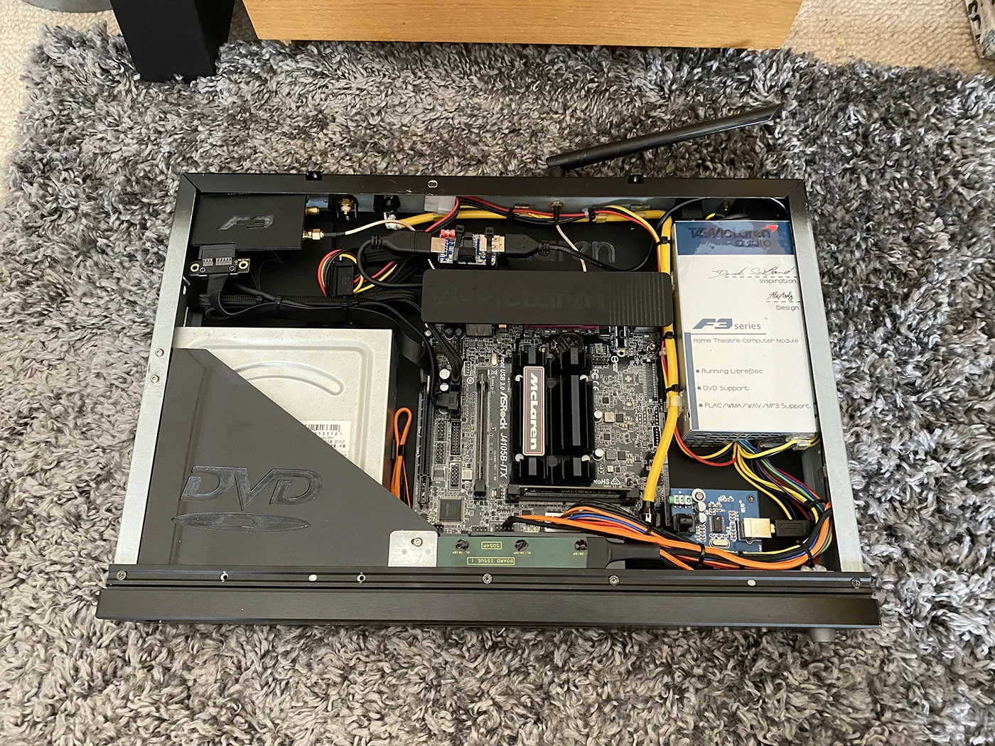

So today I machined what will hopefully be the last pieces. Last night after I posted I drilled and tapped the little table thing for the digital sound thing. I then fitted that properly. Today I made something similar for the filter in the rear.
I just didn't want it hovering around in there.

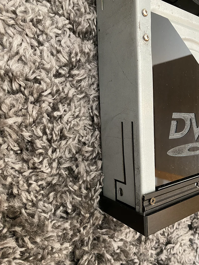

That should be all of the machining done. I do have a couple of things left to do, namely painting the edge where it meets the face panel here.
The top used to have tangs in that area that push fit into the sides of the front. Problem is it had been mangled and when I repaired it it ended up that the tangs would not go in there. Not even with a plastic hammer :D so I cut them off, but now you can see that silver metal through the gaps. I will likely just cut some vinyl pieces and stick them down.

OK just a quickie. I decided to cover those parts with vinyl. If I paint it the likelihood is it will scratch off very easily. I ordered the vinyl but it didn't arrive in time (common theme).

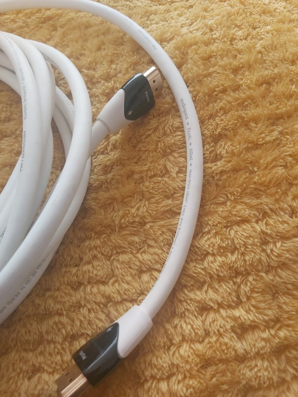

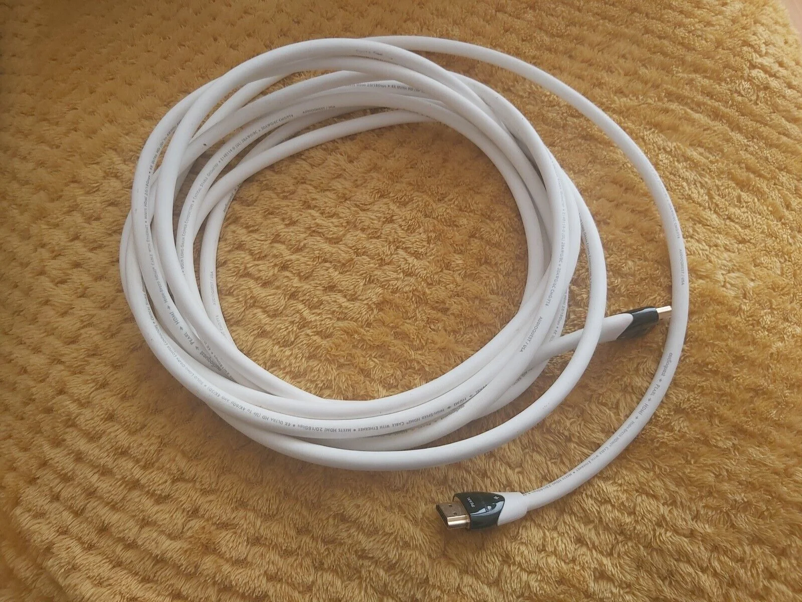

I also needed a 5m HDMI cable to set it up properly. 3m will reach but will be hanging in the air (never ideal). Problem is every 5m I have ever used has been crap, and either dropped signal or didn't work at all. Decided to splash on this, £35.

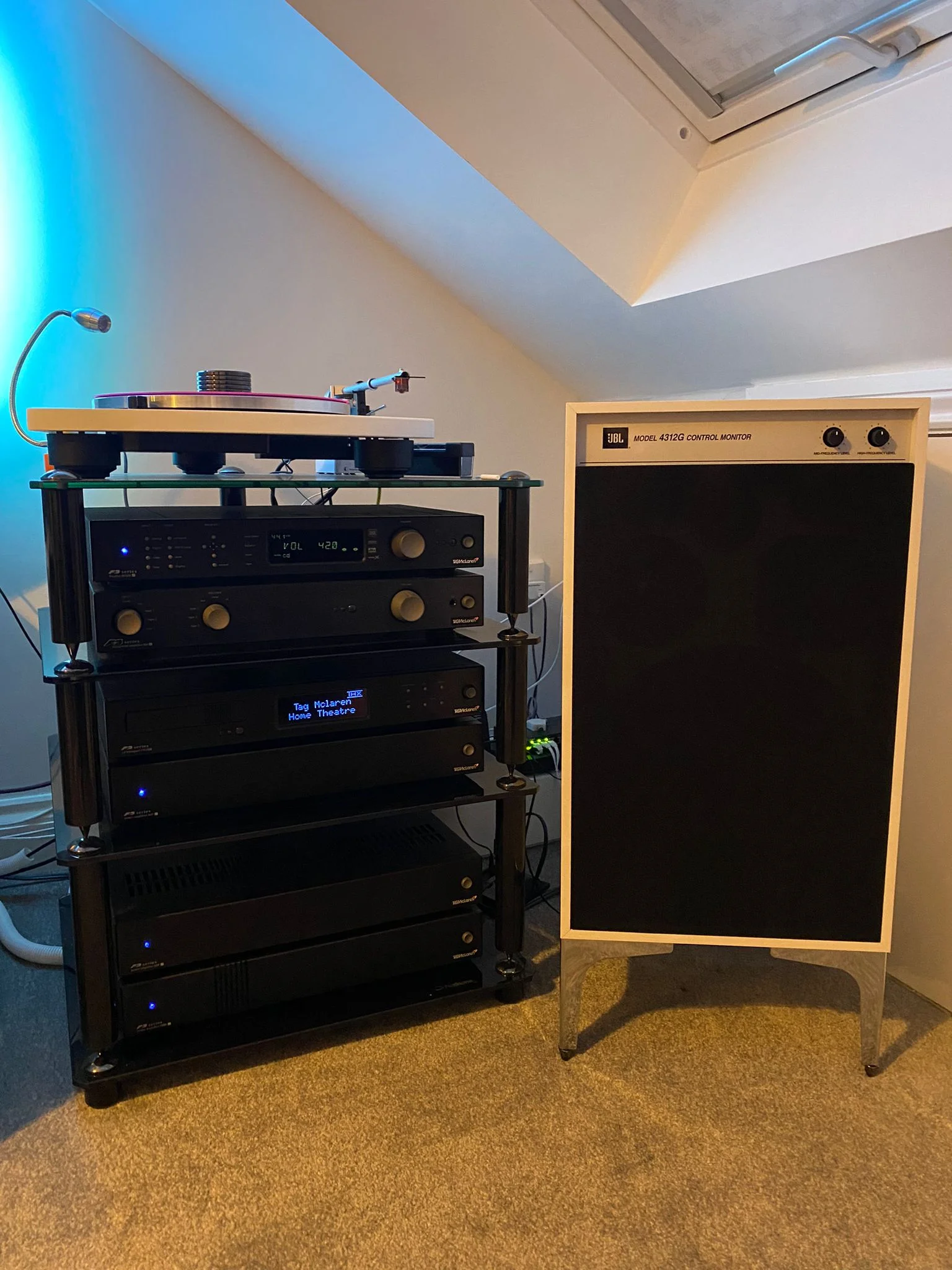

Yes many. They sound amazing. They are also nowhere near as big as you would think either. Like, before I was running two pairs of small speakers up front. I didn't realise that what I was looking for wasn't achievable.
What I mean is? dynamics. I had always had big speakers with three way designs. Apparently stereo imaging is better on small speakers but it wasn't that I wanted. So I relocated the L52 classics to the rear, put the Revel in the bedroom (ongoing project in there) and these actually take up less space than what I had before.

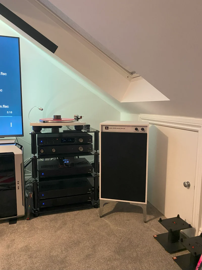

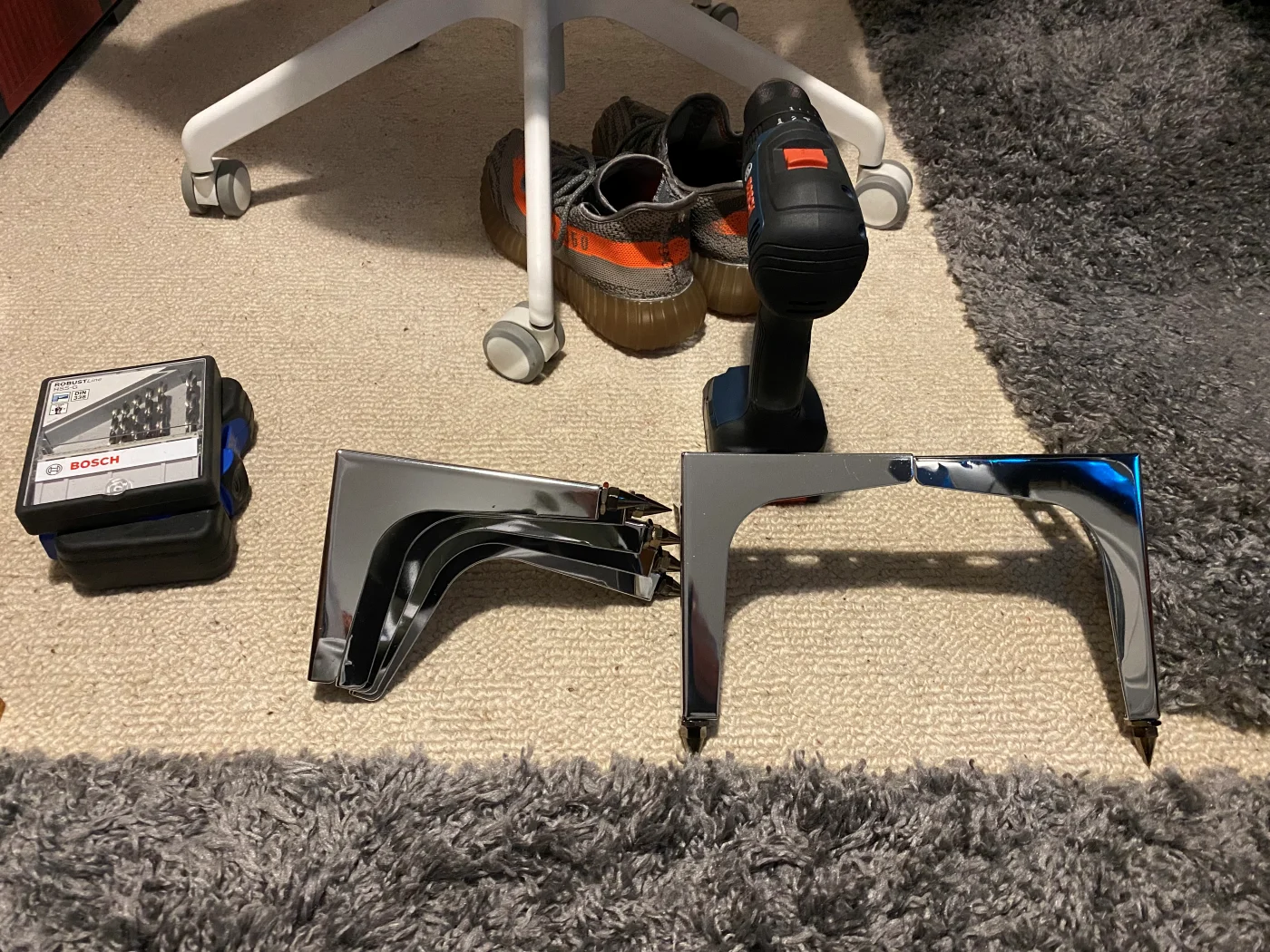

Sadly when I returned I returned with a nice dose of Covid, but that has given me a lot of time to listen. BTW the legs? yeah, after I got the speakers for £999 delivered I was in no mood to spend 1/3 of that on the stands. So I spent £30 on 8 chrome legs, 8 M8 spikes, and a pack of 16mm screws and did it that way.
Just a simple drill and tap and they were good to go.

Oh and as for power to drive them? don't worry about it. I have the Tag 100P going into them and it is more than enough. They are "only" rated 100-200w. It's the sensitivity that helps them no end. The Revel? low 80s. That means to get what you want out of them you had to drive them pretty hard. Meaning loud and shouty. These are the complete opposite. They emit buckets of sound at much lower volumes. And again, the dynamics make them fill the entire room with sound without driving them in any way hard. I would say 60w per channel will be more than enough for the desired result tbh. I've never turned the volume up more than 43db on the pre amp, which is less than half of what it goes to.
