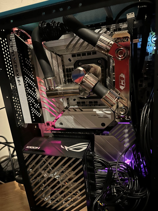

Made a couple changes and was impressed with the results. (Still need to cable manage at some point).
Switched to the Iceman direct die cpu block. 31c improvement on some cores. Highest core was in the sub 70s at 340W Cinebench.
Also had to RMA gpus and went with a Heatkiller block. Quality on this is solid. Came with precut pads and gave me a 4c improvement over my EK block. Impressive when it costs slightly less.

Would they not just send a new riser out? That sucks. I do like your current build though, and I agree that the heatkiller blocks are really good.
