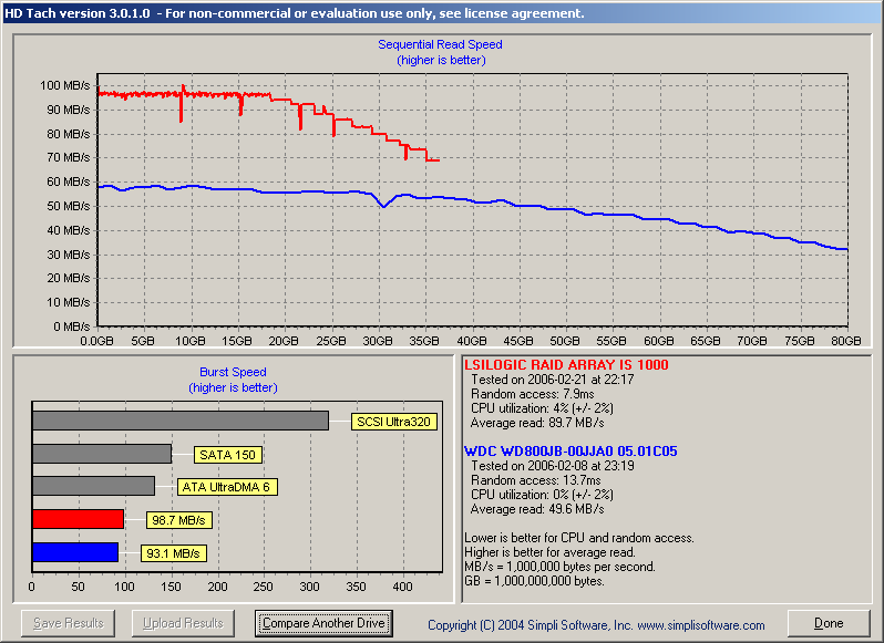

Hi,
It seems I've got a very similar setup to you - 2x10k rpm scsi drives (in my case fujitsu man3184) in raid 0, and i'm getting pretty much the same result.
HD Tach graph
The graph is comparing these two drives in raid 0 to an 80gb WD pata drive.
And I've noticed the same about the burst speed - pretty low considering the average read.

hmm just noticed are you using a pci slot by any chance?
I'm using an old Asus (a7v600-x/via chipset) motherboard, and it's a pci-x card in a normal pci slot, hence the poor performance. However, I got the drives and card off a popular auction site cheaply (<£50), as I wanted a play with scsi and raid. Having said that, it's still a fair bit faster than the pata drive I was using, so can't really complain :)
Whilst I appreciate that it would be faster in a pci-x slot, I definitely am seeing some benefit to using two drives.
