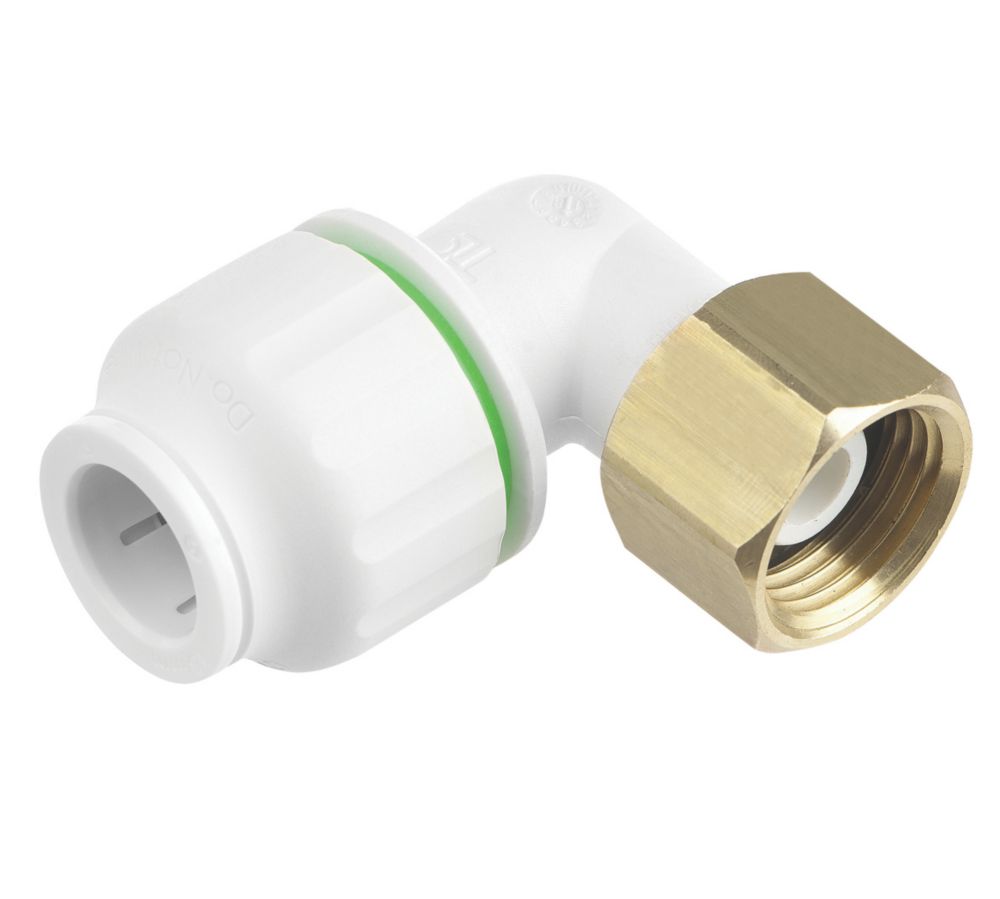

For the inlet on the grohe cistern I used one of these
Thanks for this - it expedited my thinking on the tap connector. I went Hep2o and swapped out the compression fitting that was giving me grief, too:
