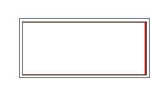

EDIT: I've just noticed that there's one at the top of the screen too. And a smaller one at the bottonm. The left side is fine though.

Yeah, there was one in there, just plugged it in, (there's no difference in visual quality as far as I can see) and that black bar is there. I've tried auto-adjusting, but that does nothing - even when there's no cable plugged in and it comes up with the "no xxxxx cable" screen that black bar is still there - as if that's not even part of the monitor screen :/
Can't get any pics - but I've tried drawing it in paint - the red lines are where the black bars are.
I think this is just down to the screen not being properly aligned behind the bezel and so the part of the panel that doesn't show any pixels is showing a bit too much on one side. So long as the image on the left of the screen isn't cut off by the bezel then i wouldn't worry about it. All of my past screens have been like this, although they were more centered, and so i think it's normal and just the fact that the bezel doesn't cover the panel enough.
this is an expensive monitor, I wouldn't accept that! Every screen i've had has had perfect alignment, I'd be very disappointed with that after spending £500 on it.

Yeah, I am a bit - but in a rather sadistic way, I'm glad I'm not the only one who has it :rolleyes:

You could get it replaced, and end up with one exactly the same... or even with a dead pixel as well...
These monitors are meant to have a black boarder round the screen image anyway (of 1-2mm), i guess with these ones its just a bit uneven.
