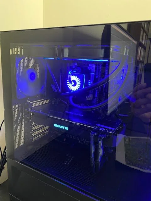

Just an update.
I have gone for the Lian-Li Lancool II after watching numerous videos online, and OCUK shipped today and will be with me tomorrow..
I will be top mounting the cooler in this case and will update with pics when it’s ready!
Hey guys,
Just got my new system setup. Man what a difference in my experience!
Looks so much nicer and the temps! Well, let me tell you about them..
They arent LN2 temps by any means but by comparision..Played a sesh of 64 man conquest BFV. My temps before would be roughly at peak -
CPU - 65c
GPU - 70 (fan speed 90-100%) :eek::eek:
Since the change :
CPU - 58c
GPU - 63c (fan speed peaking at 70%) :)
Very happy, and although my idle noise level is slightly higher, the in-game noise (even though I dont hear much with either my speakers or headphones, has dropped a lot, so another bonus!
do we get some piccies? lol
Not the best photo in the world but here you go..
