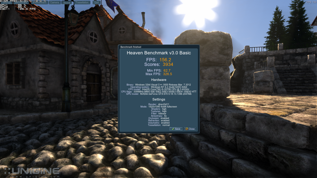

I thought I would have a go at doing some benching as I couldn't be bothered to play anything and it appears that Nvidia have blocked any kind of over volting :(
Grrrrrrrr, very annoying.
What do you mean?
My 670's at 1.2V are working as normal. :confused:
I use Artmoney to get as many volts as I like but it will not allow me to change volts :(
Not that bothered but I was a little bored and thought I would give Heaven a bashing with decent volts.
