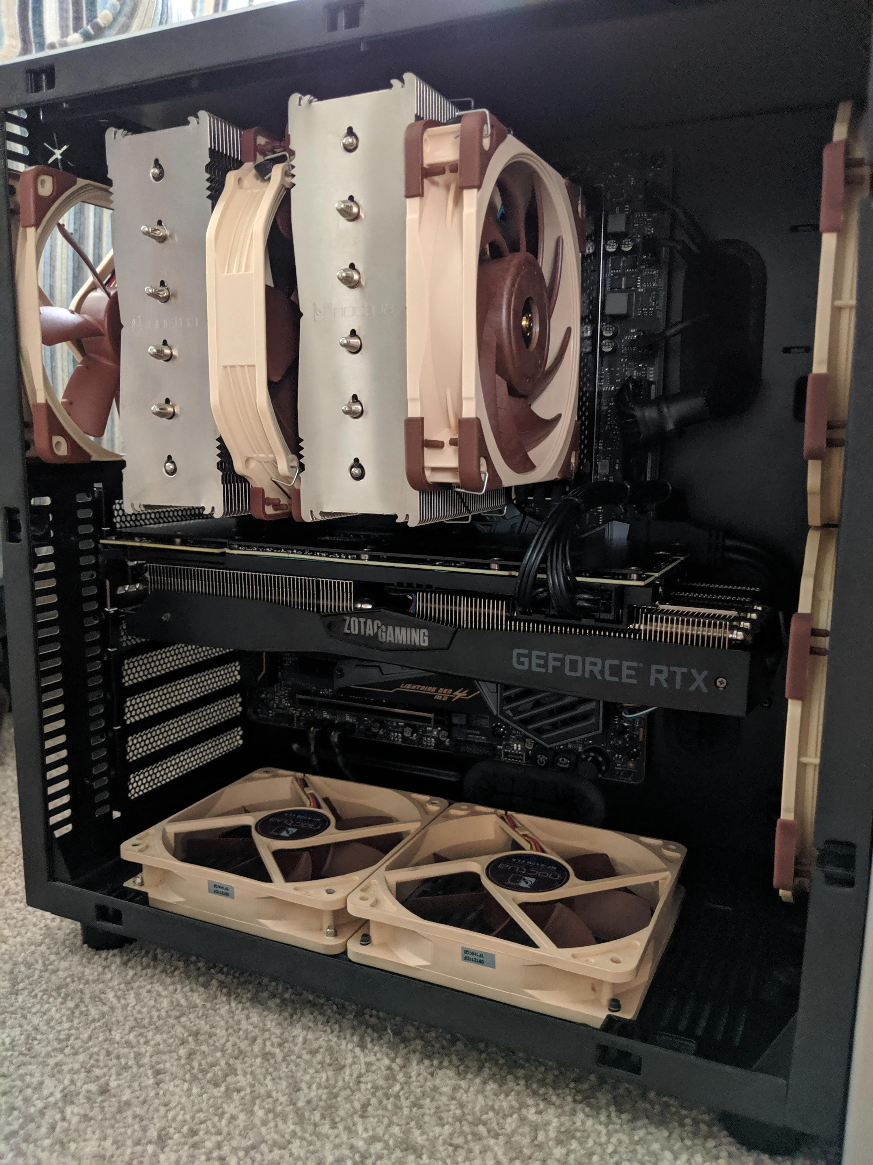

I'm using the D15 as well but I swapped out the front 140mm for the new A12x25 120mm to give me RAM clearance, using low ish speed fan curve, approx 800rpm under load I'm getting 59° in R20 and around 65° in Aida64 stress test.
XUlLxfG
