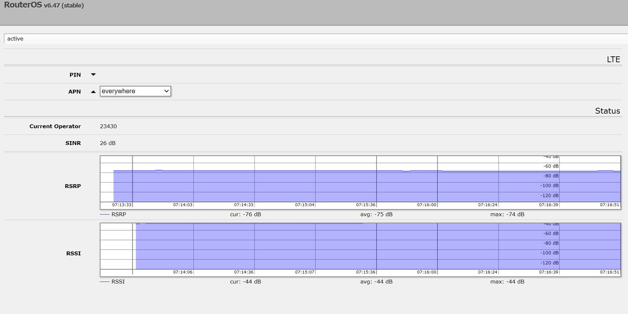

No i didnt tick all the bands.
I ticked them in this screen, and hit the 'apply config' is that how you do it?
Im not gonna touch anything yet as I have not checked any guides. I will wait for the tips, so far though its working on the devices, will patch in a couple of wifi points later after im happy with the config.

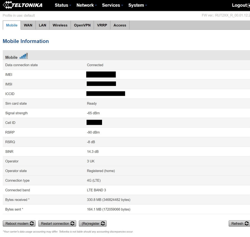

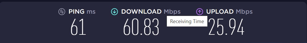

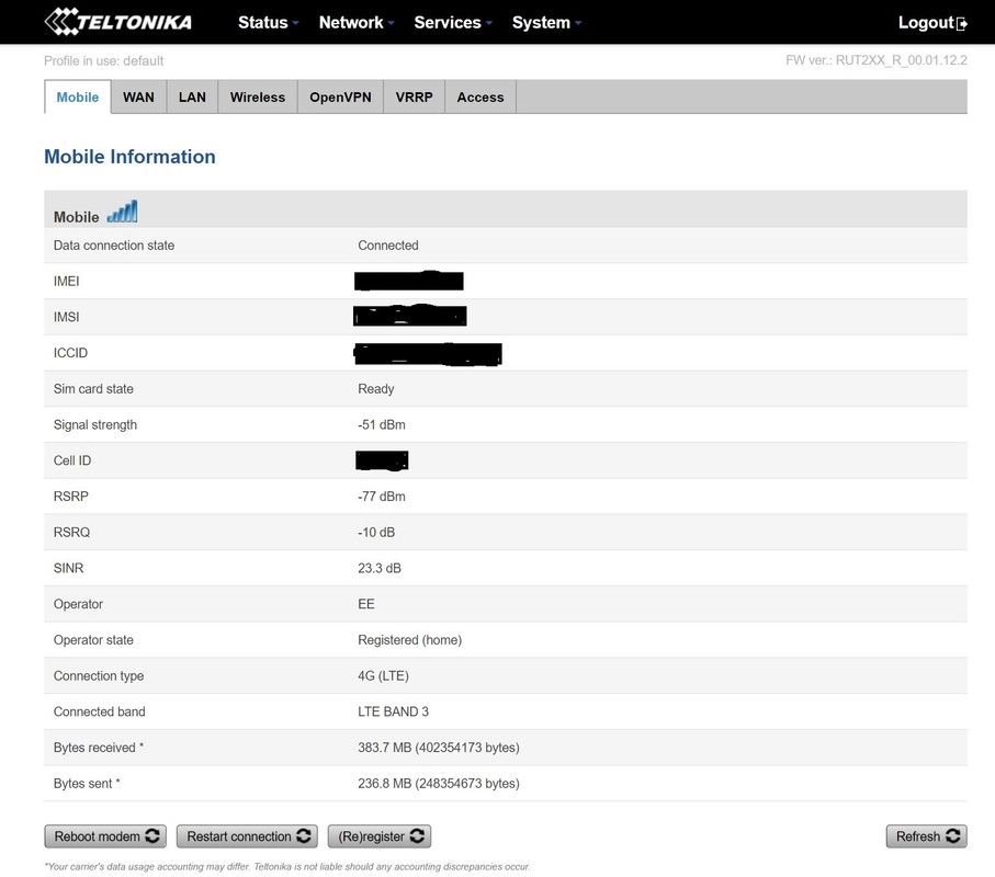

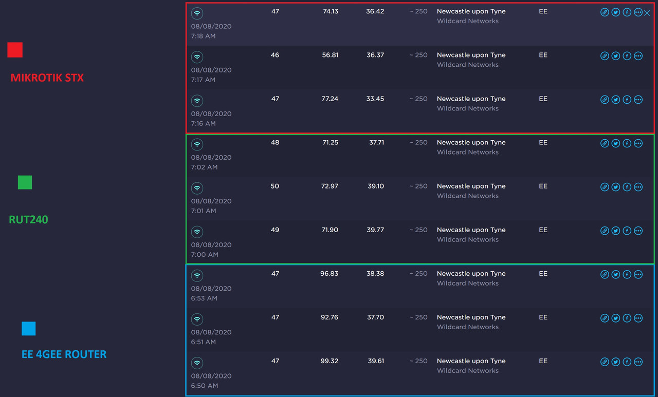

Ok, got on this early as speeds can be erratic later in the day with all the holidaymakers hogging the net.
I wouldn't pay too much attention to the speeds themselves, more the difference in the speeds, they don't stay that high all day haha. Both the 4gee router and the RUT one are using the same antenna's. I'm not sure how much fine tuning i can do to help the STX as i can literally see my mast, its only about 1.5 miles away. But thats full bars on the 4gee and RUT routers with 4/5 bars on the STX.
EDIT: With the RUT router, the RSRP doesn't look great, i think this is due to the massive antenna cables im using. This is my daily home net driver on Three as the EE one is just used for gaming. The Three mast is further away, no LoS and this is using an omni directional antenna and PoE.
