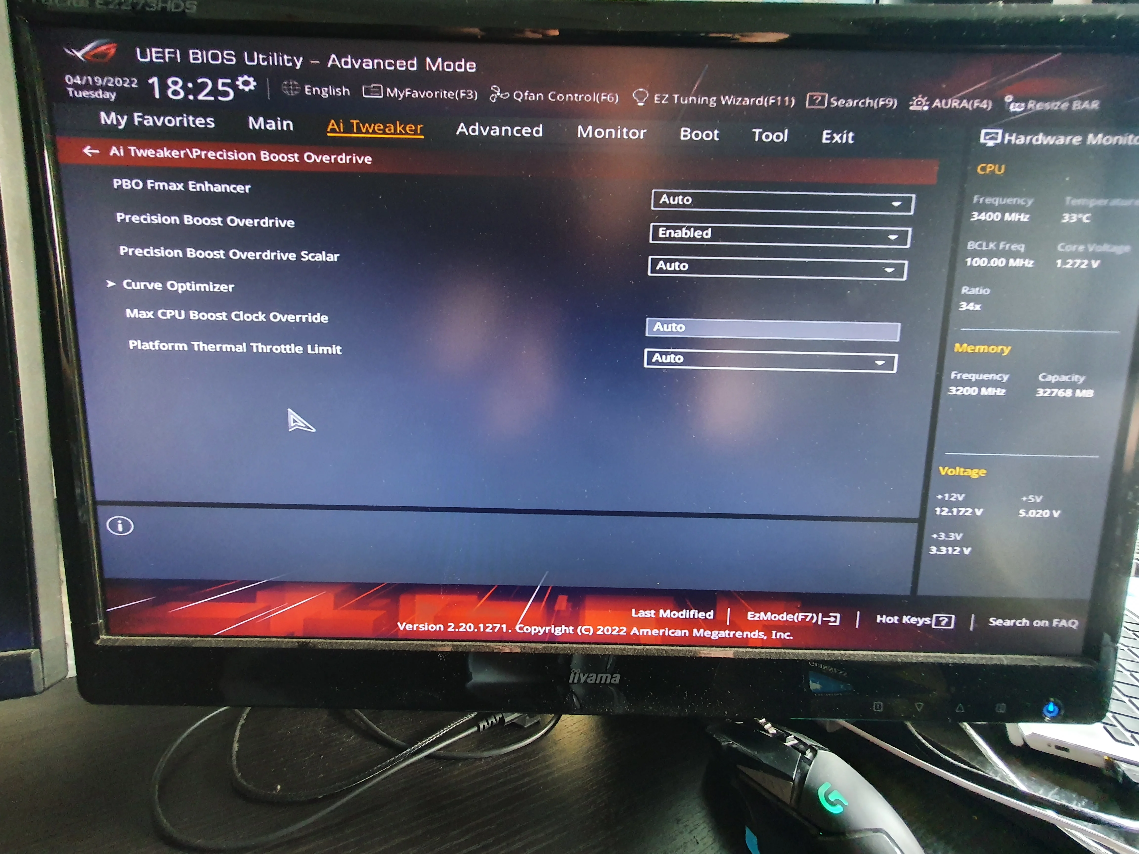

I'm using the EVGA 280 and it litterally shoots up to 90+ C in about 10-15 seconds in Prime 95 Smallest FFTs, I'll probably be home in about an hour so i'll test Cinebench and CPU-z and post back results plus PBO setting in BIOS

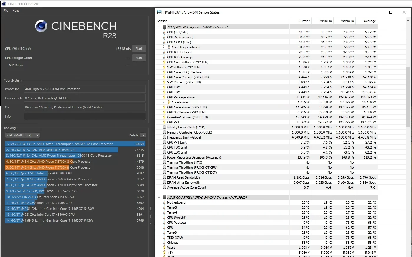

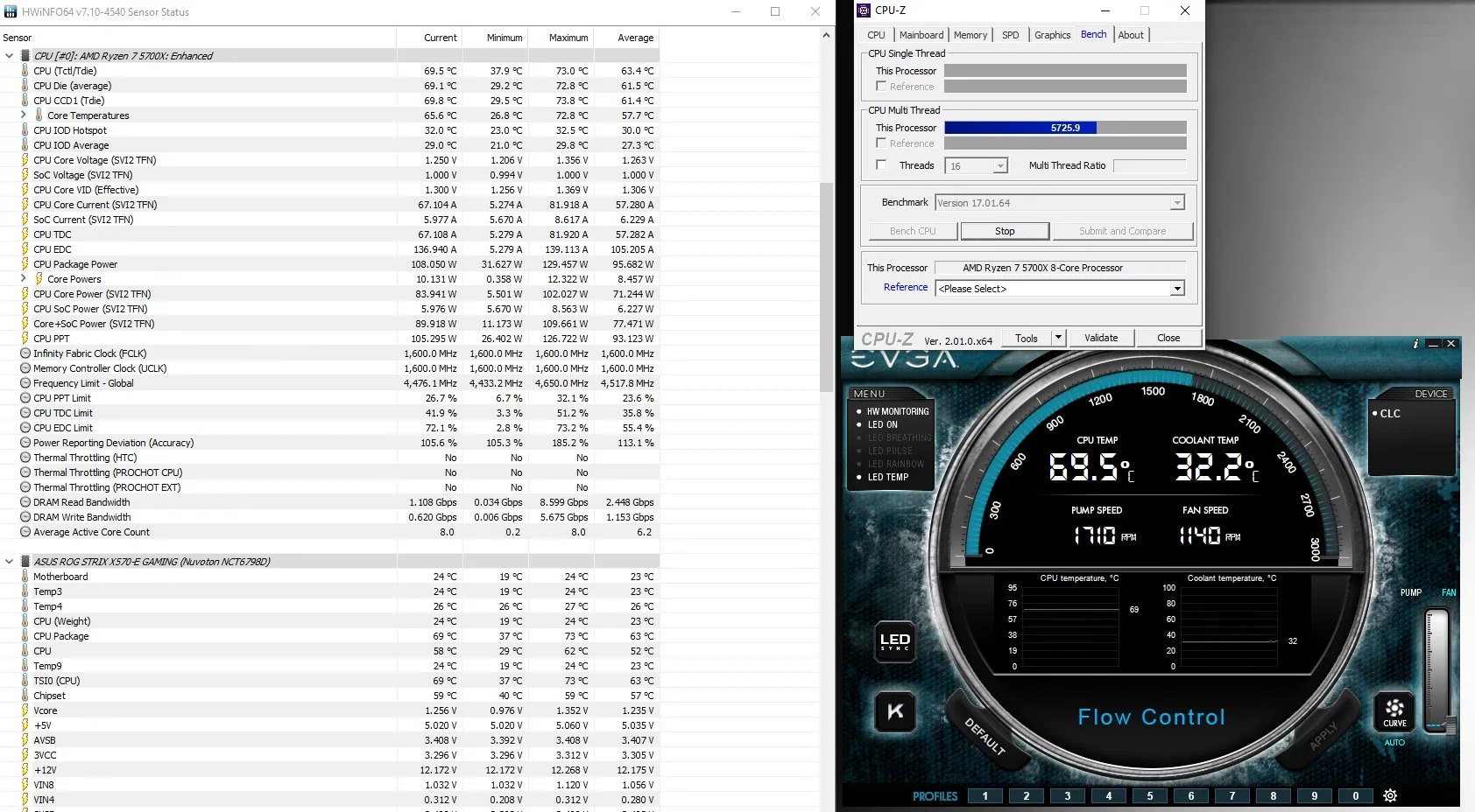

ok so. so far it seems normal i guess.
mine is sitting now idling at 38c
and when i do prime small ffts i hit a max of 74c but mostly hangs in the late 60s
do another prime see what happens
