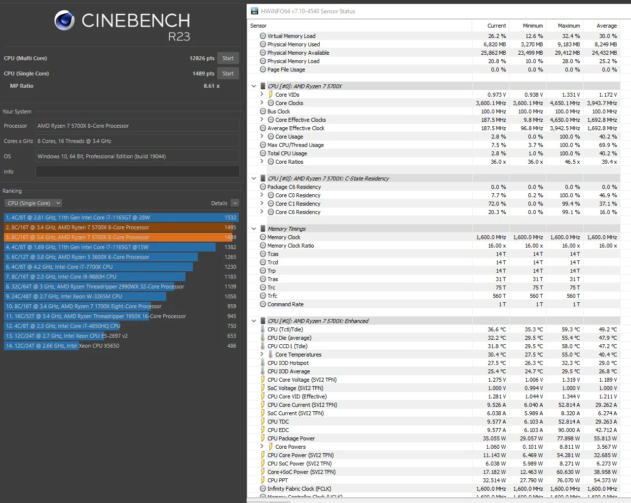

Its difficult to know what the score is supposed to be, the 5600X is also a 65 watt CPU but 6 cores, it scores 11,000, the 5800X is 8 core but 105 watts, it scores around 15,500. So somewhere between that.
Your 12.172 run looks perhaps a little low but temps are excellent and its only drawing 62 watts on the cores.
The 14,579 was a higher? over 100 watts on the cores.

That was mine at stock (12,172), I think the other scores must have been when I had PBO enabled and PBO Fmax Enhancer set to auto. I dunno whether to just reset bios to defaults and turn DOCP on and see what i get, don't think I'd changed anything else but just to see what the defaults should be...

this is my cinebnech screenshot
dont know why it dont show the screenshot and just the link lol

13,500 seems about right to me.
At this point we have figured out what's what with your temperatures, it was pulling too much power to begin with, i feel like that Fmax thing is making a real mess of it, who knows what its doing but what i think it is doing is interfering with the natural state of the CPU.
AMD will have the CPU at a set volts and amps and power limits that are correct for the CPU, that Fmax thing looks to me is just throwing all that out of the window and applying its own values that are no where near optimal for the CPU, for example pushing more volts in to the CPU than it needs which is causing it to use more power than it should so its reducing clocks to stay with in the set power limits and that's why your scores are lower than @aachil

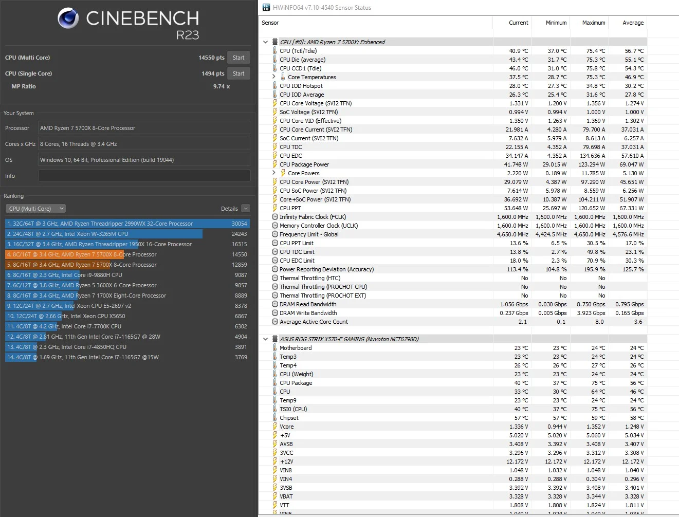

So I've disabled (from Auto) the fmax setting and I did 2 tests one with PBO set to Auto, then set to enabled:
CPU PPT MAX: 76W
CPU PPT MAX: 120W
With the PBO enabled doing Prime 95 smallest FFTs still goes up to 90C and 155W CPU PPT. So my options are leave PBO at auto and sacrifice a bit of performance or leave it on as the Prime 95 smallest FFT test is unrealistic in real world scenarios. I basically use my PC for gaming ...

Thanks for all the replies, so I never really messed around with any of the bios settings for my 3600x, i just stuck DOCP on and done. Looking at my last pic the one with PBO enabled (not just auto)
I noticed that the max was:
PPT = 120W
TDC = 79.7A
EDC = 134A
Are these values anything to worry about, do they need to be limited or are they ok as long as my temps stay reasonable? With the TDP of the chip being 65W, do they relate in any way?
