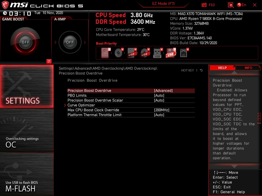

AMD 5800X AMD Curve Optimizer Boost set to 5050Mhz for all cores and good temperatures when PC gaming. So basically when all things are good thermal,electrical ETC all cores have the ability to boost up to 5050Mhz.
Precision Boost Overdrive 2 AMD Links
1. https://postimg.cc/4nLFm1qc
2. https://postimg.cc/68RHbx3V
3. https://postimg.cc/B8Bms52X
4. https://postimg.cc/0r2Bk4Wx
5. https://postimg.cc/hfNy0tSP
6. https://postimg.cc/06sVLXMT
7. https://postimg.cc/Xpr1FC6z
offset VF curve voltage chart

My AMD Curve Optimizer per core

The AMD Curve Optimizer can sustain the boost for longer time,where PBO can not all by itself.
On the MSI boards you can go up to 500Mhz and I have seen my 5800X hitting 5200Mhz with adjusting the PBO settings that last for a half second boost .
Also on Core 5,it is weaker so that is why I set like I did but it can run stable 5050Mhz just no higher on that core 5
So is that essentially opening up the headroom on the boost MHz but keeping the voltage sensible with those negative curve values? What units is it using, or just arbitrary scale?
Is this app inside ryzen master ? I'm on x570 aurous master and going to start fine tuning the system got another 16gb of ddr 4400 ram coming today and it will be on water come weekend never used a ryzen system so need qll the help I can get lol
Well I do not know much about it and I do not think many people know much either. It a voltage curve and setting negative I assume it shaves a little off CPU voltage ,not much though. If you set your curve up you can add more voltage over the default 1.5v and maybe tap out max I think is 1.55v. I just set it for stability and for my 5800X.
It is in the BIOS and part of the new stuff. Which is going to be fun with AMD CPU 5xxx and GPU 6xxx .Screen shots first post and you can check out the name.

Very impressive!! what method did you use to figure out that core #5 was weaker than the rest? How did you determine?
Well testing PBO out it was the lowest boost CPU core and it never went above the 5050Mhz,so I went with that.Also if you setting the settings positive or negative to high,you will not boot and I just figure 5050Mhz was good enough,it really does not make a difference in performance . I just like the bigger number.
What is curve optimiser? Is that what the new zen3 cpu has or a MSI bios thingy
Curve Optimizer. This feature enables frequency adjustment for each core in the processor without restrictions in BIOS. Not in Ryzen master yet or it could be I did not look. I can not explain it features cause I really do not know.I suspect in the next few weeks there will be a bunch of information.
