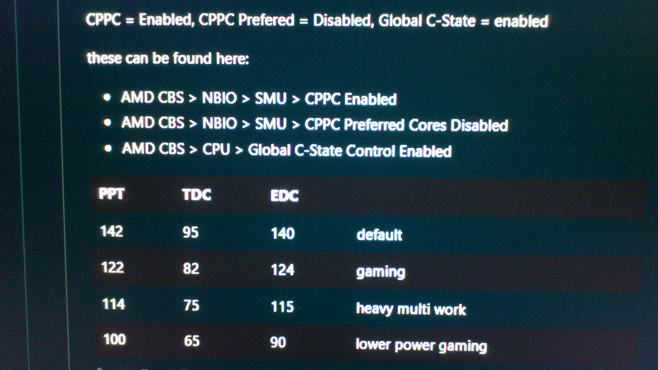

Im using Kombo Strike 3 which sets -30 on all cores and sets all the power limits too, but along with this I have a negative offset of 0.1000v.. core voltage is just Auto with PBO set to Auto.
Before I had Kombo Strike I tried these settings I picked up from Reddit a while back, tested them all with -30 curve all core with the same negative Offset/auto PBO/Voltage I use now and they all seemed stable with my chip.
Have you tried -30 on all cores with an -Offset? I've noticed on my chip that -0.1000v runs much cooler than -0.0875v Offset.. temp difference with these Offsets running CPU-Z/CB23 is around 5c cooler.
Maybe try similar settings to above but dont touch the CPU voltage and leave that on Auto, use a negative Offset like above with PBO also on Auto.
Using -0.1000v my max gaming temps are usually low 60's and CPU-Z is around 64c with CB23 around 70c.. all core is 4450Mhz, I even see this when streaming with x264 encoder. My ambient temps are similar to yours too btw, I never have my thermostat above 21c lol
