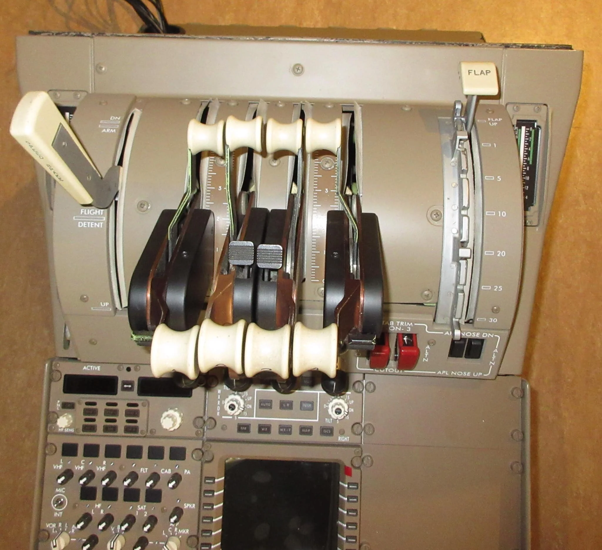

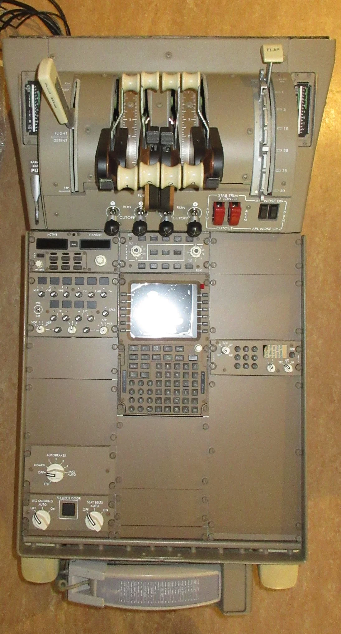

Just bought a real 747 throttle & stand

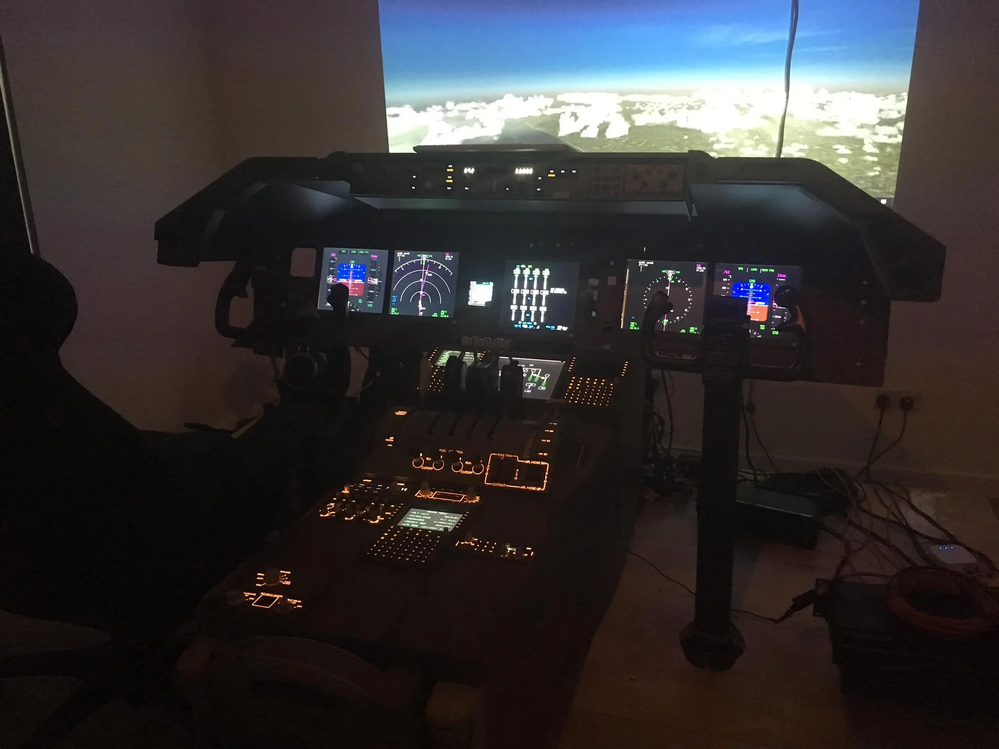

Planning on building the cockpit frame and running multi monitors or 3 projectors for the display?
I'm using 1 projector at the moment, so will work with Natvis in getting 3 projectors and a calibrated curved screen.
I've been working with Simujabs in getting the yokes all engineered to work with my sim.
Good news, throttle and pedestal coming on Monday! If anyone is free in south London to do some heavy lifting, I'd greatly appreciate it :D

Looks very cool, we use Aerowinx in our 747 simulator and have had a few 747 pilots use and instruct on it. So far all the 747 guys have been very impressed, the non 747 guys do not like it as much haha!
What interface boards do you use? The sim before ran P3D (before that FS2004 and before that no idea!) so used to have Leo Bodnar cards installed. I've since swapped the throttles, gear and some other controls to SimStack boards which are very useful. https://simulatorsolutions.com.au/simstack/
Another thing I love with Aerowinx is the instructor station works quite well on a touch screen. We have one mounted near the captains seat to change settings on the fly, but a windows (or I guess linux or other) tablet or laptop would also work and can be moved out of the way.
