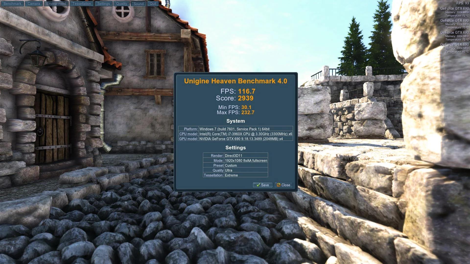

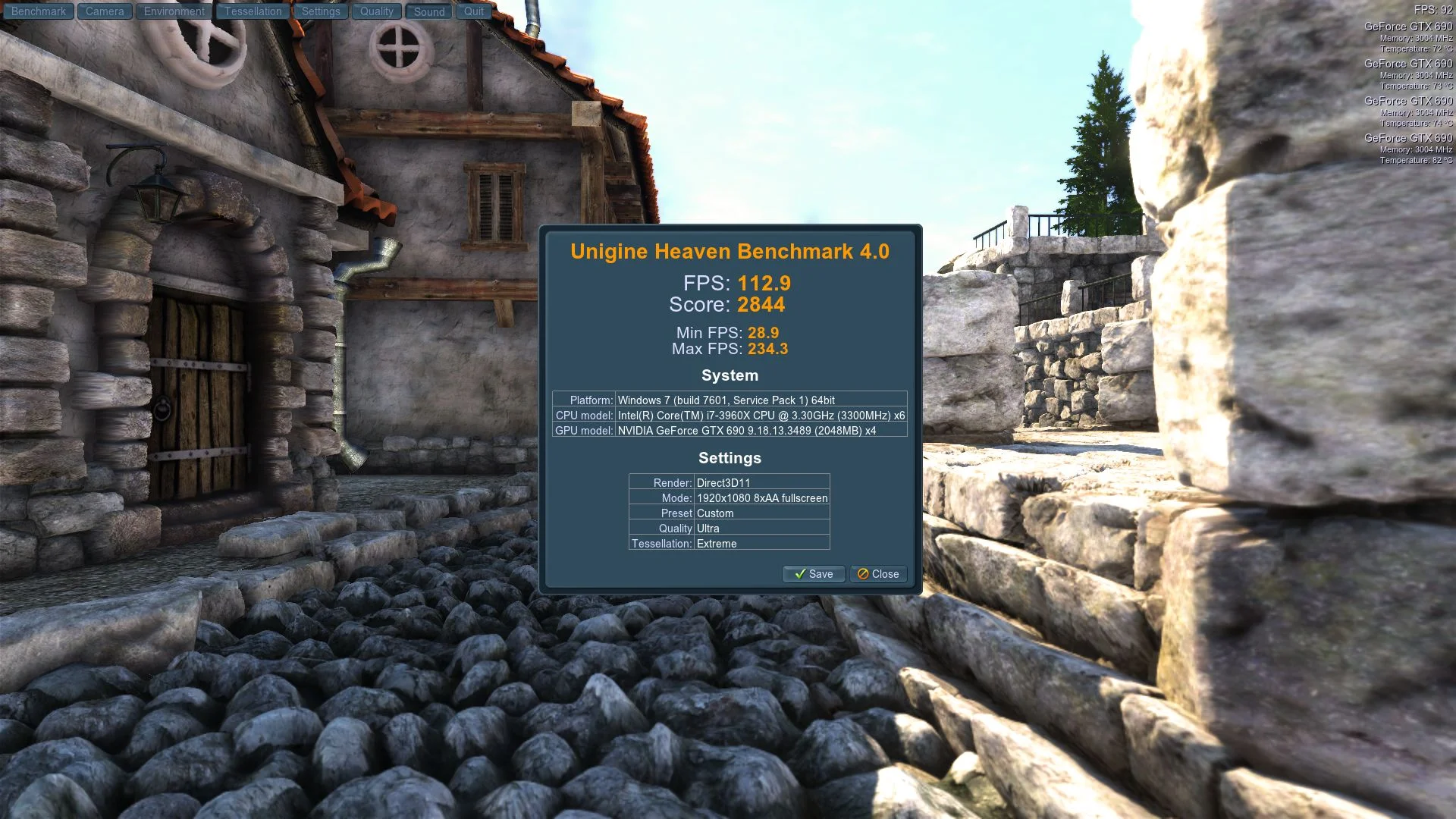

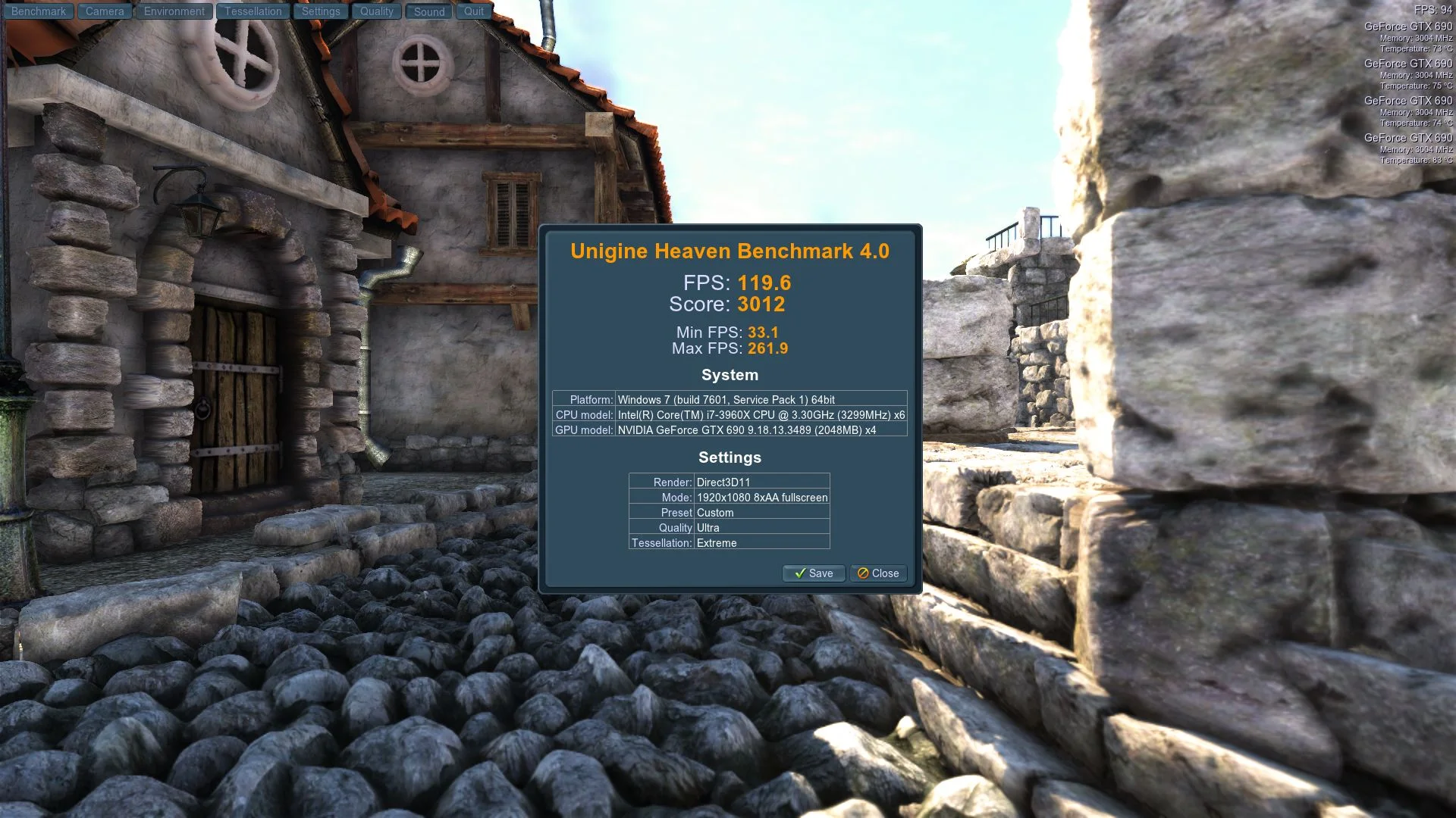

3960X results with two stock GTX 690s
Heaven 4
Gentle increases with CPU clockspeed.
CPU 3.8
CPU 4.3
CPU 4.8

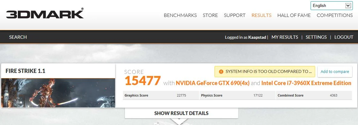

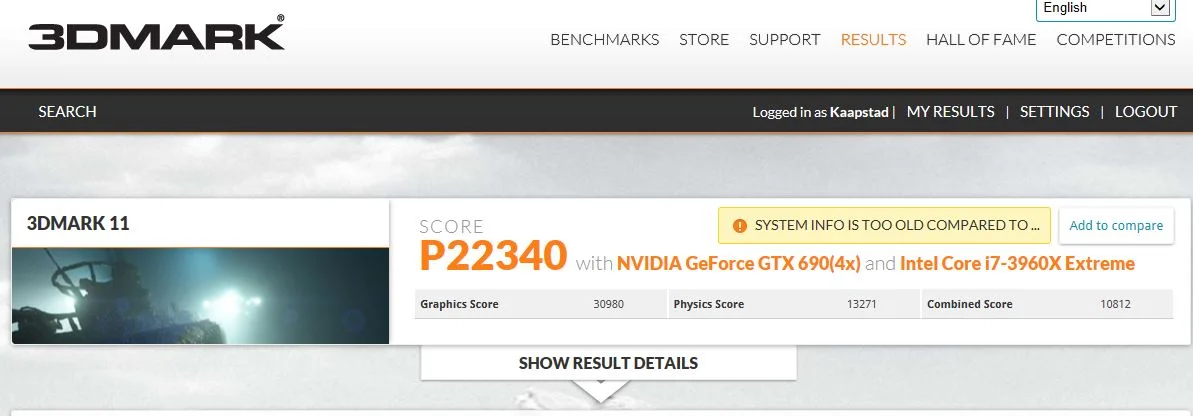

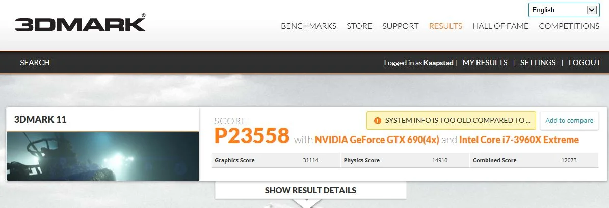

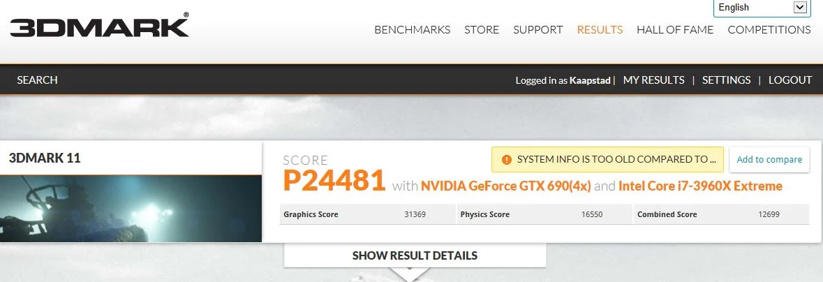

3dmark11 graphics score
3dmark11 and Firestrike surprised me as there was very little difference in score as the clockspeed increased.
CPU 3.8
CPU 4.3
CPU 4.8

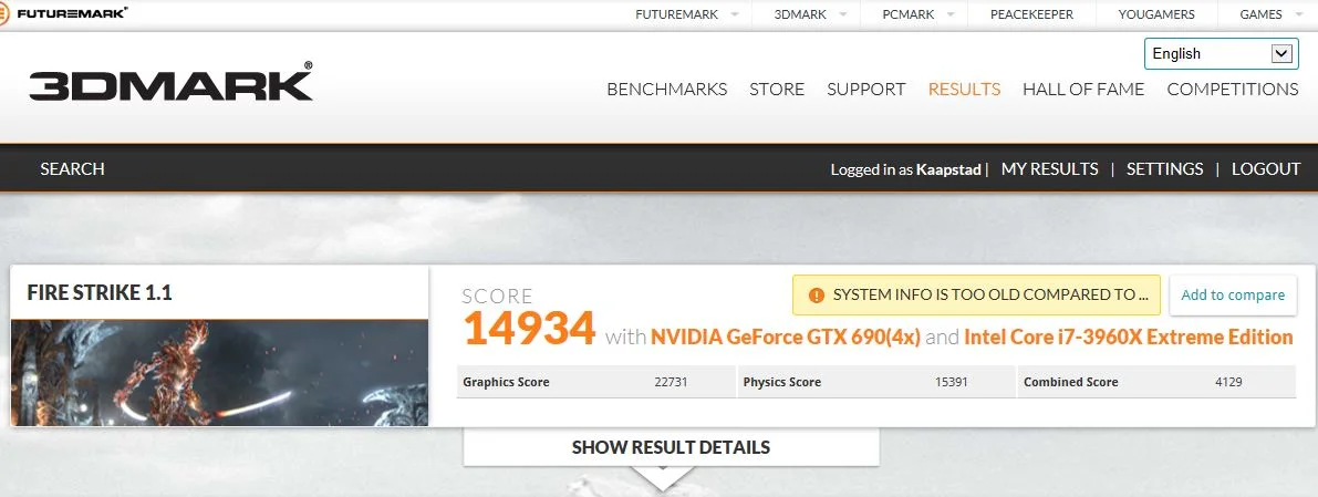

Firestrike graphics score
CPU 3.8
CPU 4.3
CPU 4.8

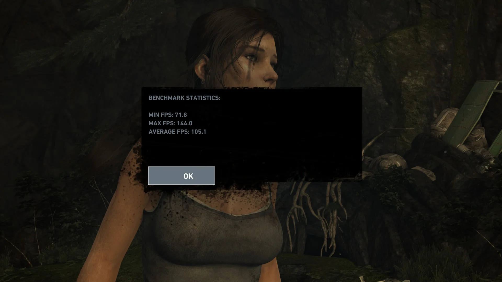

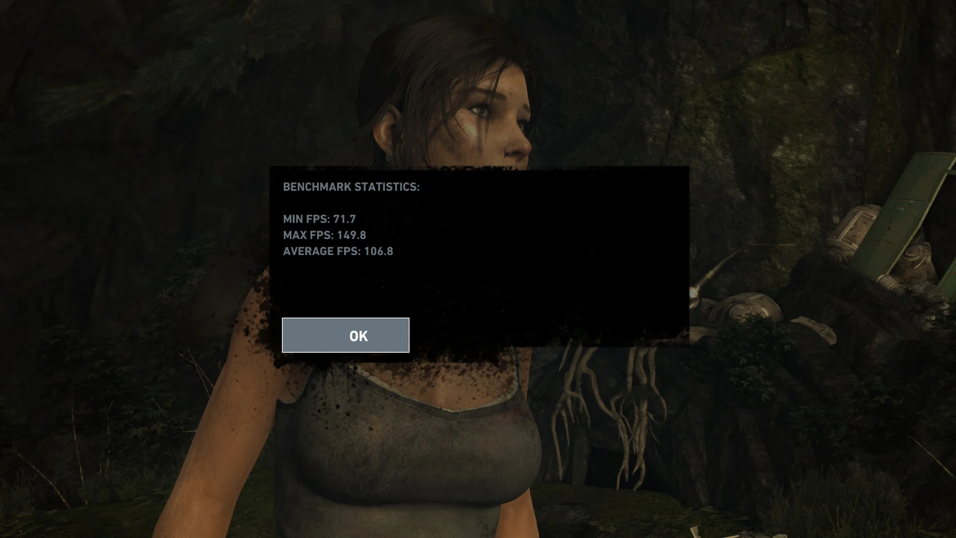

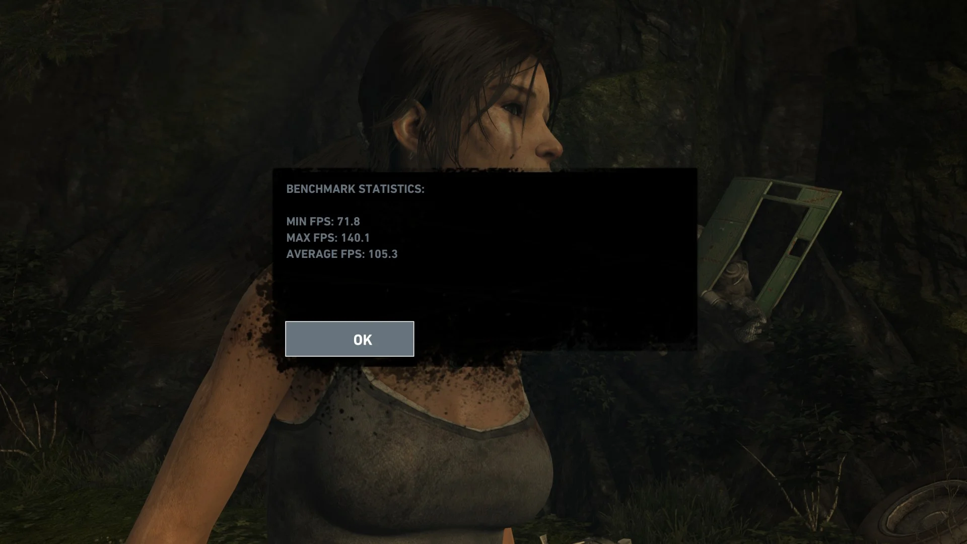

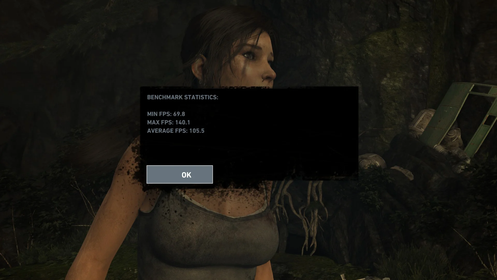

Tomb Raider
I was not expecting much from this game as it is not very demanding on the CPU.
CPU 3.8
CPU 4.3
CPU 4.8

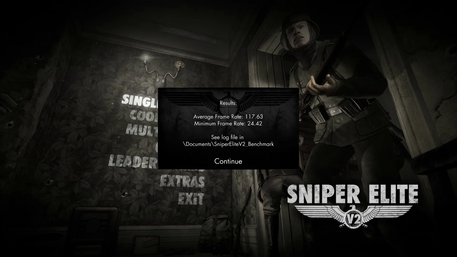

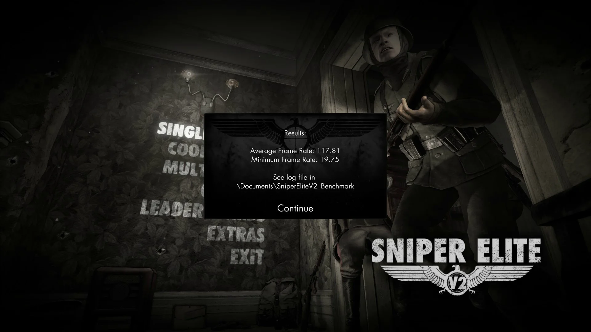

SEV2
Again another game that does not really tax the CPU
CPU 3.8
CPU 4.3
CPU 4.8
