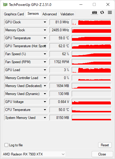

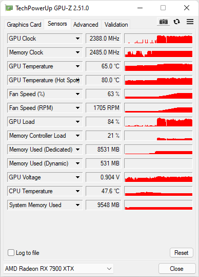

Post a gpu-z sensors screenshot after you have ran the benchmark. Would be a good indicator of whats going on.
Also read this thread for some undervolting info that could help :
https://www.reddit.com/r/AMDHelp/comments/zm24v0/7900xtx_reference_model_thermal_issues_110c/
GPU load isnt touching 99%
