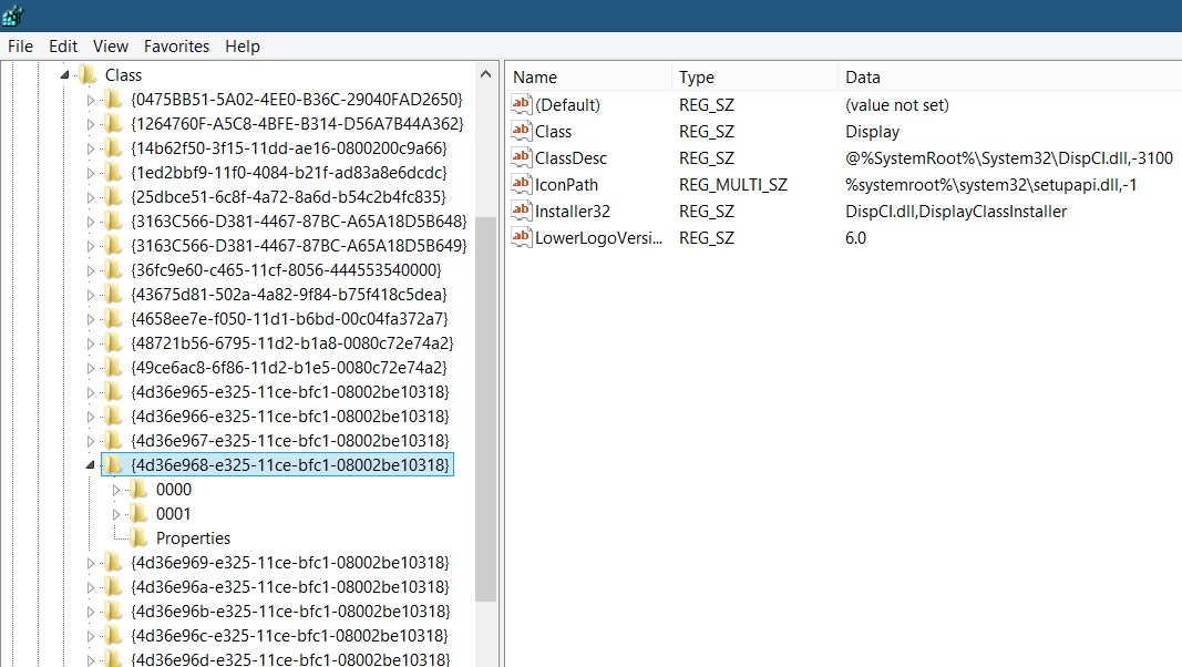

You can either increase the power limit to 30% as in this thread. That is the easiest solution. You need to re-do it every time you install a new driver. Setting the limit to 30% will stop the card from throttling even with a hefty overclock.

Thanks mate. Both look complicated, the bios flash obscenely so. The first might be within my means, however. The only bit that looks a bit baffling si where the OP says "Find your other gpu and export the reg entry again". How the **** would I do that?
The bios flash is pretty easy actually. You should have a bios switch on your card so if anything goes wrong you can just flick the switch bios position 2 and you'll be back safely on the default bios.
Your other gpu will be 0001 (assuming you have two gpu's) or something like that. Here's what mine look like.
0000 is my first gpu and 0001 is my second gpu.
