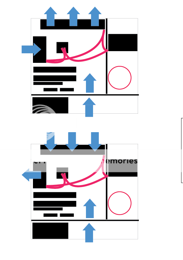

Anyone any thoughts on how I should plumb it in. i.e what to connect to what. I've been reading up but there seems to be a few options
As long as it starts res>pump (which isn't an issue in your case) the rest doesn't really matter.
Traditionally most will go res>pump>Components>radiators.
I have bottom intake, top and rear exhaust in my 800D, when I had the rear as intake the fan used to scream due to the grill.

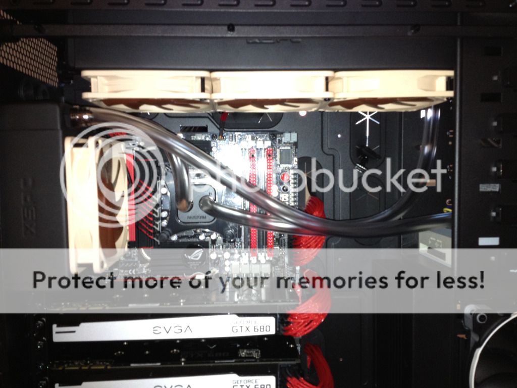

Hi all, Just dry fitted it. Any thoughts or suggestions before I add the compressions and unplug ready for water test. Pump/res-360rad-cpu-120rad-back to res/pump
Just up and running. With 2600k @ 5ghz (1.43v) ran prime for 1 hrs temps are
70c room temp is 29c. would you expect any better from RX360 & RX120 rads?
