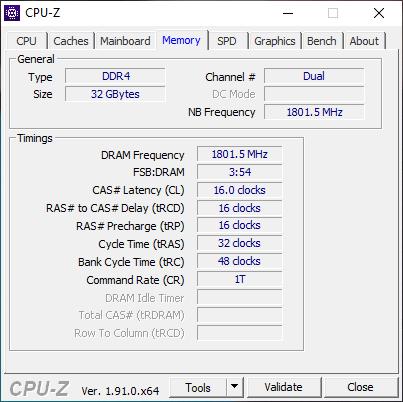

I am running 4 sticks 32GB at 3600 16.16.16.32.48 @1.37 V
GDM on.

Does your Fabric clock and memory run in synch because auto often lowers it for stability.
Note my NB Frequency shows as 1799.6Mhz same as my Dram frequency.
I also have 32GB of the 4400 stuff running at C14 but at 3600Mhz and my tRc is only 48.
But yes it is good memory.

Yup your North Bridge frequency has stepped down / isn't in sync.
