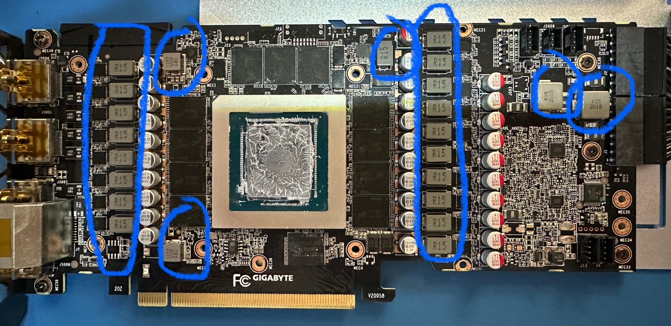

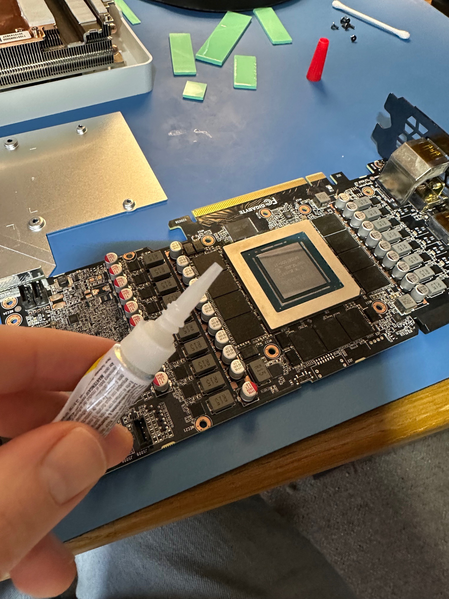

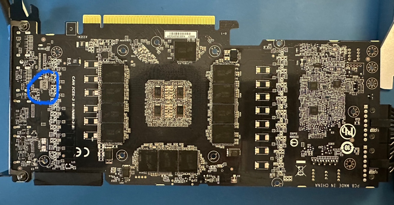

before the noctua mod, in the end, just to assess the coil whine scenario. A silent fan card with just coil whine could be annoying as heck!
Did the glue solve the ‘coil whine’ though? Hmm, maybe a little? Not really though. I don’t think the stress / effort was worth the outcome in my case, but it really wasn’t a particularly noisy card to begin with.

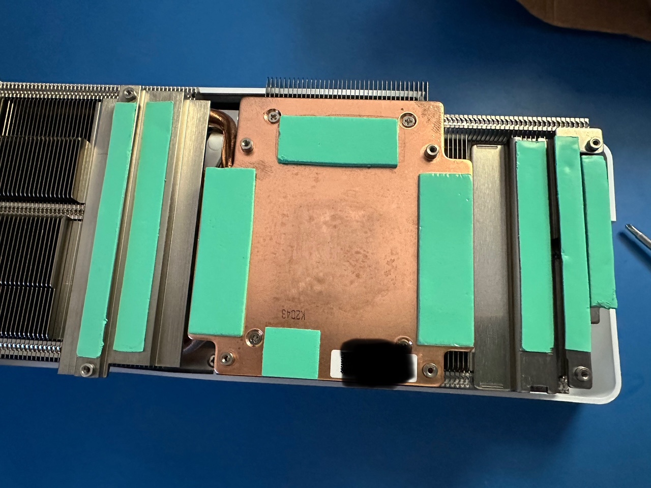

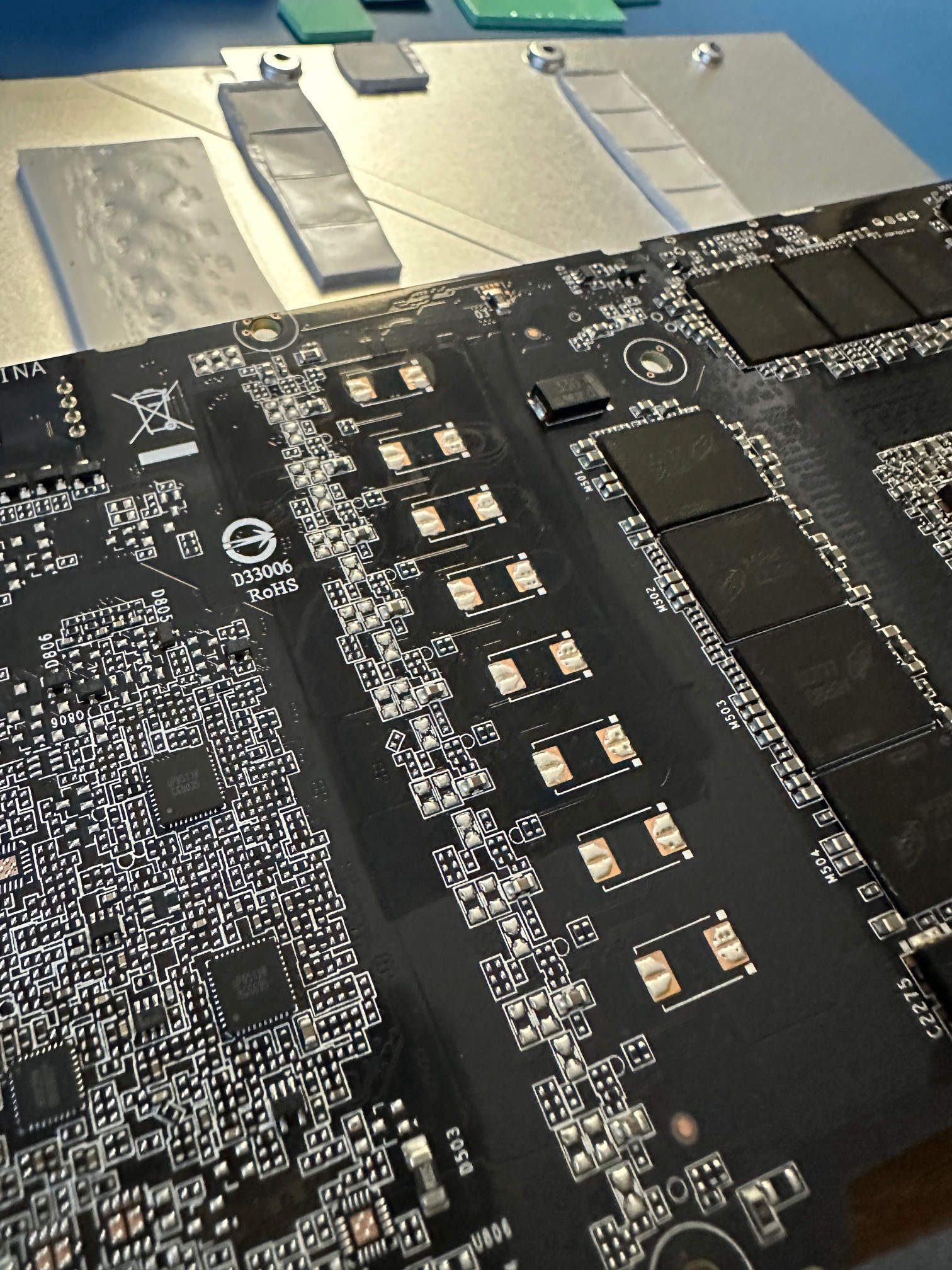

The card is definitely cooler with the new thermal pads though. Ragging the GPU to 100% for 10 minutes and the hotspot didn’t exceed 85 degrees, not bad. Overall temps at 100% were still around 65 degrees, fine by me, and it was sat in the 20s at idle
@pBay after you’ve mounted your thermal pads, pay attention to how the backplate is sitting when you remount it, especially when you reassemble the whole thing and put pressure onto the thermal paste area. I think the pads are thinner but ‘less squishy’ than stock so there is scope for the backplate to bend very slightly with over-tightening. I doubt it’s an issue either way, just keep an eye out for it so that nothing extreme happens

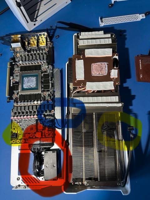

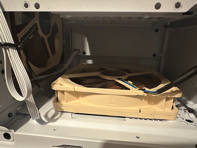

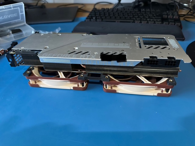

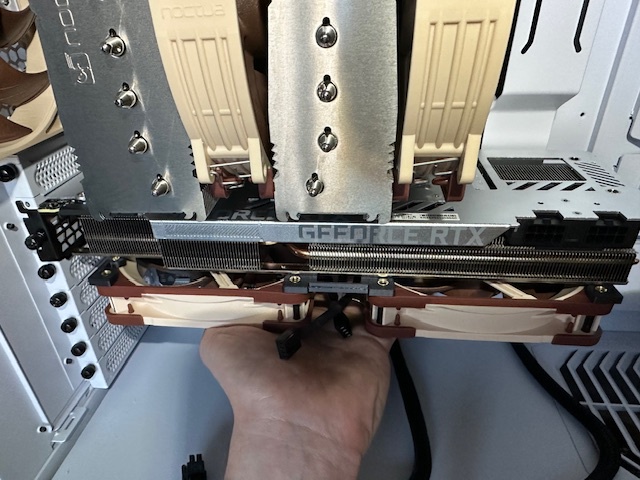

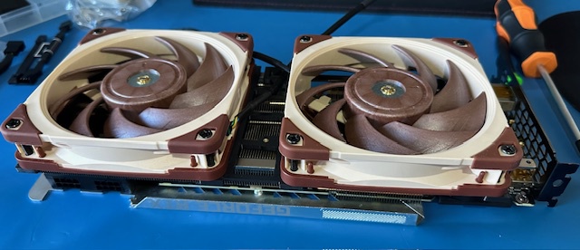

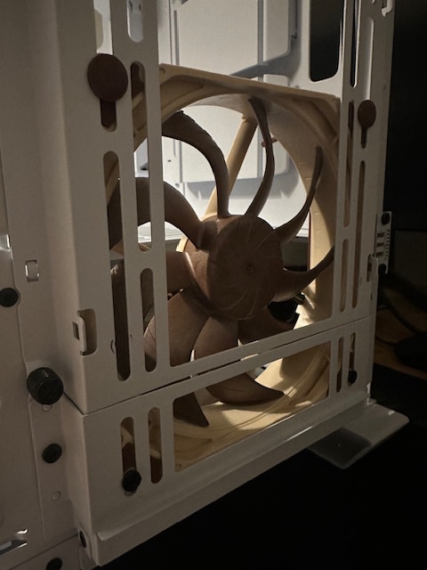

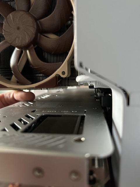

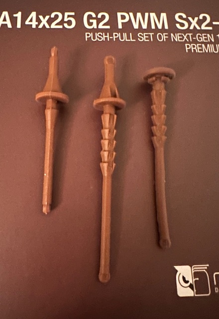

As expected, there’s absolutely zero chance of this kit actually mounting the card, which meant it was a case of lining everything up with my eyes, using the glue again and hoping for the best… no ability to remount the stock fans after this…. good lord, I don’t half put myself through it, do I?
I had to visualise whereabouts the fans should sit… needs to ‘look’ right to the eyes, but not sit so close to the motherboard that I couldn’t mount the card.
What followed one of of those “**** it” moments - glue deployed… lets gooooooo!
Turned out pretty damn good. My eyes didn’t let me down and it’s looking slick!
Just waiting for the glue to settle and will plug it all back together
