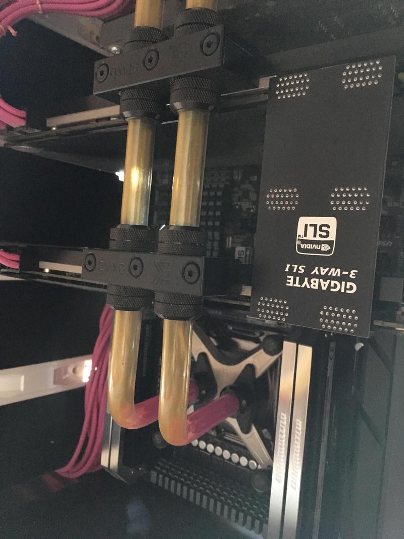

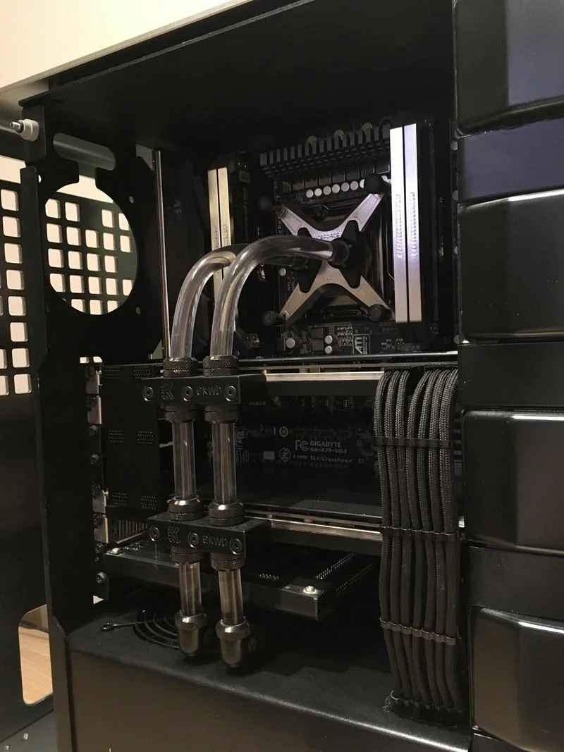

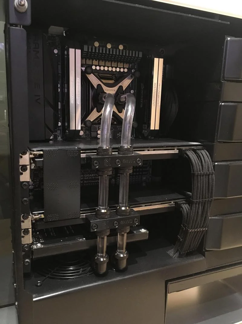

Love the build, hoping you can clue me on the loop though. I thought tubing had to go in one side of the card and out of the diagonal opposite, in order to get full flow around the cards? From birdseye: In top left, out bottom right.
Nope, this is a parallel flow. Has its own issues to consider but is perfectly feasible.
So if I'm only going with one tube into the card, am I able to do it like this or do I have to do opposites?
I don't get you. You still need to have an input and an output on the water block, so you can't have just 1 tube on the graphics.
With the parallel flow Shawy's done, you go into the graphics card, out the matching side, into the CPU, back out of the CPU then into the graphics card again. So whereas normally on a GPU you would exit diagonally opposite where you intake (using 2 ports), you're exiting directly opposite because you have to come back in again (using all 4 ports).

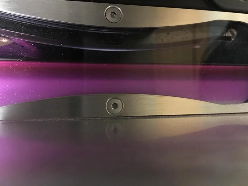

After nearly 4 years of use & neglect, I finally got around to properly finishing this build, the way I should have done those years ago.

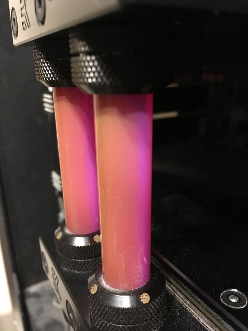

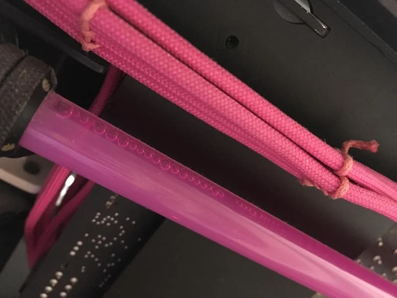

As you can see, Mayhems Pastel shouldn’t be used for this length of time. The white particles completely separated from the rest of the liquid, there was a semi-pastel suspended in the middle, and a rather clear pink fluid floating on the top.
Elsewhere in the loop, there was no pastel left, just bubbles and transparent pink fluid.
There was also some discolouration in the tubing, likely from the sun.
Here you can see the discolouration of the tubing more clearly after draining the loop.

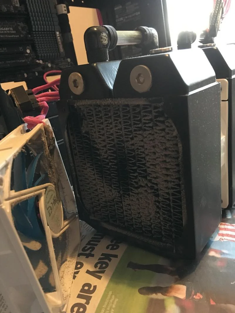

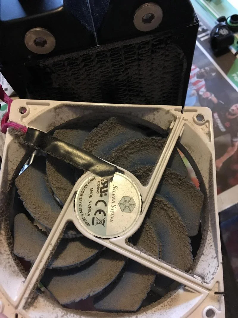

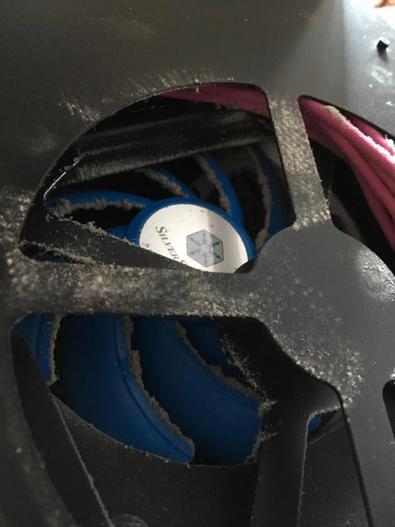

As well as the manky fluid, the fans didn’t age well either.
Or the radiators.
Gross.

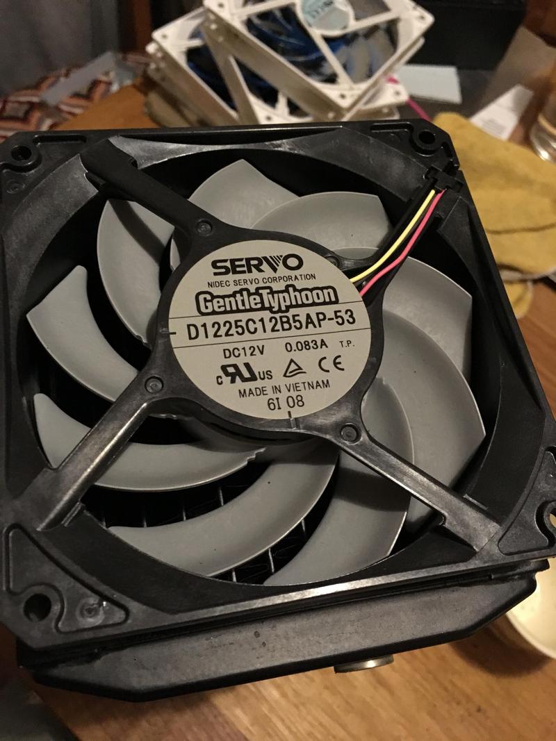

I was never a fan of the white fans. Some of you may recall I used them after the 800rpm e-loops didn’t move enough air and I ended up frying my pump. They were meant to be a cheap rival to Gentle Typhoons, but they were just cheap. And the white looked awful.
So here they are; actual Gentle Typhoon 1850rpm!
These are much quieter, don’t have an annoying “ticking” like the old fans would occasionally produce, and push a lot more air! :D
I did, however, have to modify the fans to allow me to attach a radiator to both sides - but these cuts will be hidden from the final build...

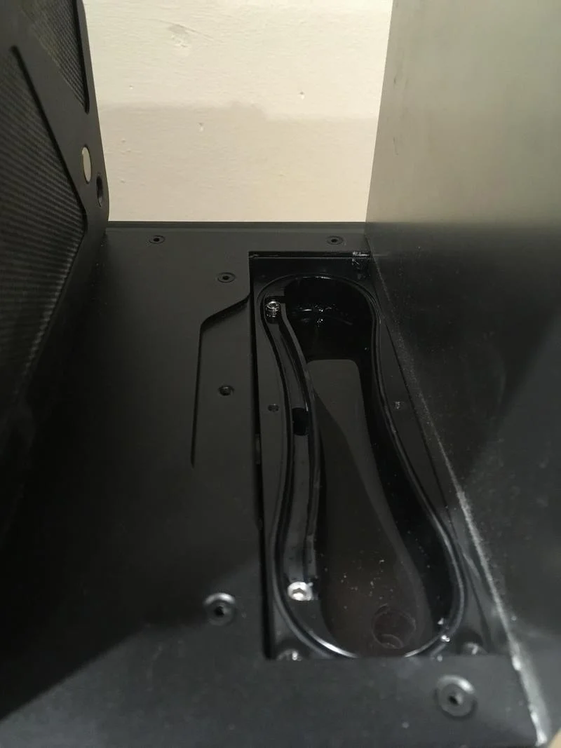

I’ll leave you with an image of how I fill and bleed the loop. Case on it’s side, front of the res taken off, topped up, put back and bled.
Repeat x12

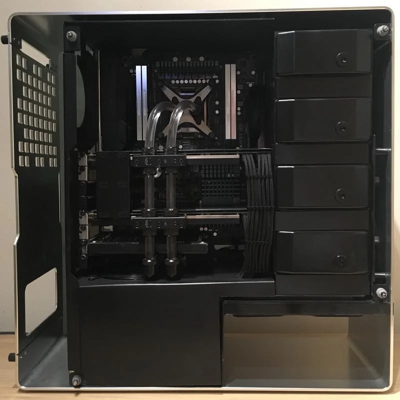

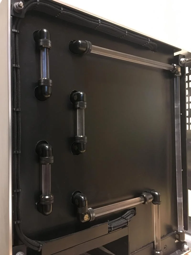

& Here it is! The PC is finally finished.
What I did:
  • Cut and bent sheet of aluminium covering the PSU and cable mess, as well as fully hiding the pump, fans & SSD power cables.

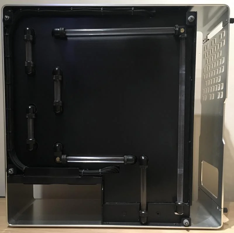

  • Cut to size a large sheet of aluminium to cover the whole back of the case so only a single cable is visible & drilled holes so that only the tubing can be seen.
  • Cut and bent 4 strips of aluminium to cover the fans up on the radiators.
  • Sprayed the blanking covers, plugs, SLi bridge in satin black.
Enjoy.
