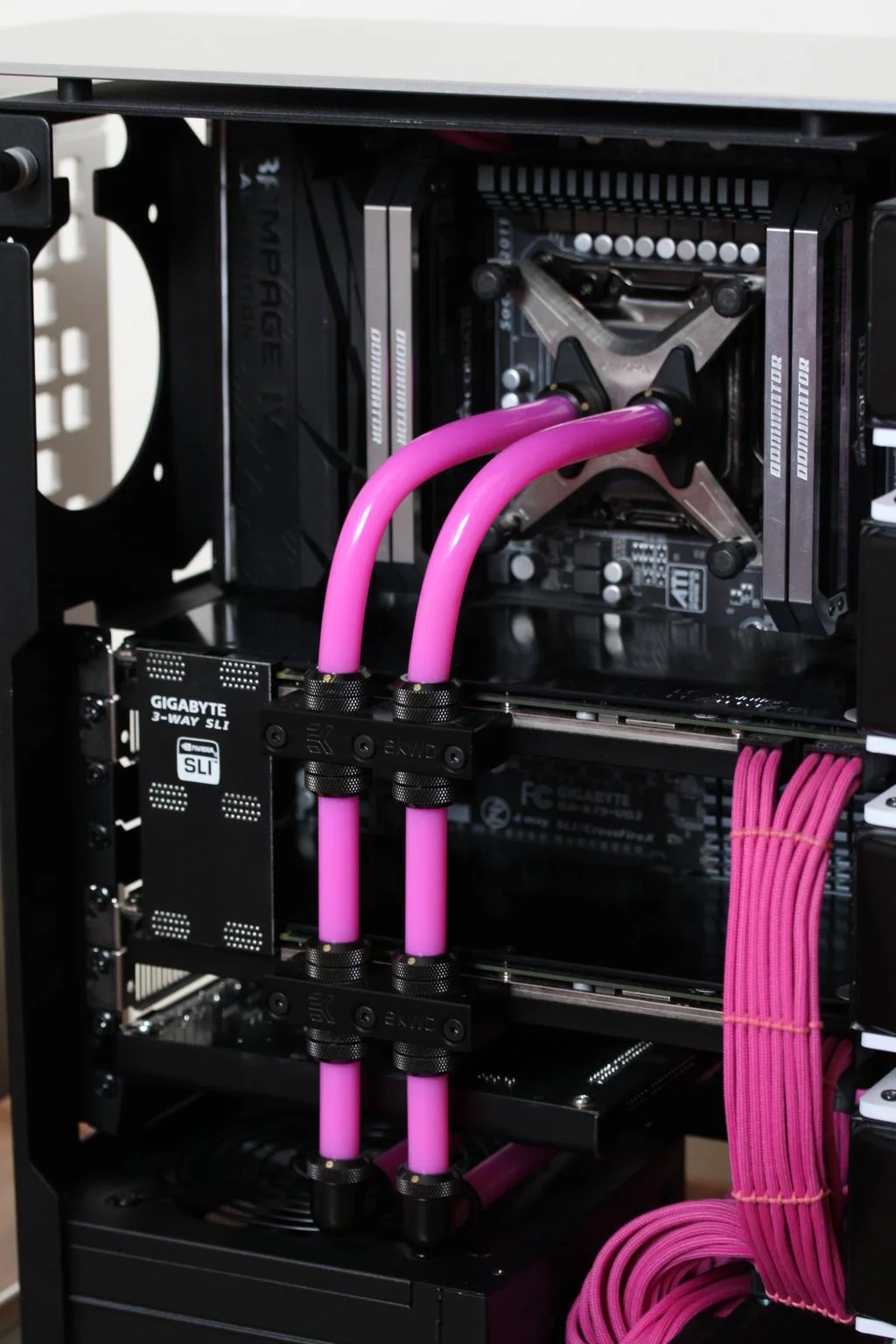

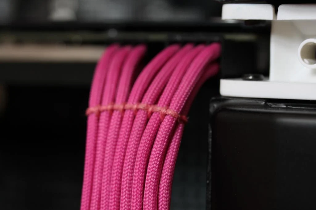

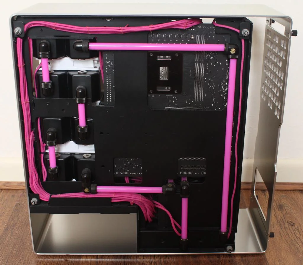

Yeah, I know what you mean. The lights on my Ducky Shine III are completely different too. I also kinda wish I had used black parachord for the cables too so to just highlight the tubing and nothing else. Not gonna change it any time soon though lol.:p
Easier to change the coolant than the paracord :P Enjoy the build now that it's finally done and revisit it when the inevitable itch kicks in.
Personally all I'd do is bash some more red into the coolant to see if that helps - your paracord is identical to 50/50 mix strawberry Crusha mix, should be able to get close to that with some more red dye.
And yeah, how well does the rad stack work out? I reckon it's on par with a single 360.

It's so difficult to colour match when buying without seeing items in the flesh. I think you can get close by obtaining small samples helps, but it's not a given. Different manufactures with different shades. I don't think it's possible to be so precise and really it's not something most eyes will pick up on.

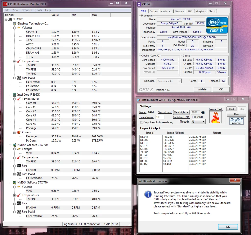

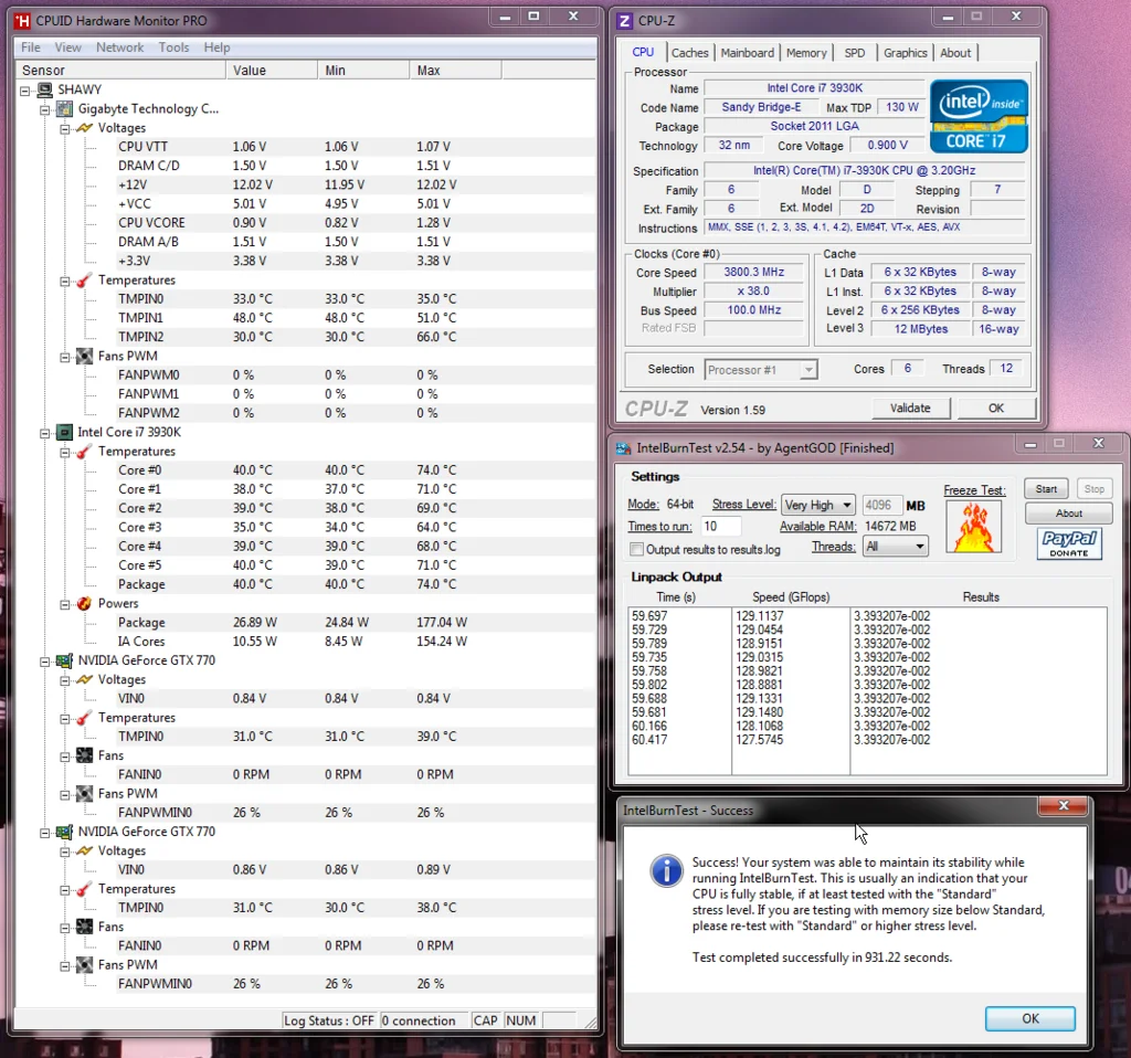

Slight hiccough with the testing. But here's some temp results gathered so far for an i7 3930k (6cores/12threads) and 2 GTX 770s SLi:
Stock settings under Prime 95 for 30 minutes:
  • idle 38-42°
  • load 68-81°C
Overclocked to 4.5GHz under Prime 95 for 30 minutes:
  • idle 49-52°
  • load 78-91°
Overclocked to 4.5GHz under Unigine Heaven for 30 minutes:
  • CPU 68-72°
  • GPUs 51-52°
Overclocked, the CPU get's quite toasty. But stays under the throttling temperature (95°C), albeit by a couple degrees. Running at stock speeds (3.4 turbo) only saves 10°C at both idle and load.

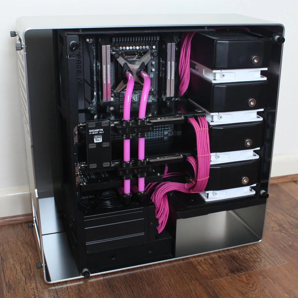

It's been quite some time since the teaser images and the failing of my fans & pump. Truth be told, I repaired the PC months ago and it's been
working just fine ever since - I've just been too busy/lazy to update this build log. But better late than never eh?
There's a couple things I'm not 100% happy about - the fans mainly. They do the job just fine, I'm just not a fan of the white frames and
should have gone with some higher RPM eLoops, but I'm not gonna strip it all down and spend money again when I don't have to. I might end up
covering up the fan frames eventually with some black vinyl or something, but for now it'll do.

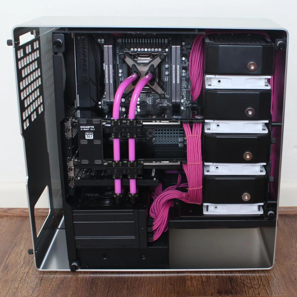

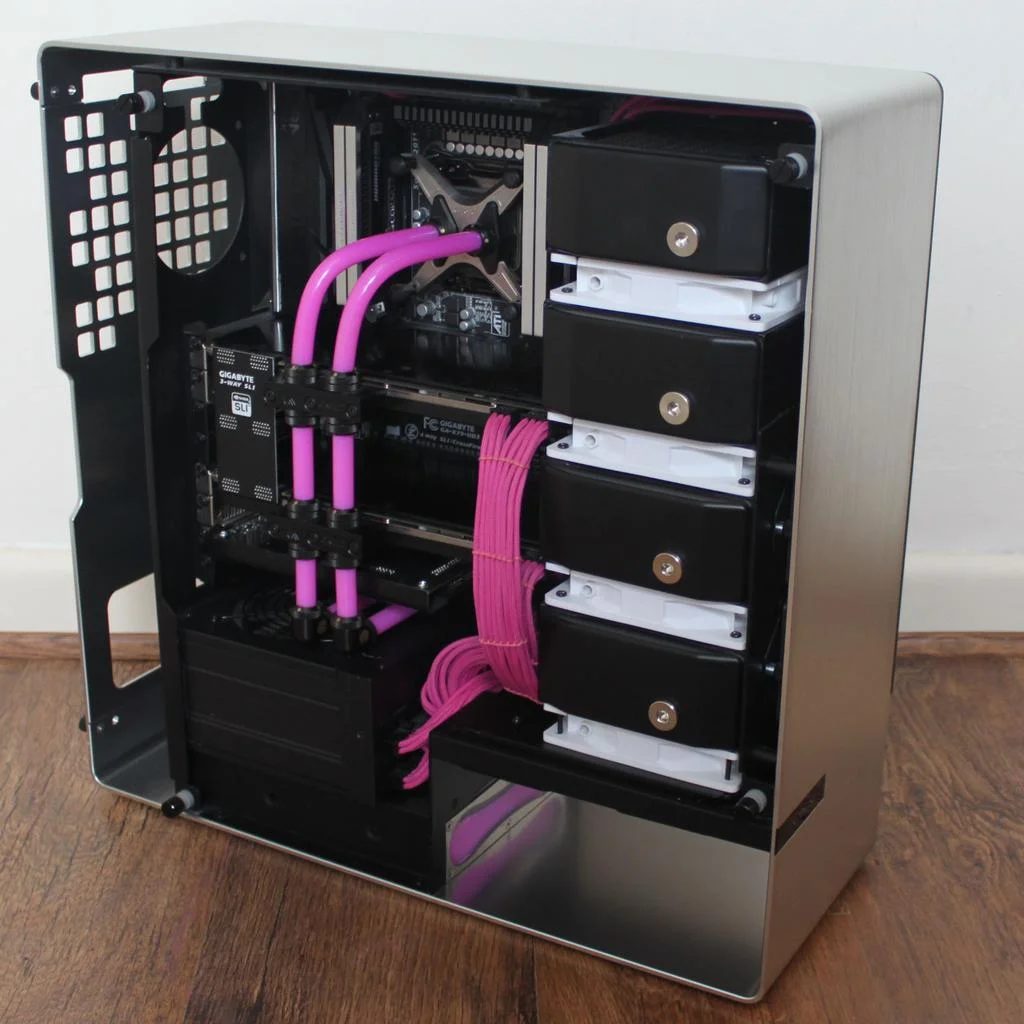

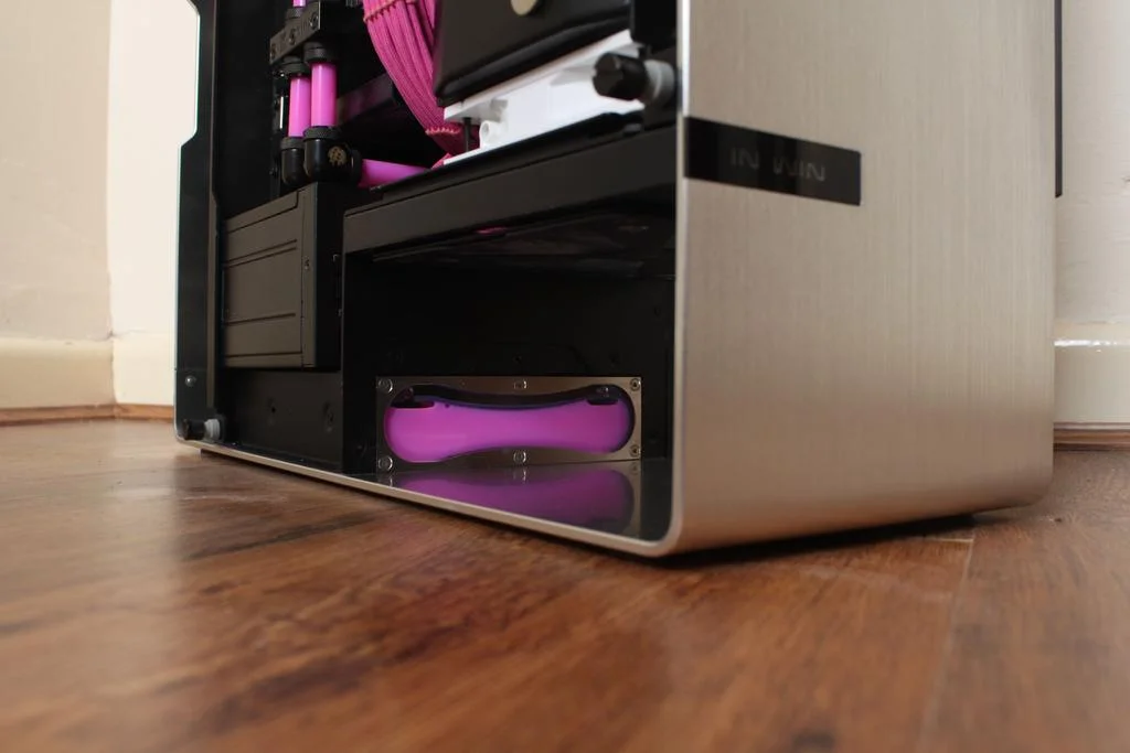

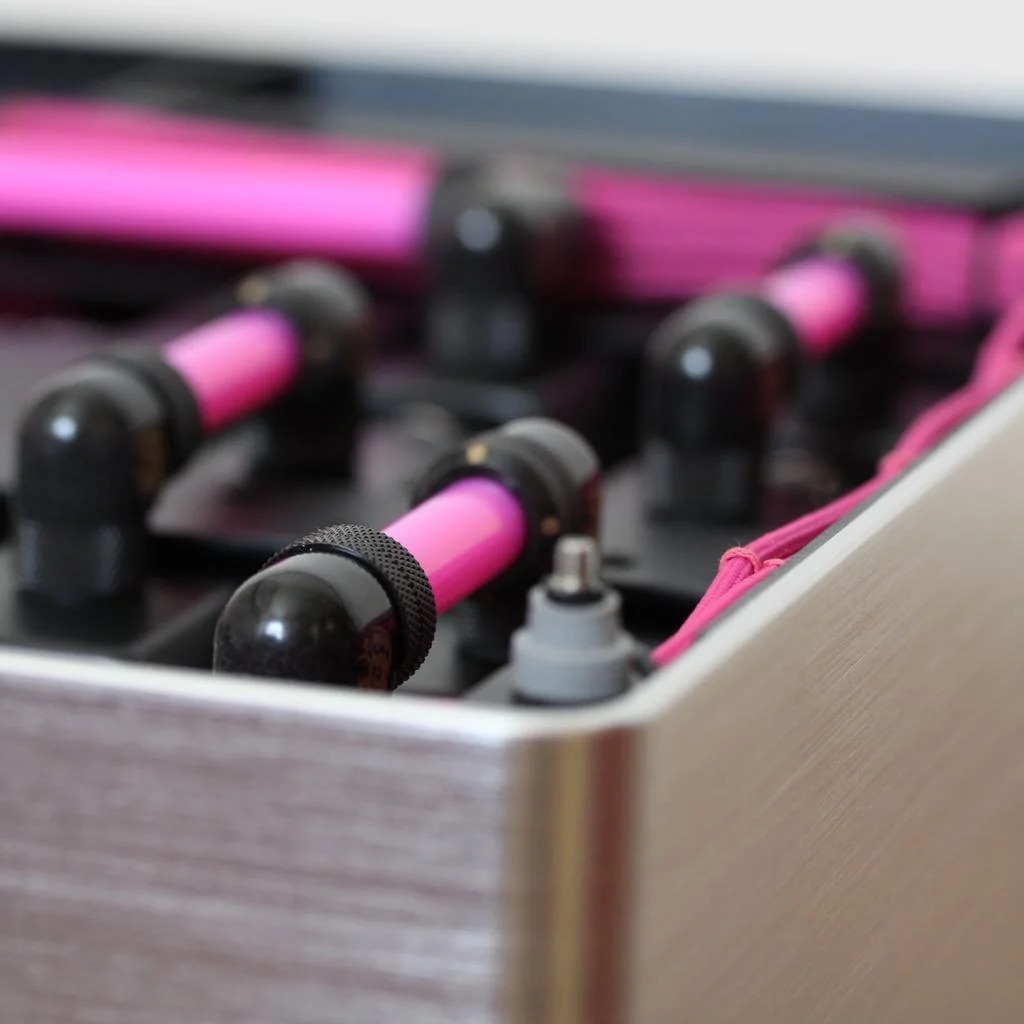

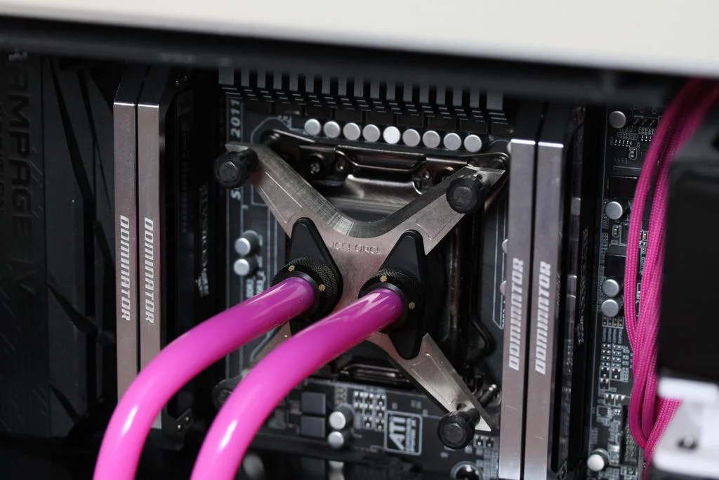

So, anyway, here it is. Enjoy.
There you go. Hope you guys like it.

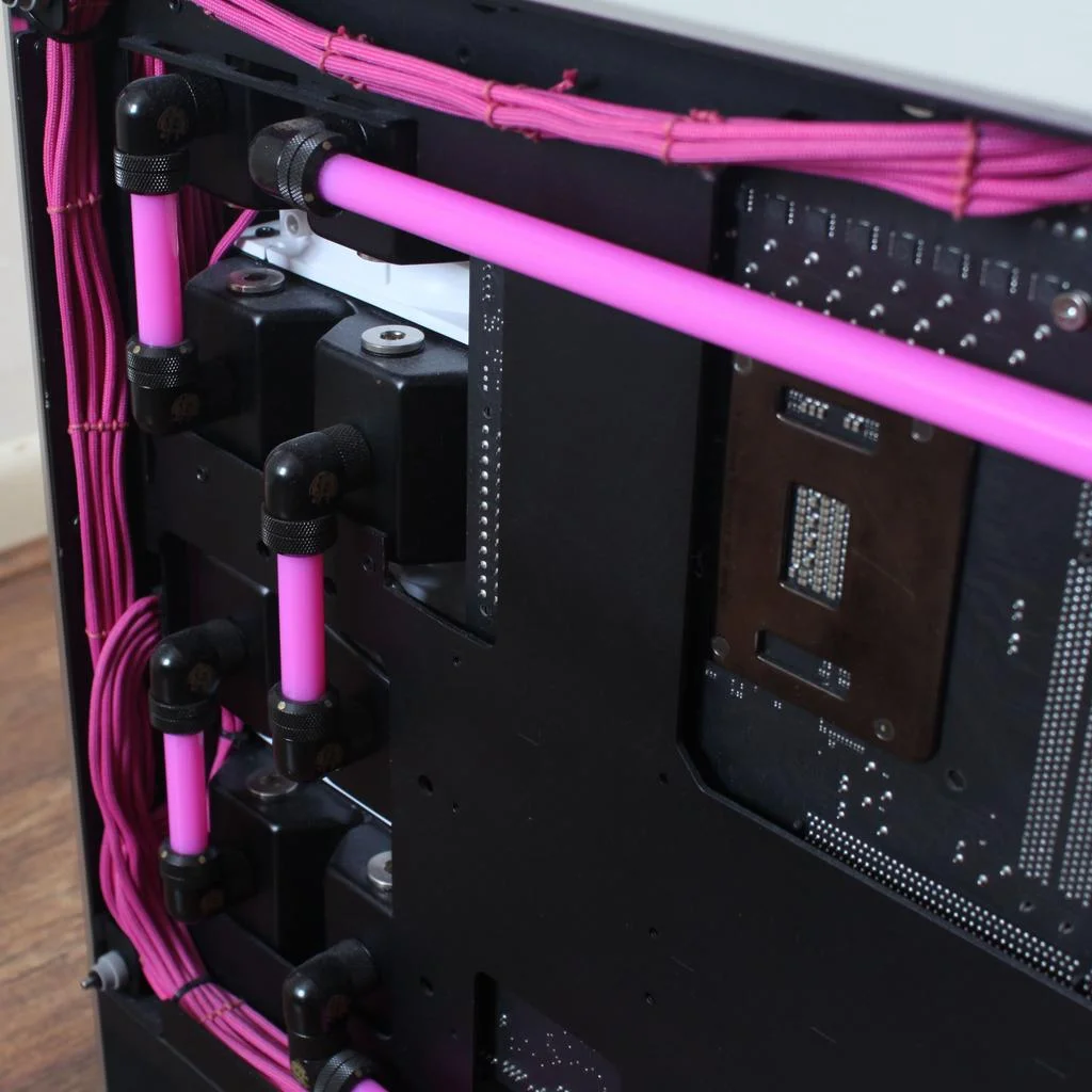

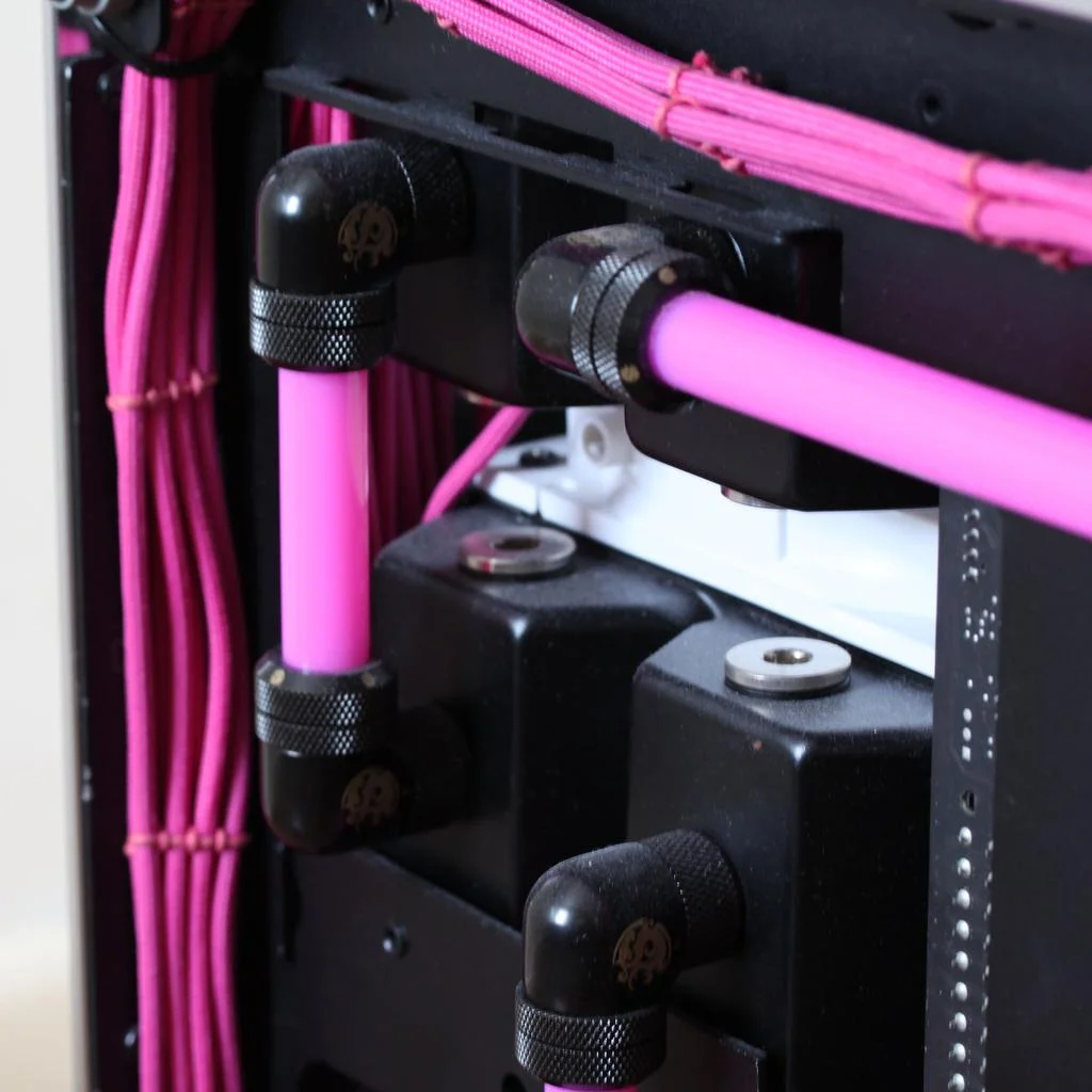

When I started this log there was a lot of discusion about whether or not the stacked rads would work, especially with the parallel loop, and
it turns out it does work. Admitidly, it didn't work with 800RPM eLoops in there because they just didn't move any air. But with some 1500RPM
'GTish' fans, it's been working flawlessly (other than a slight memory overclocking fault that's now been fixed).
Temps may not appeal to everyone, but they are well within Intel's spec, and the system won't be run anywhere near full load for prolonged
periods of time anyway.
Stock:
Overclocked:
(CPU @ 4.5GHz 1.35V, RAM @ 2000MHz 9-10-10-24 T1 @ 1.7V)

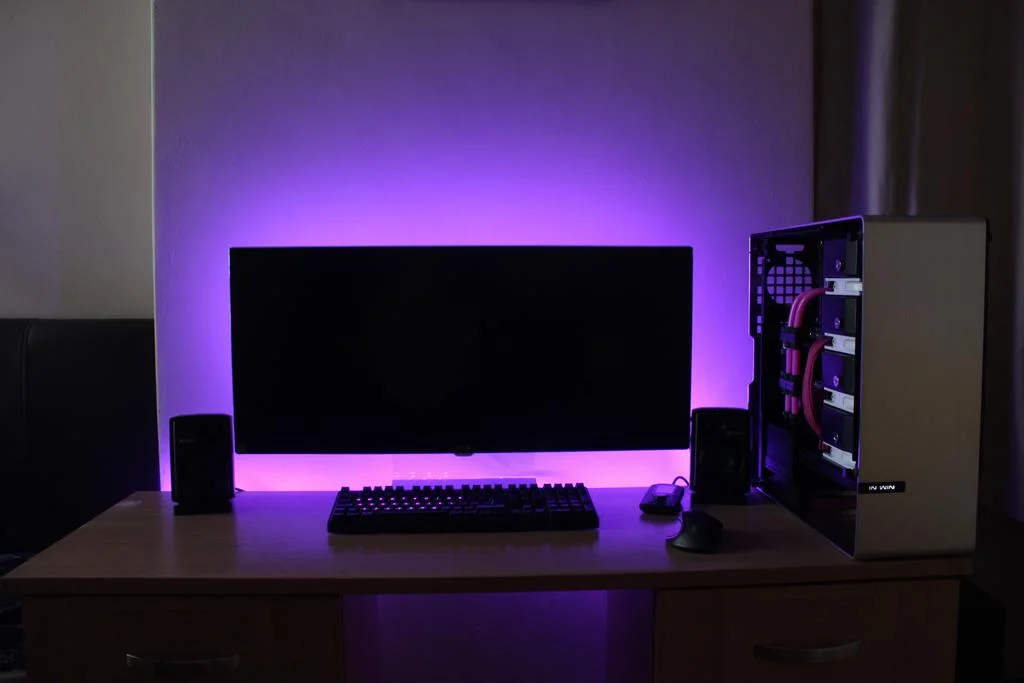

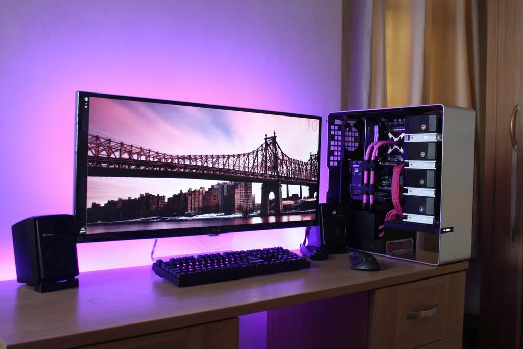

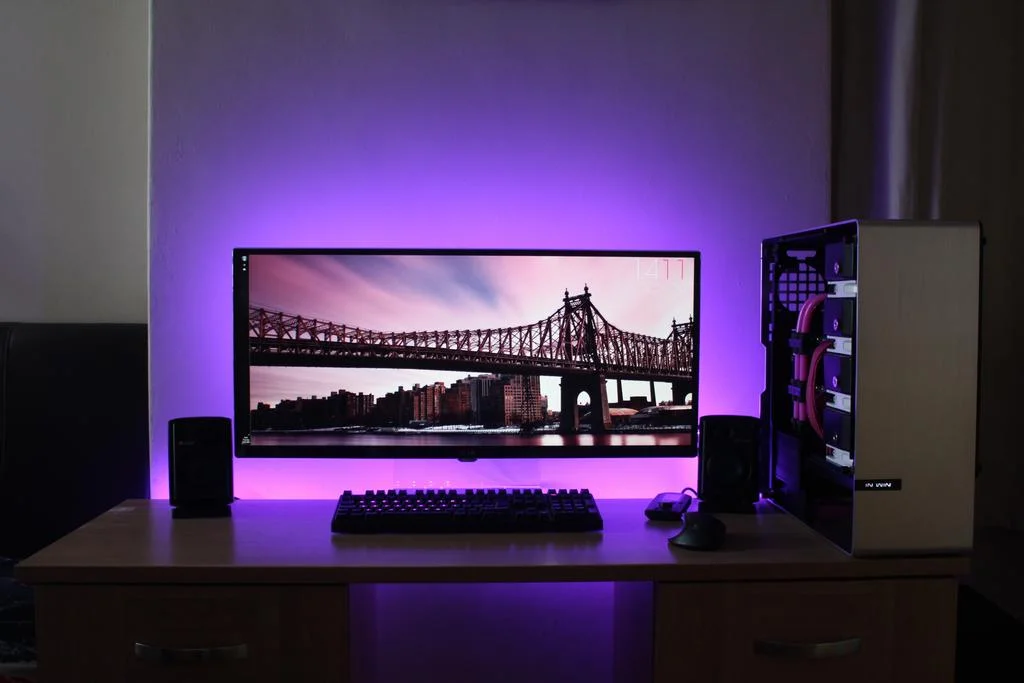

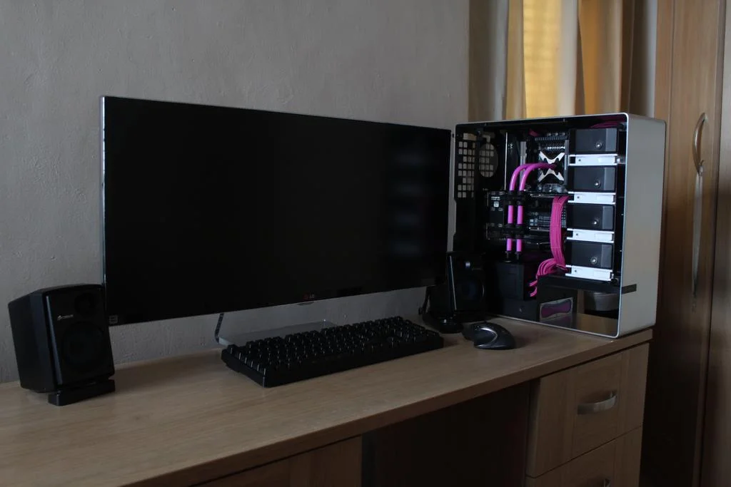

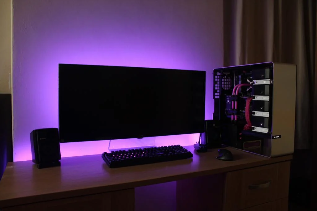

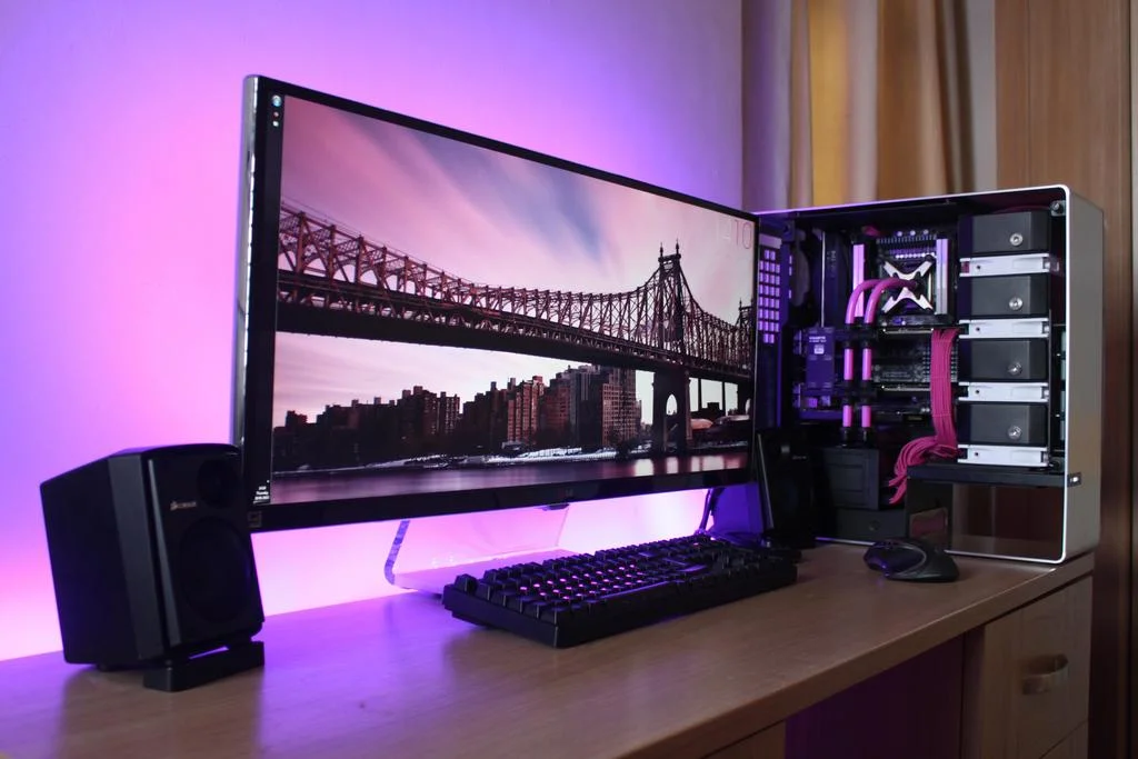

And here's the whole set up for anyone interested:
LG 34" ultrawide
Ducky Shine III - Cherry MX blue
Logitech Performance MX
Corsair SP2500
Generic RGB LED strip

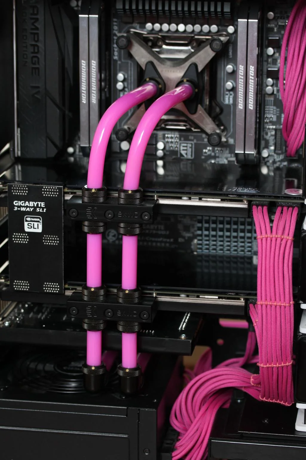

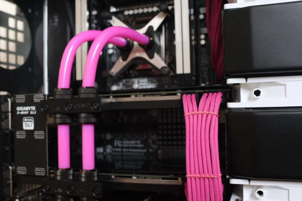

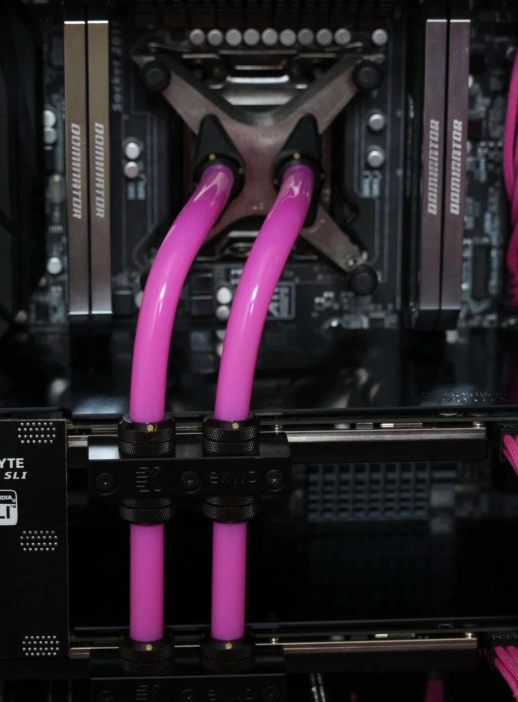

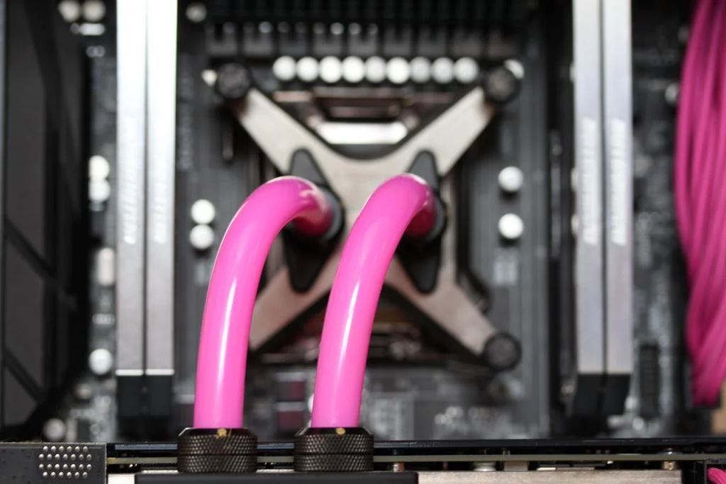

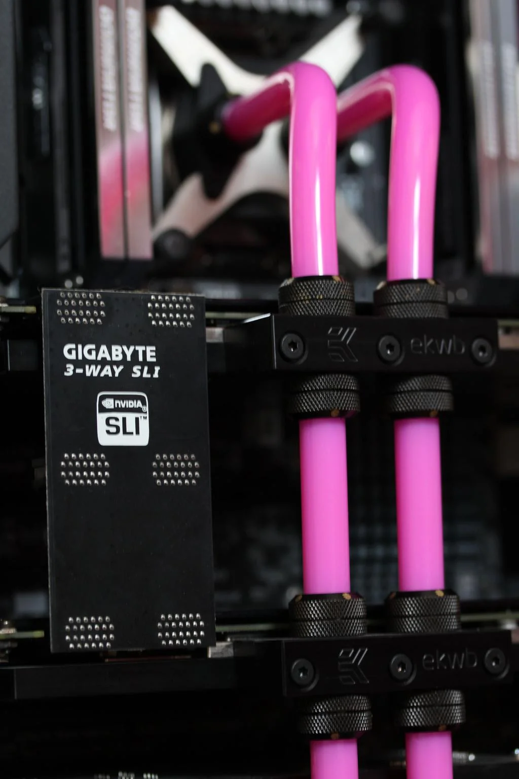

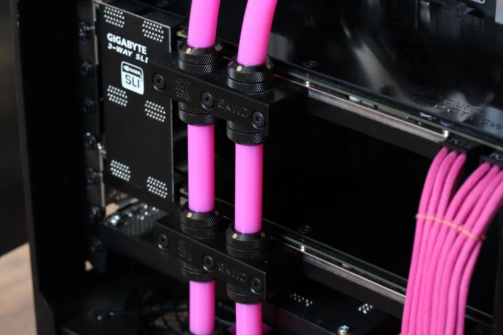

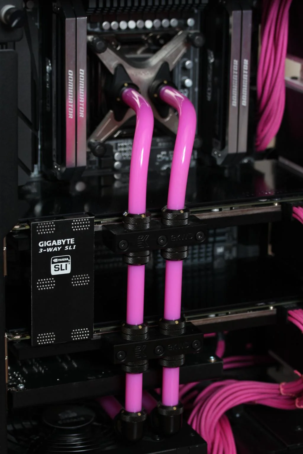

Looks nice but that SLI bridge looks honking.
Why not make a pink cover out of acrylic? at least something, it looks awful in there.
Yeah, I'm not a fan of it either. I do have a plain black ribbon SLi bridge somewhere, I need to dig it out and swap it over.

Can I ask what tools you used to take out your 24 pin PSU cable connectors and other tools for that matter and where do you get the covering your using?
I used to braid all my wires and loved it but often a 24 pin connector would break, but I gave in for 5 years and would like to do my Corsair AX860 wiring.
