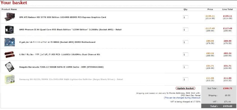

OK, final spec time:eek:
AMD X2 550 CPU - http://www.overclockers.co.uk/showproduct.php?prodid=CP-265-AM
Gigabyte GA-880GA-UD3H AMD 880G MOBO - http://www.overclockers.co.uk/showproduct.php?prodid=MB-280-GI
G.Skill RipJaw 4GB DDR3 RAM - http://www.overclockers.co.uk/showproduct.php?prodid=MY-047-GS
Cooler Master Hyper 212 Plus - http://www.overclockers.co.uk/showproduct.php?prodid=HS-029-CM&tool=3
All together £276.45
I also plan to hopefully unlock the X2 to quad core and overclock to around 3.80-4.0GHz

Look what i just ordered :D
The build will take place on monday. Photos will be taken :D
