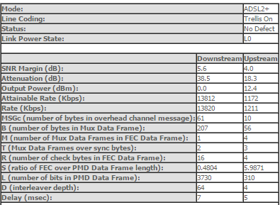

My stats are apparently very good for my distance from the exchange.
