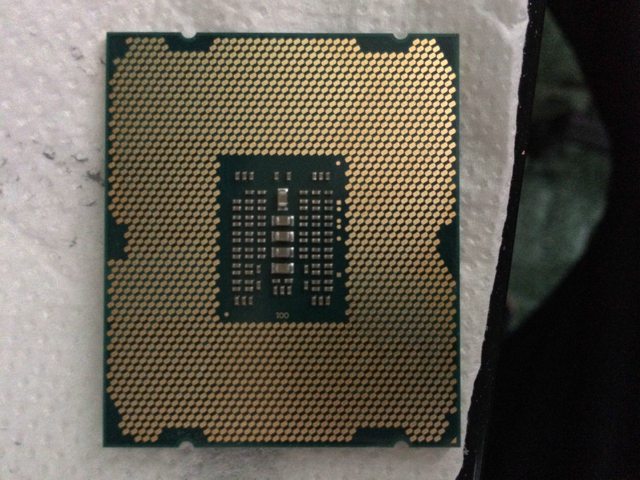

sounds like a short to me from your vid
firstly check your headers, power SW, reset, etc that there the right way
try cables in stages
1. ONLY 24 pin + 8 pin(nothing else whatsoever), just see if it fires up turn off asap as pump not connected.
2. above + pump
3. above + next component etc etc
if it does it on the first test remove your mobo and check for any foreign materials and then test with mobo out of case again just 24 pin and 8 pin and again shut down asap as there will be no cooling.
2. above + pump
