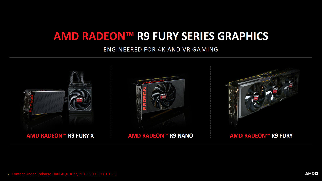

HBM allows this sweet
Zotac did a bunch of Pascal mini cards with ~6inch PCBs (around 8inch including the cooling) without HBM in sight (with a single fan design they'd have probably been 6 inch cards).
You mean 970 mini which is a fair bit slower in performance...
I want short like Nano cards because there is no space in the cases.
https://www.zotac.com/se/product/graphics_card/zotac-geforce-gtx-1080-ti-mini#spec
Short cards in the long run are really a gimmick, look at the fury cards that had elongated heatsinks on a small pcb to cool the card. Furyx also wasn't really shorter if you take into consideration the aio on it.
The Nano is still shorter - it is 6", while that^^ is 8.31".
Still a mini card but 8inch PCB on that one - some of the other Pascal cards had smaller PCB - but yeah proves the HBM advantage isn't all that massive over plain old GDDR in that regard.
