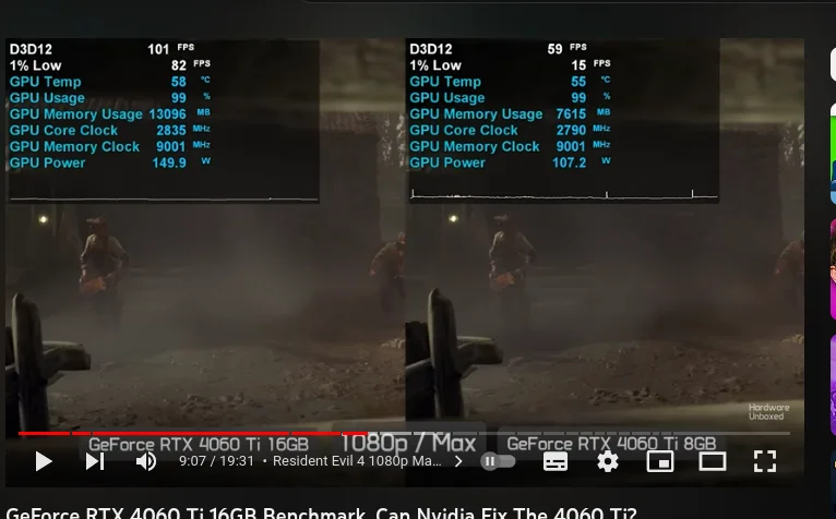

I dislike HUB behaviour at the moment but they do make good content from time to time, it should also be said that HUB were the ones who drew attention to the problem of not enough VRam, and they continue to do that. Credit where credit is due.
Most recently they compared the 8GB 4060Ti to the 16B one, so the only difference here is the VRam, and its not looking good for the 8GB is enough apologists.
101 vs 59 FPS in this screenshot, its not just the worst case in an image, watch the video, its quite eye opening.

Yeah, i know.... :) HUB have been banging on about this for a while, and all credit to them, but for the first time i think they have actually shown its effects in action, they didn't need to wait for the same GPU with different levels of VRam to prove it, tho i do understand why they did.
