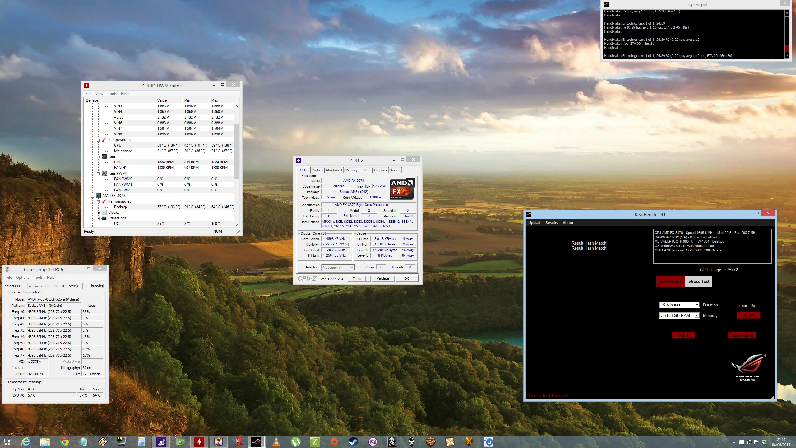

Seems like it goes over by 0.02. With Turbo off, it's 1.4V in bios, 1.42 under load. Offset by -0.02 so it's 1.38 in bios and it's 1.4 under load. Not sure why it thinks 1.4V is default, when it's suppose to 1.38 though. It's the same even If I use a fixed 1.38V instead of offset.
Anyway LLC. LLC is set to Auto. It has 5 settings.

Try high llc and see if you can hold your desired voltage. Just a question what cooler do you have?
What are you using to load up the cores for testing stability?
And what are your package and cpu temps?

Asus Realbench
Package was max 55C, I forgot to write down what the socket was. I know it was not near max temp. I'll make sure to note both down next time so I don't forget.

I also have the board and revision but don't have your problem, running an 8370. It def has its "quirks" though (probably why Rev 2 came out!). I seem to fail anything that goes over FSB 210. tried jumping it to see if its just a bit of a black spot and all sorts but to no avail.
I'm going to reseat my cooler soon I think as although its an older cooler there shouldnt be a 10C temp difference between yours and mine especially when I'm running at 1.35/1.37 and you are much cooler! you don't have a silly (10 fans etc) case at all do you?
That's a great voltage to get such high Mhz. Means temps should be low and be comfortable for 24/7 use.
Low under normal circumstances but not really under stress test. just on the edge. I'm going to reset my cooler I think as armadillo is using 0.05v more and getting 10C less!
my 4.7ghz @ 1.368 under load run.
Just a cm690ii. I only have 4 fans. Front back and two in the top.
