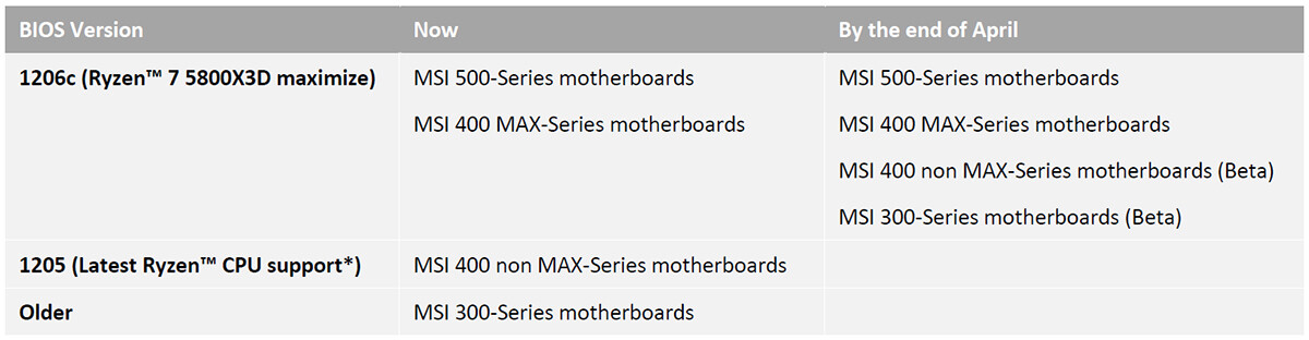

All MSI 500, 400 and 300 series motherboards will support the latest Ryzen 5000 & 4000 processors with AMD AGESA COMBO PI V2 1.2.0.6c BIOS.
https://www.msi.com/news/detail/MSI...st-Ryzen--5000---4000-Series-Processors139843
