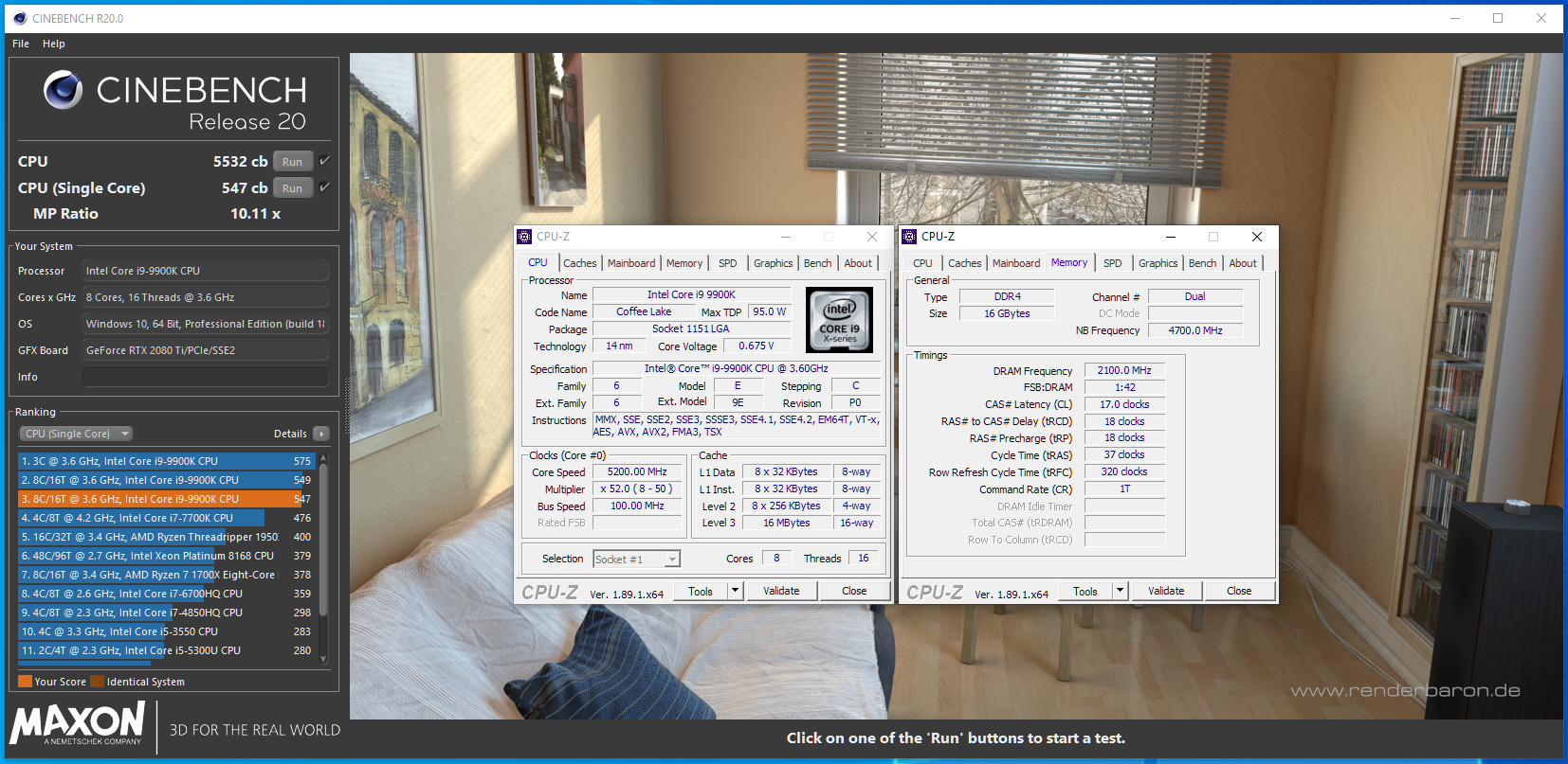

Anybody reading that would indeed think that all 8 core CoffeeLakes use 300 Watts and seeing mine is the only 5.3Ghz 8 CoffeeLake in the conversation let's see how much I actually use.
Here is my HWInfo64 during AIDA64 Stability Stress Test:
As you can see in the CPU Package Power my 5.3Ghz 8 Core CoffeeLake uses ~135 Watts at full load.

For 5hgz all core my 9900k pulls 143w in r20 and temps are mid 60’s. That’s a 10 run average and matches an oc’d 3700/3800x oc’d to a 4.4+ all core.

You're right. It's not 143, it's 140w at peak. Sorry that you had a bad chip. I can't help that.
Here's the run. I can't be bothered to lower voltage below 1.18v (load = 1.13v). I don't do AVX offsets. If anything, they cause transient spikes which leads to instability.
But it is not 300W as Humbug alluded to! It is 134W. That is the only point here! You just can't go around making up crap and passing it off as fact.
