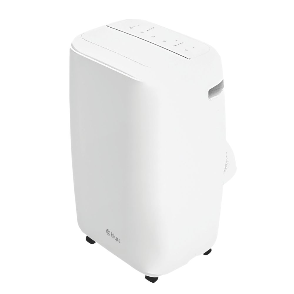

I've got the £300 one from Screwfix, it's alright and does the job but it's bloody loud. I struggle to sleep with it one however I normally tend to use it to cool the room down before I go to bed and it does make a big difference. I then put it back on around 4am when I go and let the puppy out and turn it off when I go back to bed.

So after 1 day of using it, hanging it slightly of a casement style window (opens 45° angle from top to bottom). I can honestly say that it is amazing and I wish I bought one sooner! - Yes, it is noisy but it's a constant noise of the same thing, which i'm very used to and is fine for me.
I'm even thinking of buying a second one for my bedroom, however I think buying 2 units for one spout of hot weather might be overkill... I didn't buy one last year, but did this year. Maybe next year i'll get a second higher-end one and put my existing one into the bedroom.
Conclusion: If you have £300-400 spare, then definitely buy one. However, I am working from home, which means it is the hottest usually around 11-4pm near me. Therefore, you might not get as much benefit if you aren't working from home.

So after a week with two new 12000 BTU Units (Goodhome Takoma from Screwfix and Rhino AC12000 from FFX) for ~£300 each, my thoughts, the idea was to try a couple of models and keep the one we liked the most in our bedroom and give the other to my son (My daughter already has our old 12000 BTU Unit that is going well after 18 years)
A. The Goodhome is excessively large, it's still OK, but it's needlessly larger than it needs to be. The Rhino is much smaller yet performs the same and is a bit quieter in terms of fan noise.
B. Both units compressors seem to be as noisy as each other, both can have a slight warble compared to our old 12000 BTU Unit, I suspect it's due to the way the compressor is driven as they are now all A rated.
C. The Goodhome has all the controls on the flat top surface, so not visible from the bed, the Rhino's controls/display are on the front so visible when laying in bed.
D. The Rhino has mechanised vent louvres that close when switched off and can be adjusted from the remote, or can be set to 'swing', it seems the perfect height to project cool air across the bed if you so desire!
E. The goodhome is a 4 in 1 so can heat as well, but doubt I'd ever use that feature.
The Rhino is about 3/4 the depth of the Goodhome, and just looks a lot slimmer:
vs
If I bought another one, I'd get the Rhino, overall it's smaller footprint, front controls and slightly quieter fan with seemingly identical performance would edge it, but if all I had was the Goodhome, I'd not be complaining!
We just have the tube sticking out of a normal side opening window and the curtains do a good enough job of creating a barrier to stop too much hot air coming back in, this is enough to get the room down to 19 degrees (about 1 degree every 5 mins in our bedroom) when it's 29 degrees outside.
