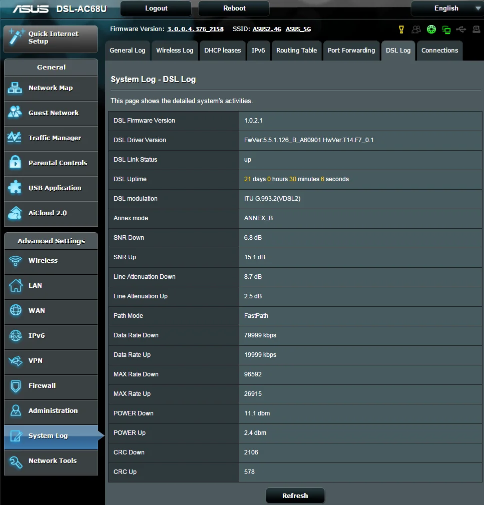

well posting my latest info`s 21 days uptime, no issues max 80/20 dsl sync speed
no issues...
I question to all arising from ViRuS2k's stats:
I'm confused that ViRuS2k's power values are so high (or mine so low) when compared to the Line Attenuation. Wondering if this could be a cause of ViRuS2k being so stable and my not being?
If this is a sensible thought, what power is anyone else (who's attenuation is roughly 7down/2up) running at?
ViRuS2k:
Line Attenuation Down 8.7 dB
Line Attenuation Up 2.5 dB
POWER Down 11.1 dbm
POWER Up 2.4 dbm
Me:
Line Attenuation Down 6.0 dB
Line Attenuation Up 1.8 dB
POWER Down -3.8 dbm
POWER Up -3.6 dbm
[Note I'm on a DSL-N66U, which is related, but not the same, and clearly on different f/w. So there may be too many other differences to draw any conclusions.]
I would love ViRuS2k's to post his settings cause to be up that long/stable is pretty darn good :)
It might encourage me to finally start using mine again (gave up a few firmware's ago)
I've also been wondering if the attenuation and power is linked more to those with stability, some instability, or a lot of instability. When I next plug it in I might try changing my kl0 to see what effect it has on fastpath. There's a possibility it will only effect the upstream though.
I'd certainly imagine that if the cabinet was transmitting to me with 13mW (11.1 dbm) rather than 0.42mW (-3.8 dbm) that my connection would be more resistant to interruption from noise!

For those wanting a line as good as ViRuS2k you have 2 chances of that, slim and sweet (bleep ;) ) all.
His line it is obvious is a quirk when it comes to phone lines in this country, his last mile of copper (thats a terminology not a literal he has a mile) cable from cabinet to house obviously for reasons unknown is NOT susceptible to outside interference. Id gather it is short also (id guess he is probably within eyesight of the cabinet probably 100M or less).
His line is also likely to have a high power rating (i bet voice down his phone is amazingly clear for analog and loud). He also probably only has a few people on VDSL at his cabinet.
I would not be shocked if he lives in a non-built up area or a street that is quite short (like 50-100 houses tops) Not necessarily rural but a location without a load of outside EMI and more than likely a newish (less that 30 years old) home. Probably a culdesac or housing development not built too long ago with nice fresh cabinets and wire.
Tweaking any device is not going to get you results like his, you can basically consider him either very lucky or a technological abnormality.

All nice points. However there is one I don't understand:
Could you explain what you mean by his line having a "high power rating"?
I accept he may have an exceptionally short and quiet line. (Though I have less reported attenuation on my short, not necessarily quiet, line).
The thing I don't understand is why, given his line is so good, both up and down power would be so high (relative to mine).
It couldn't be that the system knows there is no one for him to interfere with, and thus cranks up his power?
Phone lines have a small amount of voltage which runs along them, the amount varies depending on line. Some modems in their stats will report the voltage on the line (as an example when i was ADSL with a Netgear DG834GT with DGTeam firmware that did). The higher the voltage generally the more stable a line is. Not always the case, you can have too much but thats easy for an engineer to fix. A neighbour in my street (3 doors away) on ADSL could get almost 3Mb more than i ever could even trying various routers and it was all down to their line having something stupid like half a volt more power.

It would have even had to be tested in its final design, Mediatek would highly unlikely allow them a license to use their chips in a chipset which did not meet their approval either.
Hardware nowadays for a worldwide market is subject to more testing than you can imagine.
The very fact the device becomes more stable for many just by disabling the spectrum monitor/stats pages in the SOFTWARE, even shows that there are software issues with the device. To blame the hardware with no evidence is a bit silly. The fact with some software releases its made the device either more or less stable for some people also points back to SOFTWARE.
Yup, know all of that, however we are talking about a cheap Sky SR102-c Sagen modem that is given away by Sky can do the job better, and with different phone lines, than a £180 Asus product, it's not good is it?
Which does not show anything, there have been users with problems with skys router (see their independent forum) which have gone away with another device. Also although you can argue it may or may not be more stable than the Asus still does not explain why for some that switch to say a Openreach Huawei modem instead of the Sky 102 find the Huawei more stable. The chipset is basically the same in both devices, one over the other should not perform significantly better. Yet they do.
Its no different (apart from how reliable you deem it to be) with the Asus situation. No doubt out there their is some other Mediatek device (probably bundled gear in the far east for some fibre service) and that gives no issues.
Im not defending Asus, the software is a bug ridden mess, FEC stats are obviously reported wrong, having to disable part of its software (IE spectrum) to make it more stable is daft and thats just issues we know about. The problem if any is Asus have gone for a chipset and then basically ported the software from another device of a differing chipset (IE the non DSL AC68u) and just encoded the modem driver in with that software..... It should had been tested more before they released it.
It could be so bad that it would be easier to start from scratch, without all the code at present i could not say, either way within a week or so i will hopefully know when i get one of them and dump all the software via TTL. From there ill probably laugh, rip a load of redundant cack out and fix it. Though no doubt then people will want certain things which make it buggy put back in.... Sometimes as a software dev you cant win or ever please people, more features in software ALWAYS EQUALS more problems.
Yes some have had issues, as with any modem, however you cannot the ignore the fact that nine times out of ten the number of users of this cheap, and nasty 'thowaway' modem are finding it more stable in the majority, and doesn't require the excellent combined knowledge of people like yourself finding 'tweaks' to make it more line stable out of the box either. There are no excuses for asus's inability to produce a fix and given the size of the company, compared to sagem, it is blatantly obvious that they don't seem to care. Where are they here, do you seen any posts from a UK representative in any forum in the uk assuring us that they are aware there are issues and that they are working on them. Not even in any replies to my service query emails are they suggesting anything other than the standard tweaks. It is pathetic really...
