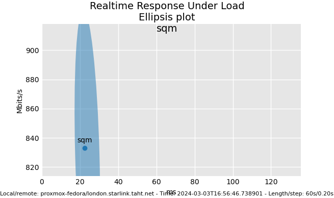

Here's an rrul test (Flent) on VM, which WaveForm currently says is awful (F grade) on the downstream. As you can see, the line's perfectly fine, especially for VM:

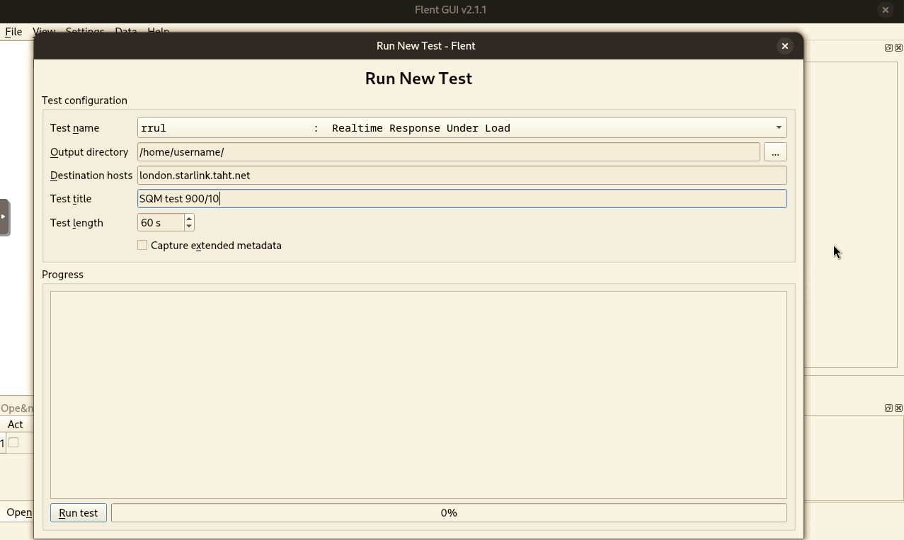

You can use it from CLI or the GUI. Download per the instructions in the link I provided earlier. Open the GUI then CTRL + R for a new test. Test name is RRUL. Output directory for the data file and any saved pics (eg /home/user/flent or C:\flent) but remember the directory should already exist. Set the destination host to Dave's server at london.starlink.taht.net. Test title whatever you like (eg sqm-900-100). Leave the rest as-is and click 'Run test'. After 70 seconds you'll have some pretty graphs and can scroll through them using the menu on the right. the 'all scaled (Download, upload, ping (scaled versions))' is the primary one. Run it when the network is quiet (i.e. no torrents, game downloads, etc) and if you need any more help just shout mate.

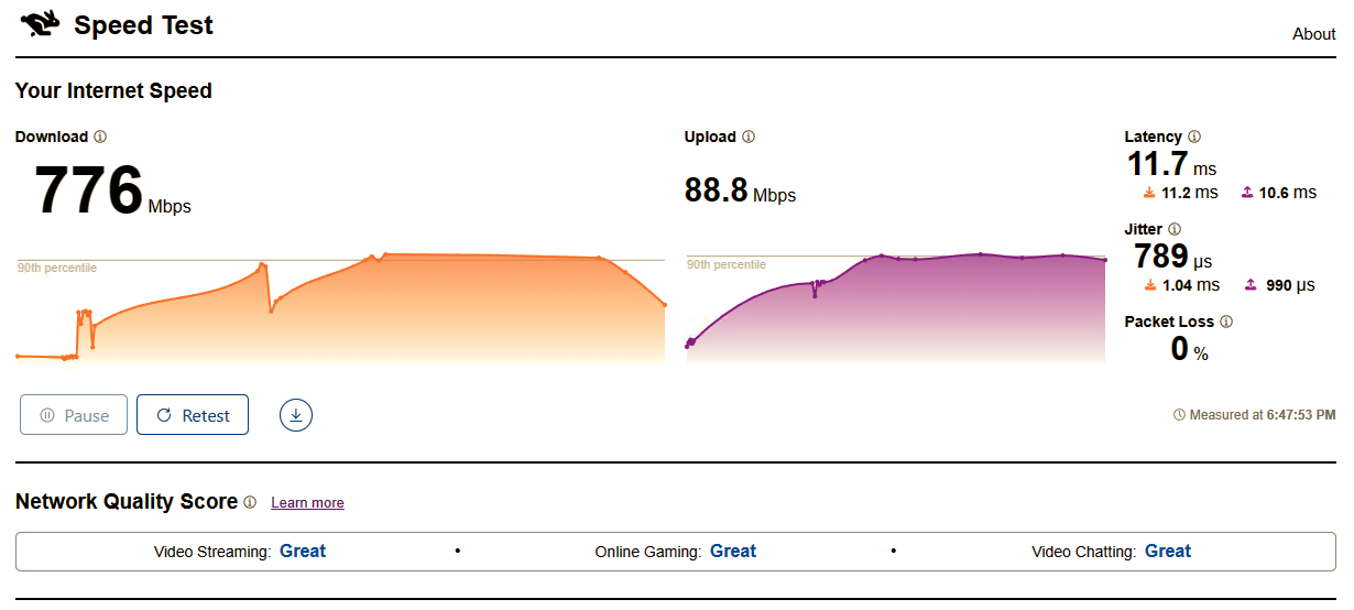

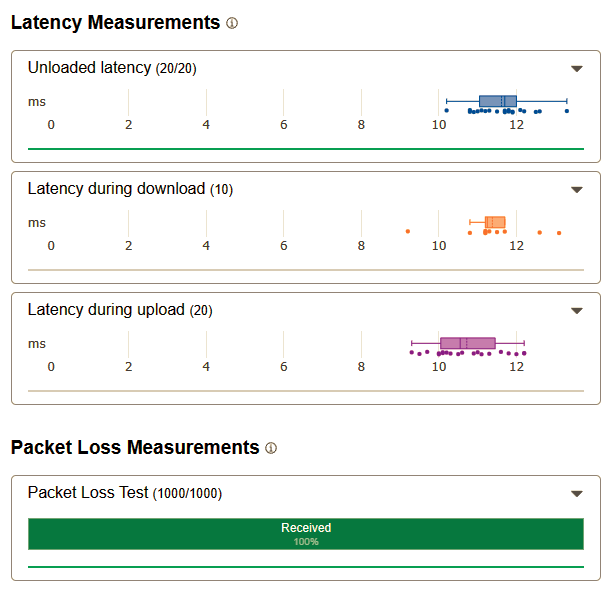

OK after some heavy testing, it definitely seems like either something's screwy with WaveForm atm, or the routing is busted to it on VM. However, rejoice! Cloudflare offer a very similar (much faster, more informative) test! It loads the connection, measures latency and jitter and all the other goodies, and then rates your line. Their 'great' is equivalent to A+ on the other site, good is A-B and anything below that, you don't want anyway. :cry: The page is long, and gives all the various speed results (small file sizes through to large file sizes, hence the 'steps' in the speed graph), all the latency info for up and down, etc.
Here's mine with OpenWrt and SQM/Cake. The downstream is restricted to favour latency, I could get much more speed but I prefer the lower ping:
...and switching to fq-codel instead for lulz:
Give it a go, and report back if you like. This test tallies with the rrul test and I'd trust this over the 'your SQM has no effect' results offered by WaveForm atm. BTW, my install is today (Monday) and I should be asleep... and yet here I am nerding out over latency, on a connection that I'm about to throw into the bin anyway lol. I'm just practising for Aquiss, honest.

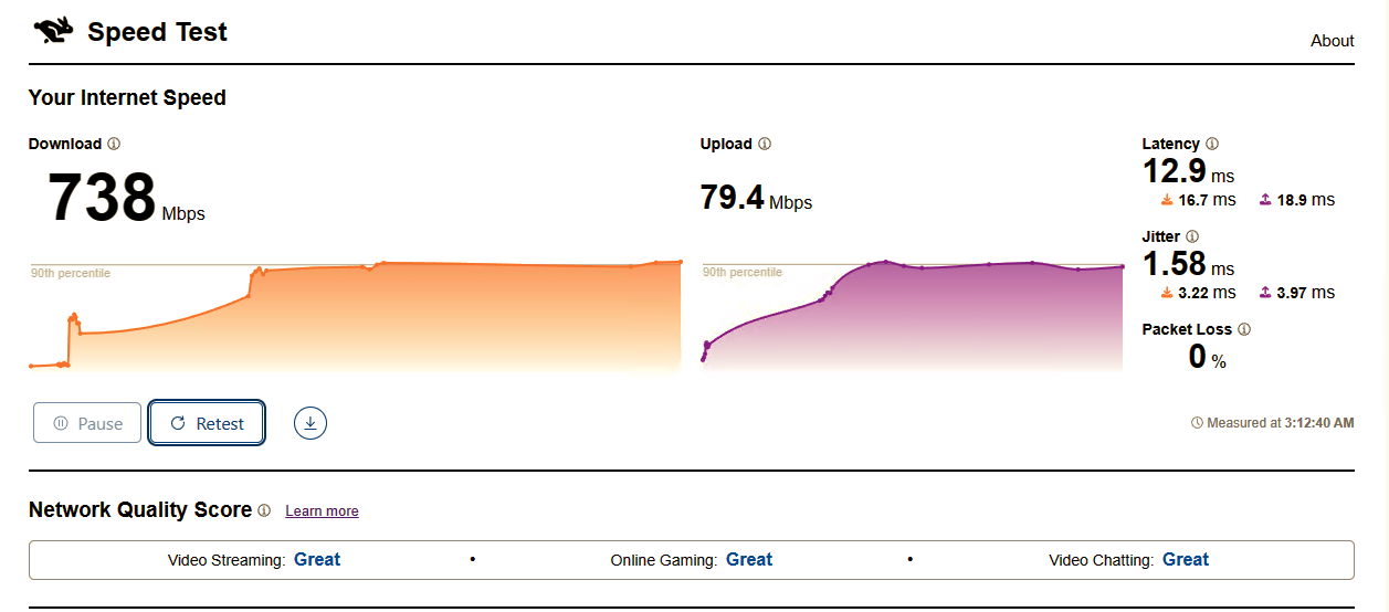

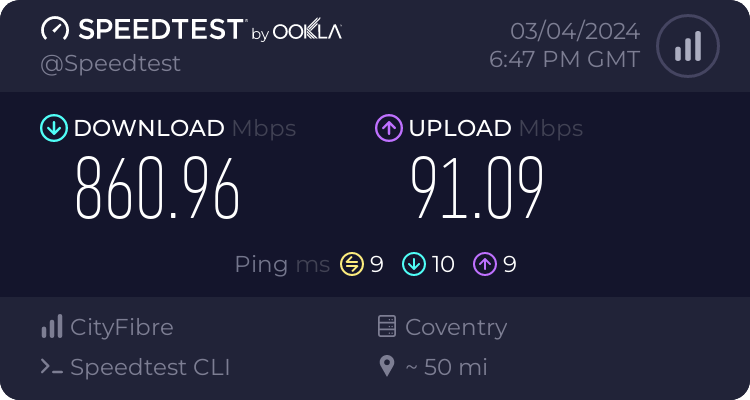

That test seems to have issues maximising the upload/download which might explain the lower latency. Speedtest result below doesn't have the same issue.

Aquiss with openwrt running SQM
Had set download to 925000 and upload 90500 for lowest latency
cloudfire test
