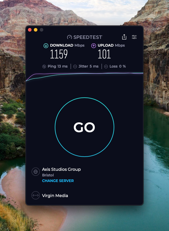

My point was that over the last 12 months Aquiss or their suppliers haven't been as good as VM in terms of maintenance, packet loss/total drops etc which is not what I expected (maybe I am lucky with VM in my area). Only latency has been better but that's down to the underlying technology rather than service.
VM get a lot of stick due CS/outsourcing/routing/email gate etc etc, however if you are in a decent area and have no requirement to speak to them, they're a solid ISP. I was happy with Aquiss and I only got VM as their TV package with broadband worked out cheaper than what Sky wanted for TV alone. I ran VM and Aquiss side by side for a few months, and after VM finally fixed the upload issue I was experiencing it's been perfectly fine. In fact, apart from looking at numbers on a terminal, I've noticed no difference at all. That's why I eventually cancelled Aquiss. I should mention again that I am on RFoG rather than HFC and I think most reported issues come from ageing coax.
When it comes to the renewal dance in December I'd happily sign up again for 18 months as I am a sports junkie provided they give me a decent offer.

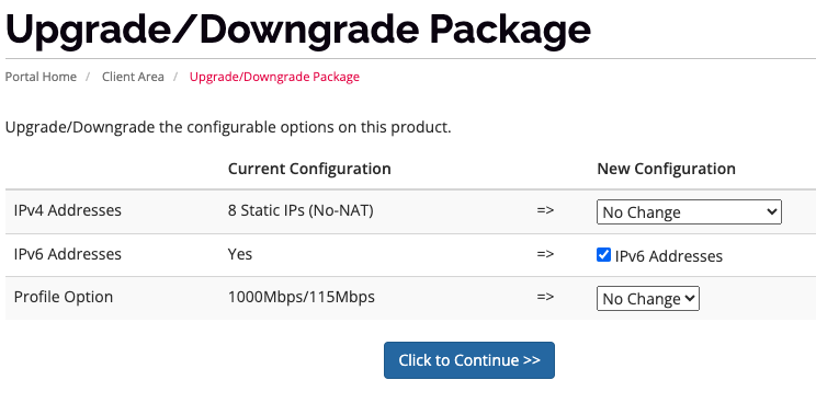

Anyone know if you can add the extra static IPs (/29) at any time during your contract or do you have to do it at the start?
Rather the opposite. You can't order from the outset, but once you're live you can go into your account (eBilling) and select it as an 'upgrade' for £5 a month. IPv6 is a free upgrade option.

Ah, good to know, thanks! Do you know if you can upgrade/downgrade it whenever you want or is it fixed for the rest of your contract once you upgrade it?
I have the option to remove the /29 and get a refund for unused time, so I imagine you can. I've only just activated it though, so I can't say how permanent. Again, Aquiss are the ones who can answer this definitively but that's what I know. :)
Thanks again, I'll send them a message in the morning just to check that's applicable to everyone but based on what you said it sounds good. Need to put an order in tomorrow before I go away so at least I know I don't need to sort the IPv4 situation before ordering
When I had a connection with them I added the /29 part way through my contract, then removed it a few months after without issue. You’ll get an entirely new range to use, and if you go back you just end up back on the original IP address (well, did).
