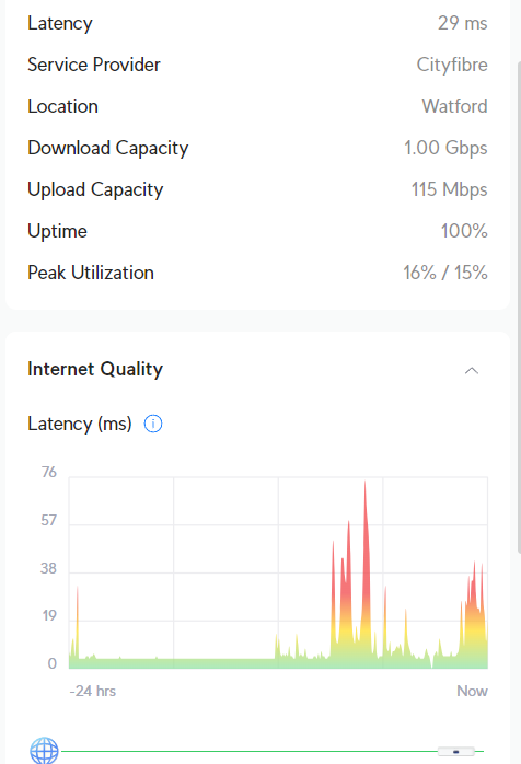

That looks like utilisation, what does your Unifi app say the clients are doing?
clients show as online/up to date, experience is excellent for wifi.
I meant per client, can it show you how much each connected device is downloading?
theres literally nothing being used, but you are right thats what it looks like, and thats what it feels like when running tests. there appears to be load and jitter.
speed tests wont go over 500
i will play around tomorrow, disable wifi and see if there any difference.
so i disabled wifi at about 10:30/11pm, the latency issues also stopped. i was on warzone for a few hours until about 1am no problems. before i went to bed i enabled the 2.4ghz band only to see if it was the sky box. that seemed fine. i then enabled 5ghz only at about 4am. i can see that the problem them starts again at about 8:30. thats the other PC so i will have to take a look at what is running, no changes have been made to this pc since iv had aquiss so no idea why its suddenly started causing this to happen.

Are you saying if you disable your Wi-Fi the problem goes away?
From what he said earlier, I took that it did. However, he disabled WiFi around 10pm and resumed it before morning, so it doesn't rule out any fault or utilisation issue. Dropping Aquiss a note early on for input won't do any harm. The spike in average latency rather than just peak latency does suggest a possible issue outside of the OP's network imho. It won't hurt to ask, and even if it's a local issue everything I've heard and experienced suggests they'll be only too happy to help, still.
yes it appeared to fix the latency issue straight away when i disabled the unifi express, im using it only as a wireless AP. before the weekend i had been using it as router and wifi with no issues at all.
always been solid/stable latency on graphs, no spikes at all.
just opened a ticket, no harm in asking, even if it is my end maybe they can help.
seems to be fixed! Martin got back to me, he said he has not had any other reports but found that Openreach GEA tests are failing and Intermittent BIP errors are visible on the line.
so raised case to investigate further, a few mins later i get a disconnect/restart noti on unifi app and it appears to be back to normal.
i will keep an eye on it but im sure its been sorted.
i had checked everything at my end so thanks to the input in here to reach out to support. 10/10 agian from Martin and Aquiss
