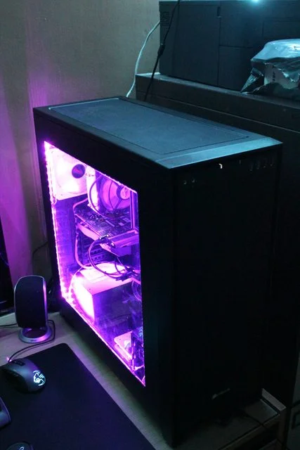

Awesome RGB LED Case Mod Tutorial - Cheap!!

To bring the thread from the dead, I did this mod to with a 300LED strip :D
Looks so great :D
