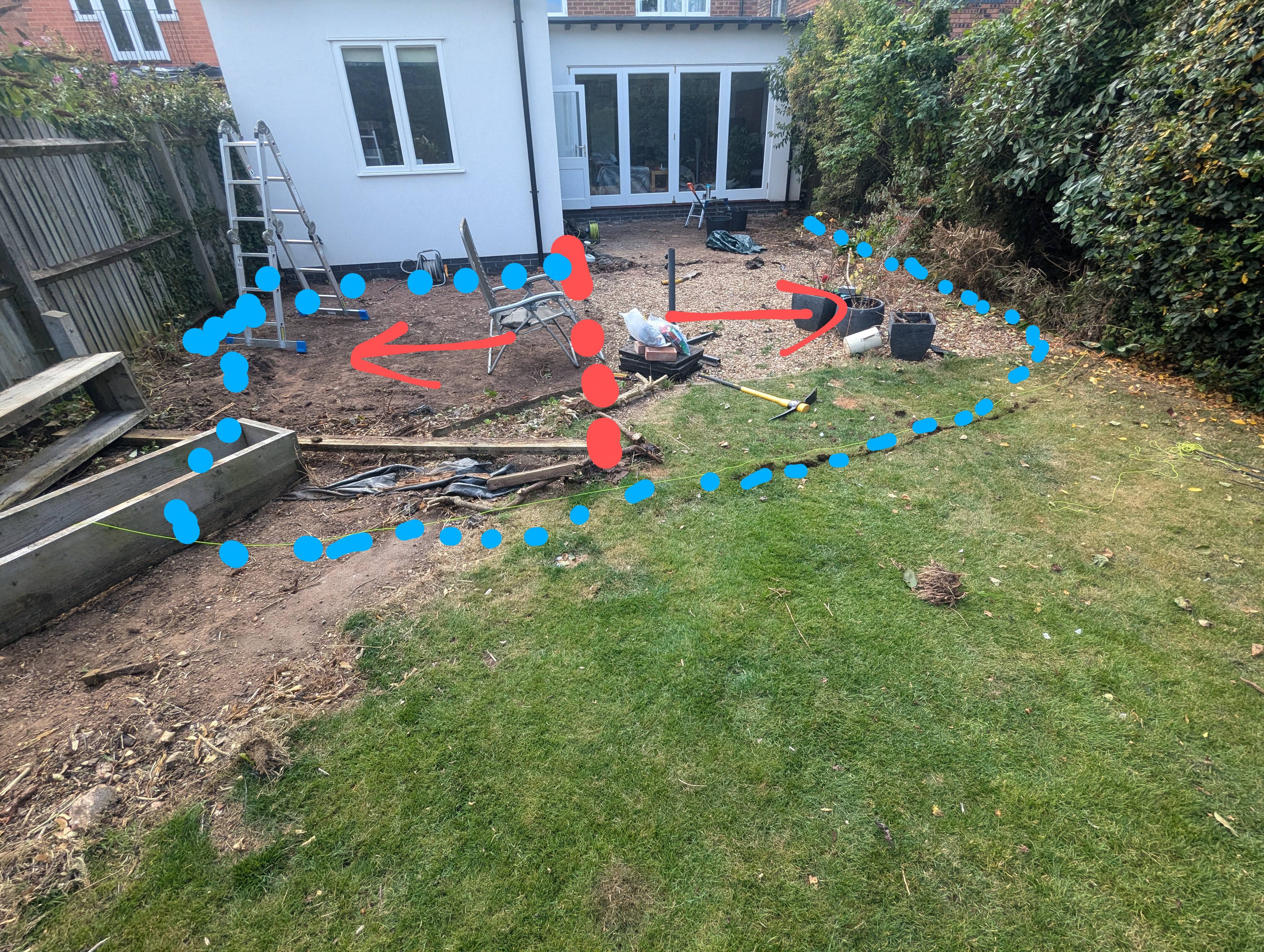

I was thinking of doing what I've indicated below.
Anyone see any issues with making the fall on this indian sandstone patio (60m2) to left and right? It will be going to a perforated pipe (covered by decorative stone).
I was not going to connect to the gutters and existing presumed soakaway as I don't know if it can take this much extra water, is that a bad idea? There is plenty shrubs /plants etc around the border of the patio and will continue to be. I could connect to/build a new soakaway in future if needs be.
Red is line of fall, blue is proposed patio boundary
Yes, it goes down the side of the house in an undergroud pipe and basically soaks away into a bank in the fromnt garden.
If you split the fall along the red line, it would mean having a straight join in your slabs, or else, if you place a 900x600 over the red line (right to left) it will rock as the high point (red line) will be under the centre of the slab.

I figure in a "random" pattern I can have a mix of falls along the red line as long as its going one way or the other. I won't actually have a visible line along that length.
Thanks for price info I have seen others and tbh im happy to pay a little more in the hope it's good quality (it costs more as its tumbled and riven)
What I was trying to say is that along the red line, you will have a fall going to the left and right, this creates a little hump, then when you put a large slab over it, it can rock.
It can be done, just want you to be aware of it.

Surely if you fill up the bottom with mortar there is nowhere for it to "rock" just that it can only fall one way or the other is the issue and potential issue of lippage
Yep should be on a solid bed so there is nothing to rock. Lippage should be very minimal as the gradient of the slope is small.
Aye cheers thought I was going mad :D. Lippage I suppose will be slightly covered by the riven surface of the sandstone so can get away with more than say porcelain.
