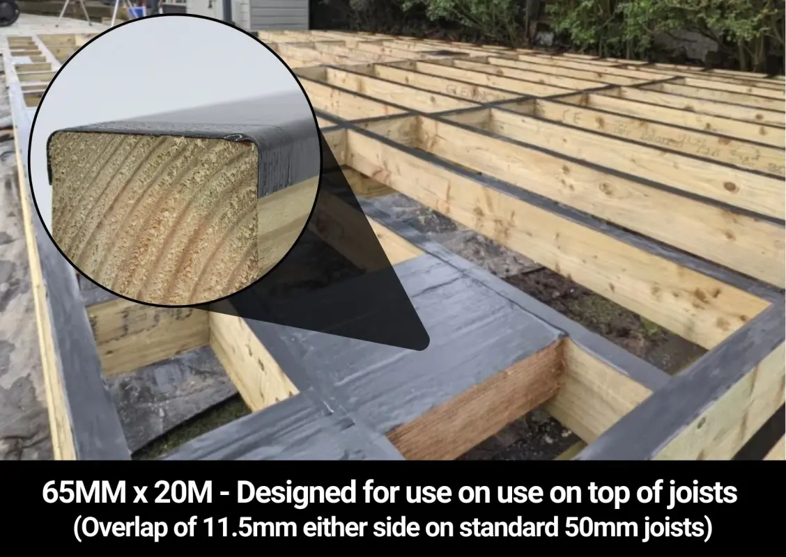

if you use joist tape on top of all the deck joists it will prolong the life. Just a few bucks extra and prep
Aye mine was dumb and they had it against soil or a building on all sides. It needs air flow/air gap.
I believe you can also put a DPC over the top instead of tape.
so a waterproof tape that sheds water for roofing on sheds etc etc is snake oil......hmmmmmmm
A waterproof tape that stops water from moving away from wood laid perfectly horizontal to the surface is a bad idea. Correct :D
We've had decking way longer than we've had the TikTok tape.
then your deck aint built right, should have a slight drop back to front to help shed water.......then it wouldnt hold on the waterproof tape. next you will be telling me sheds/garden rooms etc etc dont need house wrap.
