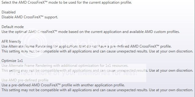

Ran DirectX with 2nd monitor off and Crossfire set to CFR Friendly
but now and then it drops to 30fps for some reason but most of the time it is between 58-115Fps

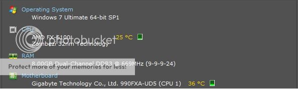

Depends on your temperatures. DL this and run the stress test for about 30 minutes.
Your looking for no more than 65c on Package and CPU

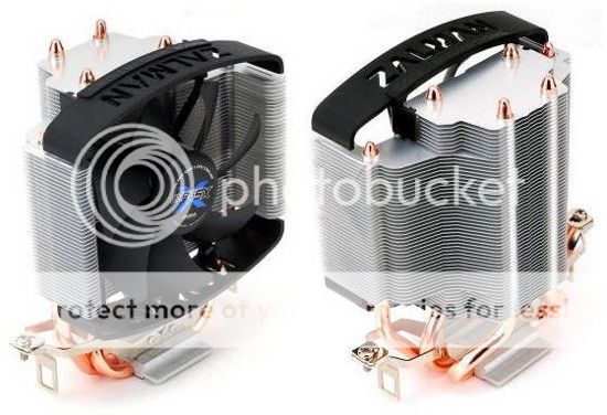

2. Be very careful about which cooler you decide to use. Remember; the rule here is that what usually works on Intel doesn't work the same way on AMD. There are certain coolers out there that are supposedly brilliant, yet, when put on an AM3 they just crumble. This is because the AM3 die is larger than the Intel and the cores are put into the far corners. That Zalman wouldn't be much use.
