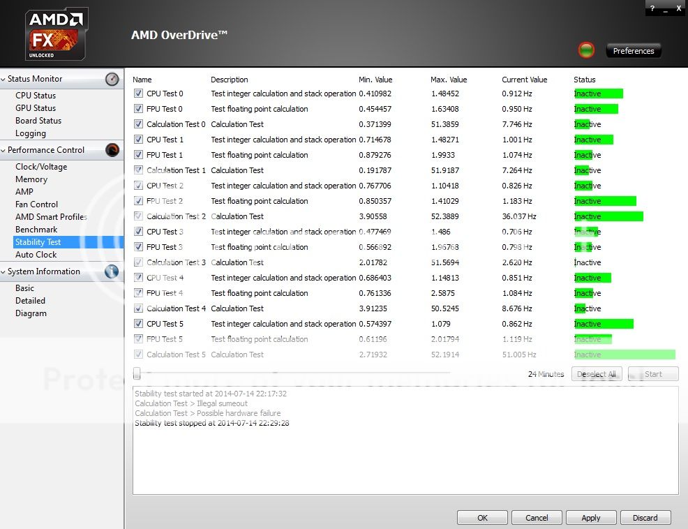

thanks for all that , running at 4.52ghz just going to do the AMD overdrive now , your amazing
Guys just after starting the test stopped
Calculation Test > Illegal sumeout
Calculation Test > Possible hardware failure
I think I fixed it , to much voltage , i can't get it stable with that info above
