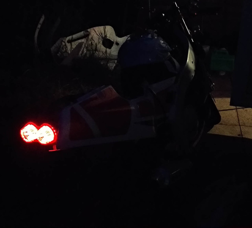

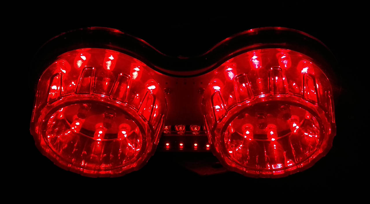

Thanks to my stupid finger, I was unable to stop myself from falling when I lost balance doing something the other day. I came crashing to ground and in the process obliterated my tail light.
I figured that since I don't actually have a tail panel, and I love twin lights, to go with something different to replace it:
Phwoarrrr etc:
