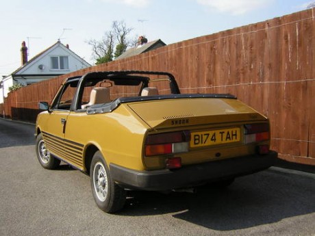

I've been reliably informed by a top bloke who was a young whipper snapper back in the day that Mobile Skip was a joke for Skoda convertibles :p

Skoda verts back then were skips on wheels^ :o
