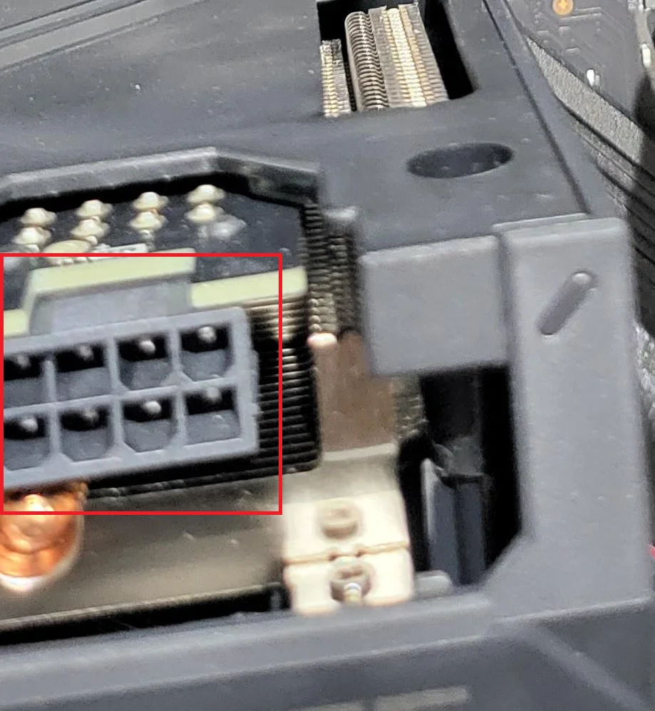

graphics card needs power, connect this to power supply:

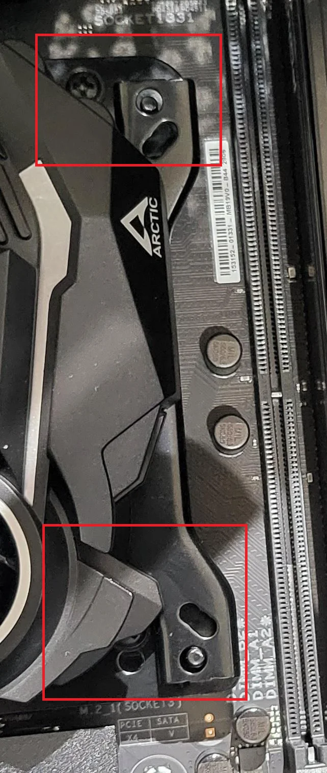

No mate ive not finished the cooler yet , got thermal paste to go . Ok i got a ton of cables with his power supply would it be there possiblyquestion for the room, is this secured properly?
On this picture you can see 2 x connecters in the top left, make sure these are connected (1 x 4 pin and 1 x 8 pin)
yep, cable(s) probably labelled as gpuOk i got a ton of cables with his power supply would it be there possibly
pcie cables for the gpuNothing labelled gpu , got cpu x 3 pcle x2 and a few others , ill post a pic Power supplies https://imgur.com/gallery/869dQ6H

Yeah i didnt realise....ironically it turned out a few bits was missing from the cooler mounting bits . He ordered another cooler , frostflow 280 which ive just fitted, Just connected everything now , and hes just purchasing windows 11 as we speak and downloading the relevant installation boot up files . What ill do is get a few more completed pics and upload them . Im 90% sure everything is connected as it should be.@g6yob - You're not allowed to make multiple accounts on this forum, but you should now be able to post again (or in a couple of hours)
For the CPU connectors, can you check if any of the CPU looms you have are split (i.e. can be separated in to 4+4)?
If so you'll just need to lightly bend the other half out the way.
How are you getting on with the cooler? - Make sure to remove any protective film from the thermal paste (if it's pre-applied) before fitting it, otherwise the CPU will likely get too hot very quickly (but don't worry too much if you missed this and have tried to power on, it should shut itself down before anything gets damaged)!
With regards to his liquid cooler , ive looked online and it recommends mounting at the top and the direction the fans are at currently they would pull hot air out , is that correct
